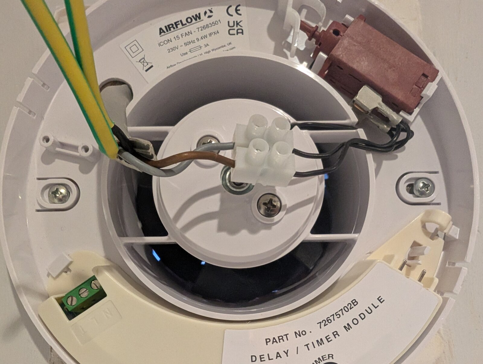

I recently purchased an AirFlow iCON 15 extractor fan after the previous one in my bathroom died. I purchased it from from SuperLec but it doesn't seem to be working.

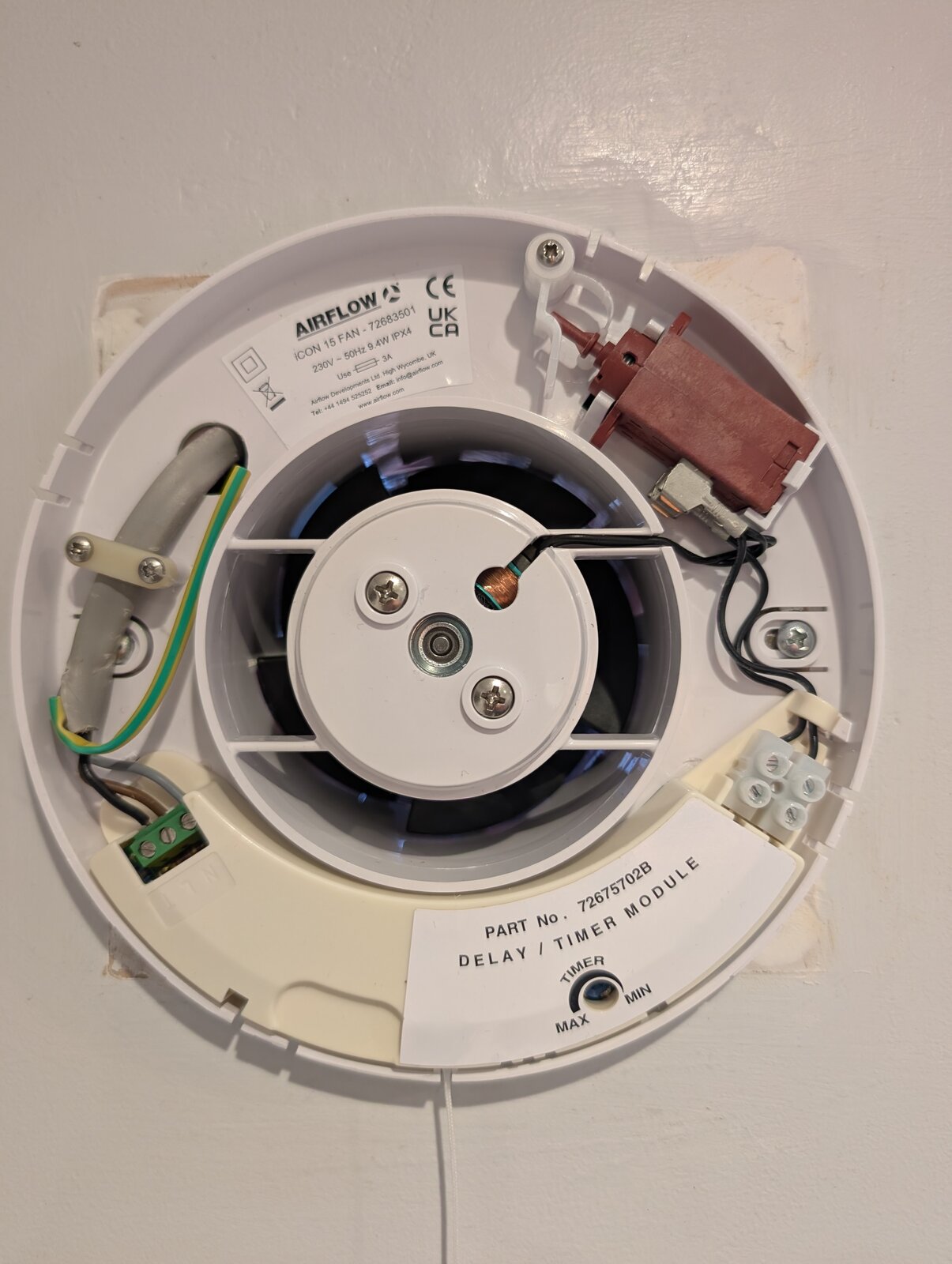

I've wired it in and the actuator that opens/closes the cover works, but the fan itself doesn't do anything. I also purchased the Start Delay Timer Module (72675702B) to go with it, so I tried bypassing that and wiring the fan up directly, just in case it was the module that had the issue. However, even wired directly, the actuator again works OK, but the fan itself is still completely dead.

Are you sure, that you are not wiring the motor, in series with the actuator?
This is wired up with the control module in place:
And this is wired directly, bypassing the control module:

Any obvious gotchas...?
