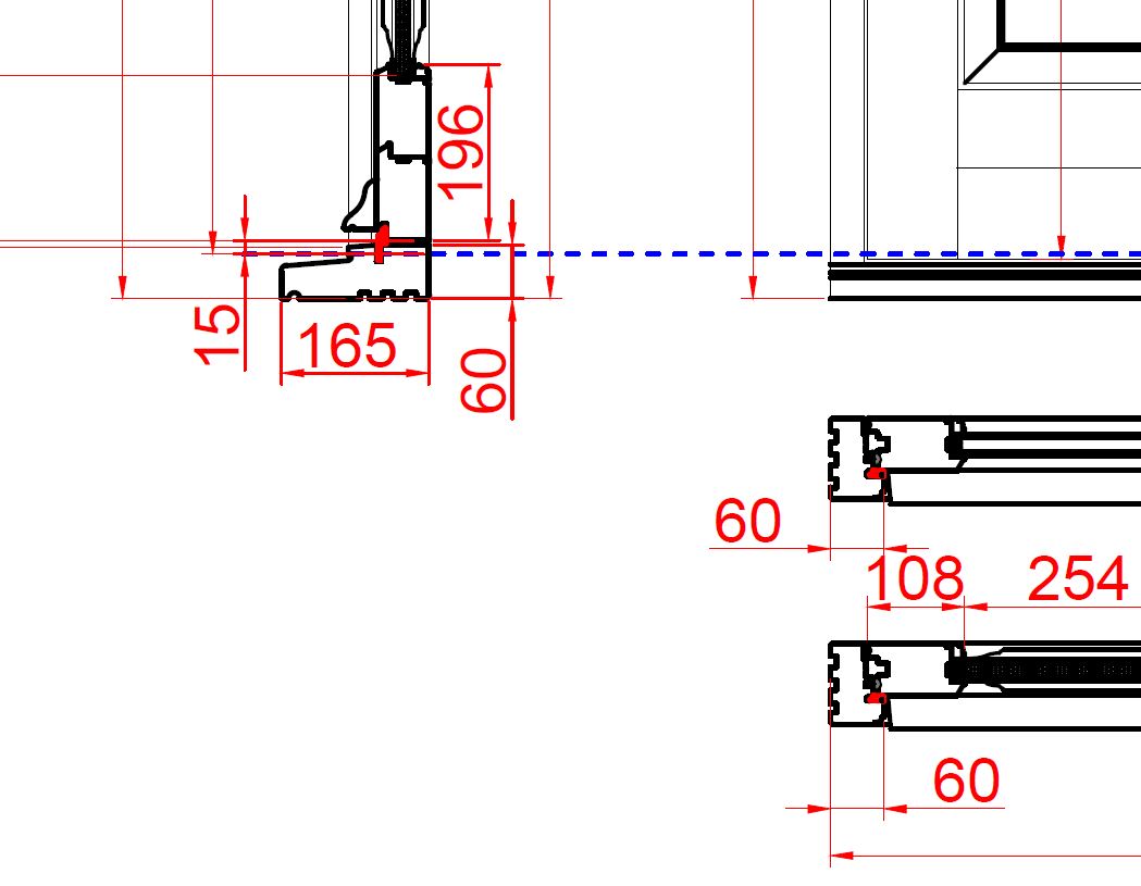

Is water getting under door? If the rain drives against the door water might be running down where the door meets the frame jambs and getting inside the water bar in the cill. Should the frame/rebates not keep water out? I have attached the sections. I am not quite sure how it is getting in at the moment. The door is a little protected so I think it is a more general issue that driving rain. i.e. any rain.

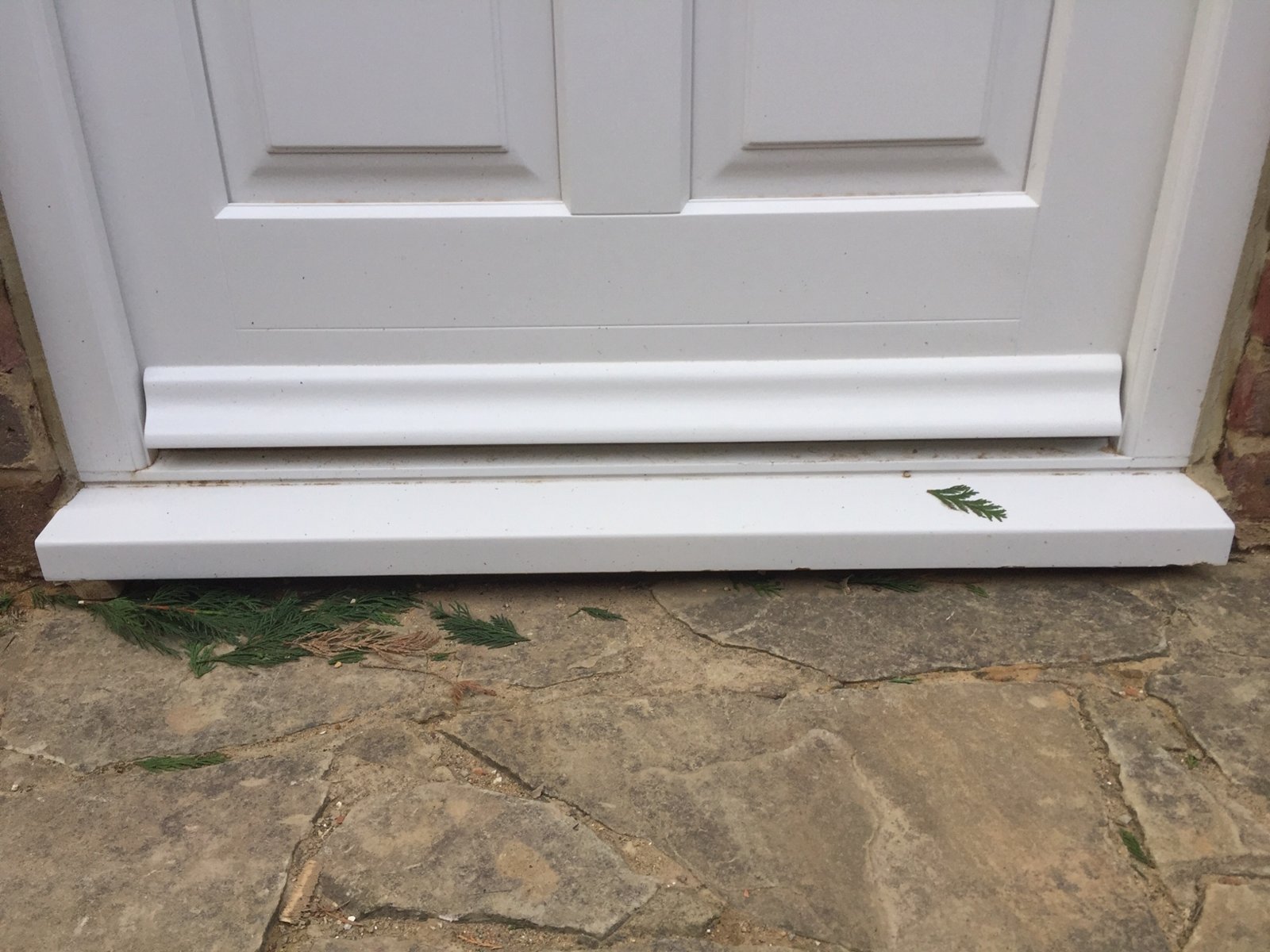

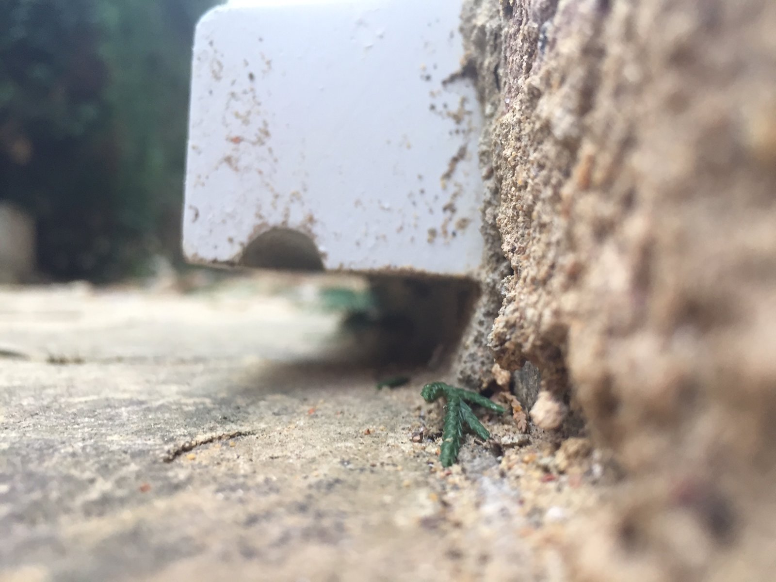

Thanks. Here are pictures from the outside. It is quite close to the paving, but not touching.

External ground is too high breaching any dpc.You ideally need two brick depth before external ground level.
The external ground has always been that height; and we have only started having a problem since the door was cut and new screed poured. Should there be a vertical dpm?

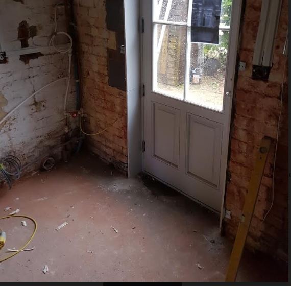

If the screed is new then whoever did the screed should have ensured the dpm wrapped up higher than the brickwork.
When the door went in the dpm should have come up the back of the door threshold.
I dont know which order etc things were done. However the screed clearly runs through to the back of the external skin of brickwork and my guess is that is where the problem is. On the outside rainwater is running across the paving and getting to the brickwork.
If the ends of the cavity are open at the door reveals then these should have been filled with a cavity closer.
a vertical dpc is usually needed where the brickwork returns at the door reveal.
