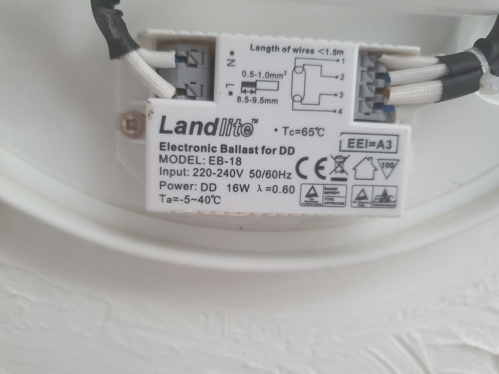

I first changed the bulb but it's still not lighting fully so want to change the ballast.
Currently fitted is a Landlite, Electronic Ballast for DD.
Model: EB-18
Power: DD 16W
It's got the Live and Neg going in one end and four wires coming out the other.
Can anyone recommend a replacement as I cannot source the same Landlite model?
Many thanks.
You can also get the LED retrofits https://kosnic.com/products/kled09std-518380/ if you don't want to change the whole fitting
You bypass the ballast and put 240v onto the 4 pin connector and label the fitting up for LED tubes only, easier than changing the fitting, only takes a min if you have some wagos in your pocket.
