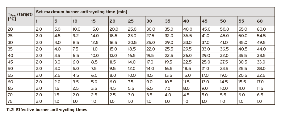

In that case wouid you think reducing the anti cycling time would help me
Don't see how it would help. The boiler flow temperature is set to 75C so, if the delay is set to 20 mins, the actual delay will be only one minute - according to the chart below from page 43 of the Installation Manual.
