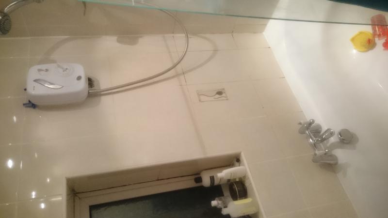

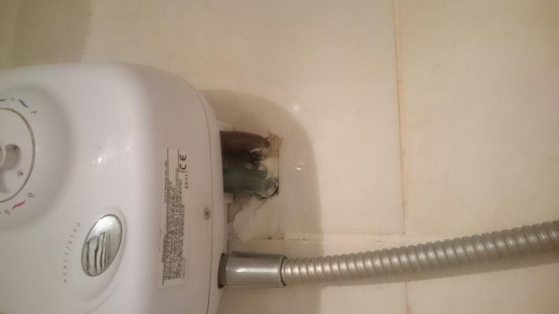

Hi there,
We are having a new boiler installed at the moment, going from cylinder system to combi. All good, but our shower (Triton AS2000XT) is not compatible with a higher pressure system. The plumbers seem to think that if they disconnect the electricity from the power shower, the water should run free-flow through it and it should be okay to use? Will this be the case? I was thinking we would have to get something like a mixer shower, or a compatible replacement from Triton (see examples below). Please advise! Many thanks.
(ps, changing taps to one with incorporated shower head is not an option)
http://www.victoriaplumb.com/Shower...le-Manual-Single-Lever-Shower-Valve_4792.html
http://www.victoriaplumb.com/Showers/Shower-Valves/Bar-Valves/Cyclone-Bar-Shower-Valve_103.html
They're not designed for mains pressure. Ask them how you operate it without electricity. Ones I've installed have water outlet controlled by a powered solenoid type valve.
As there is a solenoid valve that has to be electrically powered to open in order to allow water to flow out from the shower, how do they work that one out.
See item 13 on page 3 of the Installation Manual
2 port solenoid valve. Isolate the supply and the valve will be closed.
thanks for quick replies guys. Is there any sort of shower/solution that would be particularly easy to fit to the present pipes? They are quite close together, only about 10mm apart max.
I'd be getting a new plumber...if they're dumb enough to suggest running mains pressure through your existing shower they must be clueless.
That scenario happened to a customer of mine a while back....stoopid installer just disconnected the power to the shower pump...it lasted a few months and then flooded the bathroom :rolleyes:
As Gasguru says, I have also seen this. The shower worked for a while but eventually water p*ssed out everywhere.
The showers shown in the links have 150mm pipe centres so would not be an easy swap over. You are not going to get anything with pipes that close. Is there access on the other side of the wall, a cupboard perhapl?
