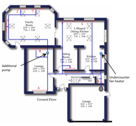

Very interesting on the plate heat exchanger. As well as keeping the boiler side clean, it was also specced because the flow around the downstairs heating circuit is poor in some parts of the house. We've currently got a pump midway round the downstairs circuit, which the previous owners fitted to help with this. It's not great though.
It was explained to me that having standalone pumps for the upstairs and downstairs zones to distribute flow from the PHE would solve these issues, and we'd be able to do away with the additional pump and get better results. I'm now doubting whether this is the best way.

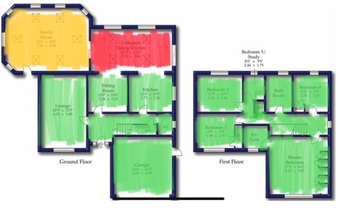

I'm not sure how clearly I am explaining this, but I do have some floorplans where I've scribbled on what I think the pipe layout is. I could try to upload those.
Ok, I have a bit more info to share. I've just run both showers simultaneously at normal temp and the water meter showed 13L/min. I think some of the bigger combis from Vaillant and Worcester should be able to handle that if I understand correctly?
