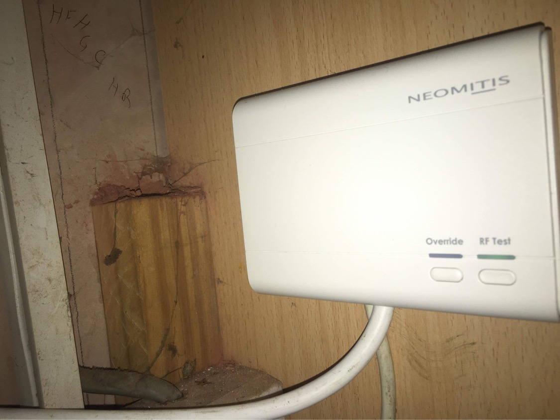

New boiler fitted but All radiators go cold after a couple of hours??
your room thermostat is calling for heat, but the boiler is not getting the signal, you will have a small box wired to the boiler , this si the receiver post a pic so we can see the staus
I can't believe an installer has just fitted that system and left you to it. Have you no user leaflet/manuals for the boiler and the thermostat?
This is the only box I can see wired to the boiler

The little white box, with the lcd stating 17 degrees. It was on the fireplace. Also if it’s set to site, it might be that you need to set it to manual, although photo you’ve posted appears to be calling for heat? Was it wired up as opentherm?
Now the radiators have just got warm??? the hole time the radiators have been ‘on’ via the boiler however they went cold after 2 hours now they are warming up again without me touching anything.

The thermostat is as CBW advised above. The reciever is the white box near the boiler. The RT7RFplus is a fairly complicated controller and you should have been given the operating instructions / user manual ,but can download it. If it's too complicated for you to follow ,contact the installer,who should have gone over at least the basics with you. It seems that it may just be " learning" ,and adjusting to your comfort zones.
