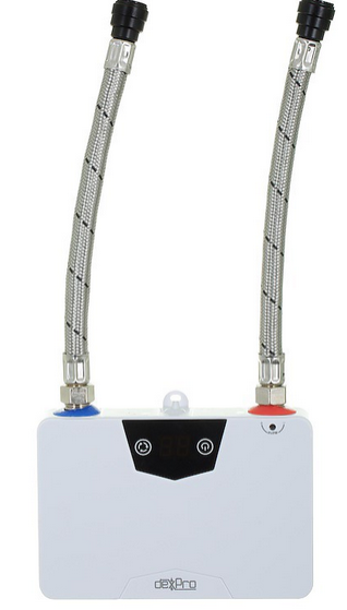

I have considered a small heater at the front kitchen, the back kitchen seldom used, but each one I have looked at is a large lump taking up room in some kitchen cupboard. And I am short on storage. So only real need for warm water is to wash hands, boiling water is from kettles, I looked at things like this 1710247659306.pngbut 3.5 kW so needs dedicated supply, this 1710247862761.png hold 15 litres and is only 2 KW so would work, but then using electric at peak rate, and fills a cupboard. So although running off cold water to get the hot at the moment at least I am using oil or solar which must be cheaper to using electric at peak rate.
As to if supplied with a timer so heated over night only it would stay hot through the day not sure, 8.95p per kWh midnight to 8 am, and 31.31p per kWh during the day so not sure how this compares with loss of heat when using oil or gas, so is it worth it?
