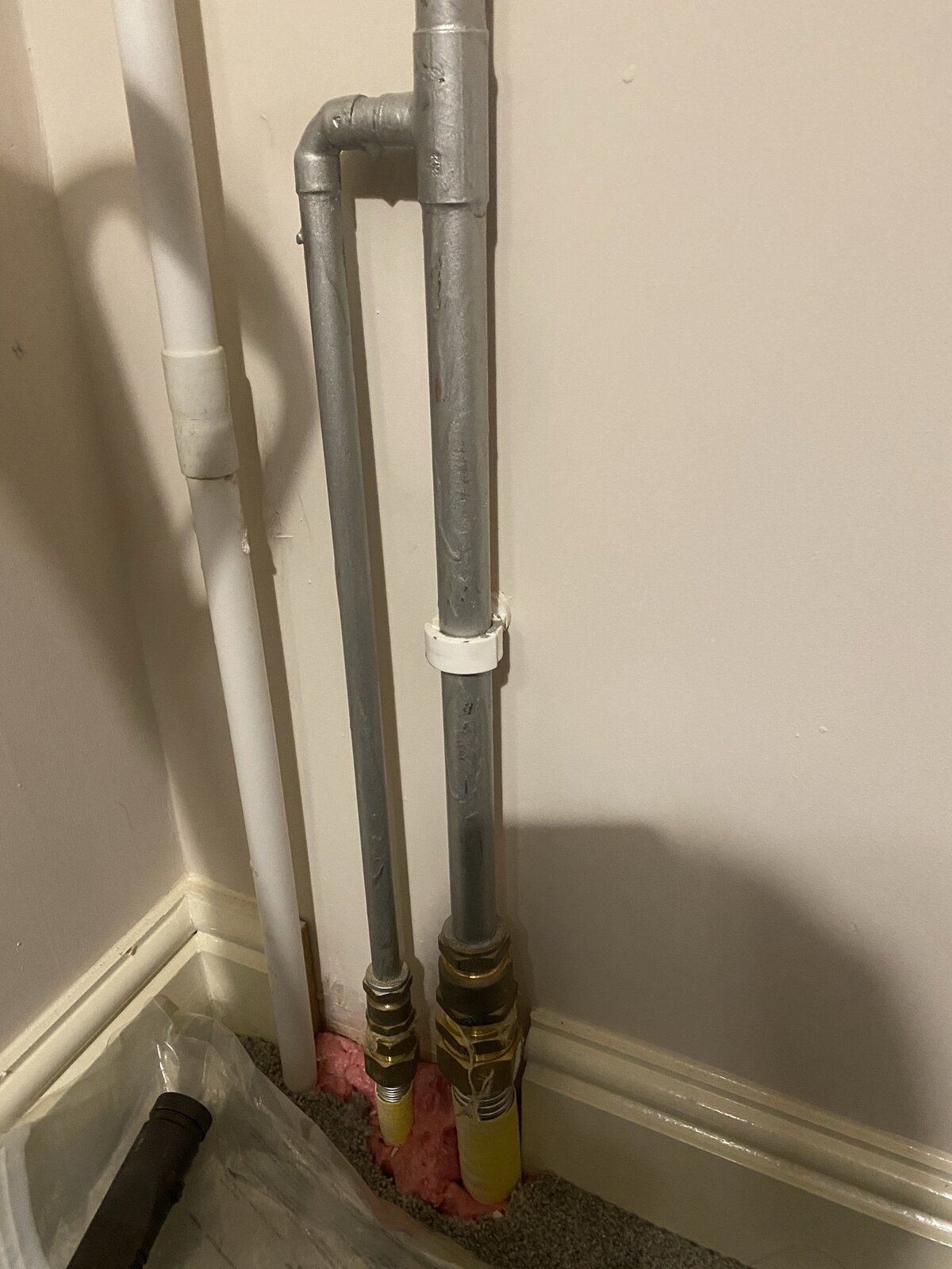

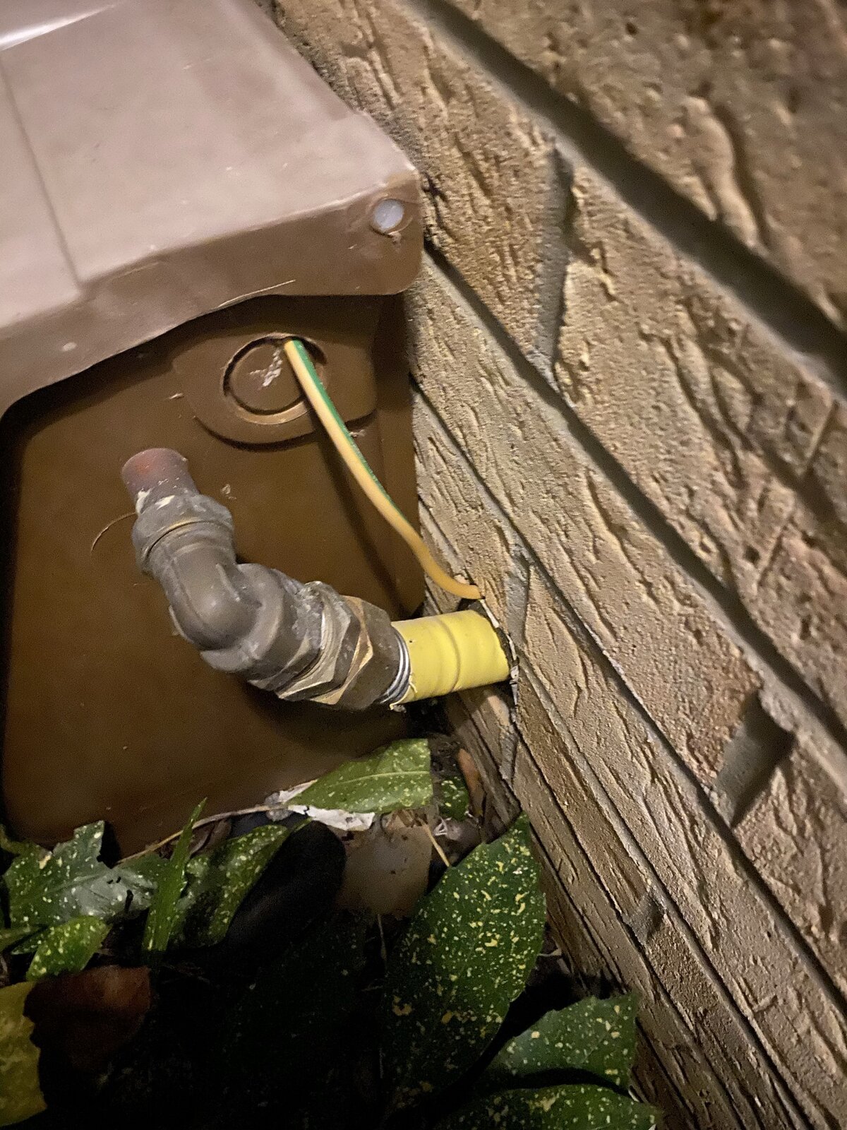

Gas meter fitting at ground level at the front of the property. Gas enters via CSST pipe which goes up the stud wall and into the ceiling void. It pops out in the boiler cupboard and is split between boiler and another, smaller-diameter, CSST pipe going to the gas hob.

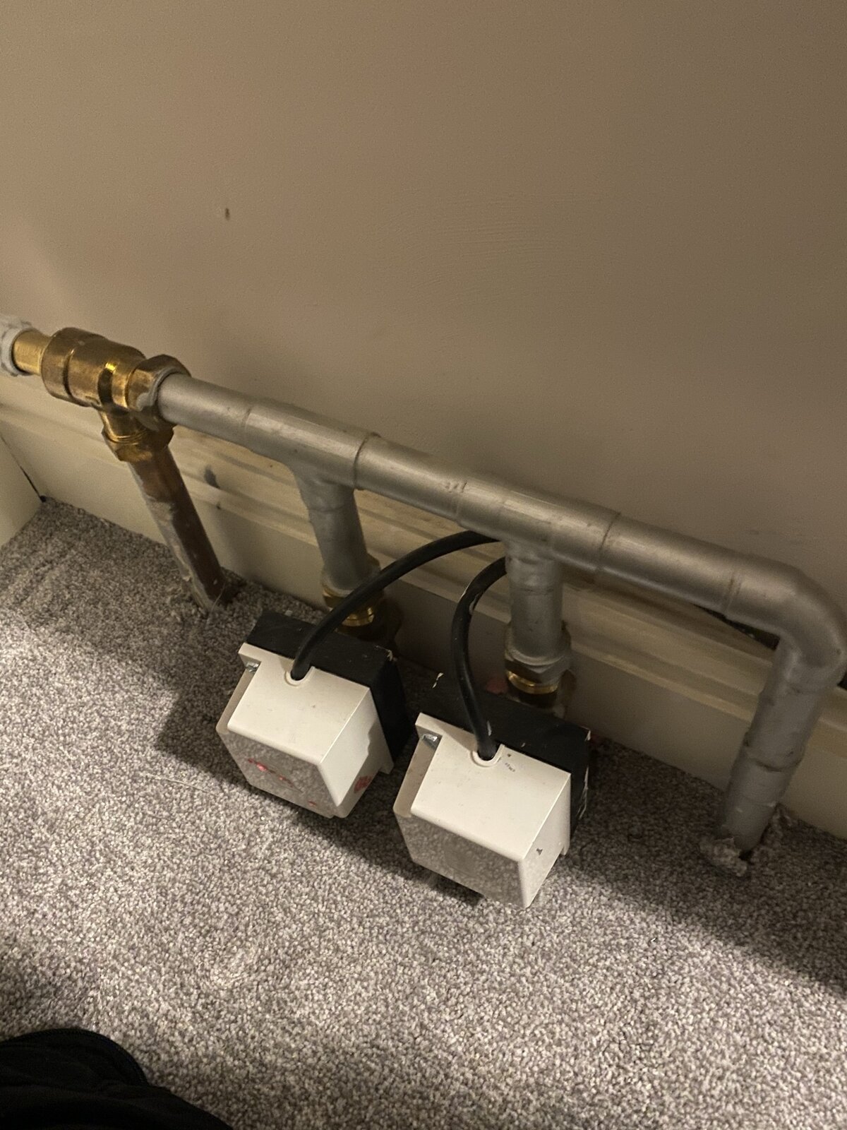

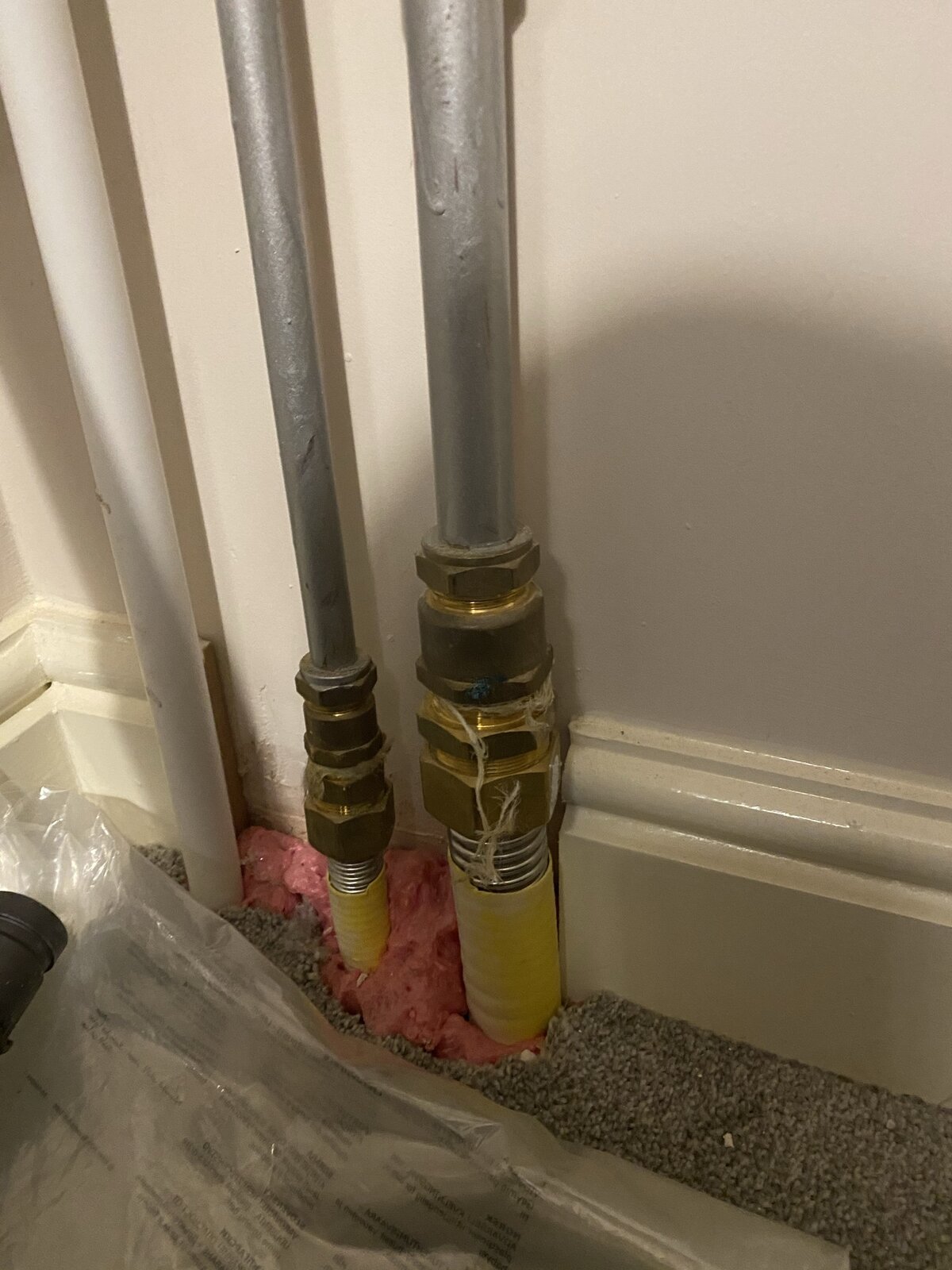

However the plumber picked up a couple of faults with our install. He advised I go back to the builder as he states he would fail them on inspections he would do. Specifically:
- The CSST has exposed corrugated ribs by the fittings. I can see from installation instructions the yellow jacket should be closer to the fitting and then yellow self-amalgamating tape used. Is this actually a requirement/reg though? In my case, will it be sufficient for the gas engineer to use the tape or do the joints need remaking off?
- There should be a bleed valve (I assume automatic) at the pipework by the two motorised valves. I can see why, however is this strictly a necessity for regs (or even just obvious good practice). Have I got a leg to stand on in demanding such be installed?

- Some of the joints are outside the meter box. Are they meant to be inside or is having them where they are acceptable?
- Is the CSST meant to be sleeved as it passes through the studwork & ceiling void?
