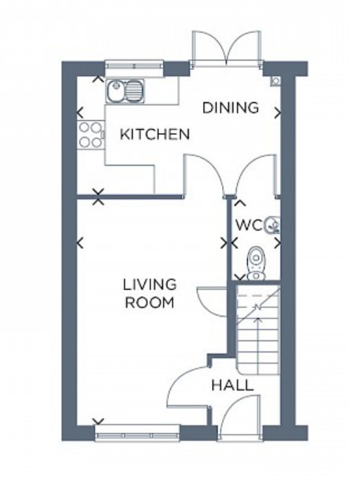

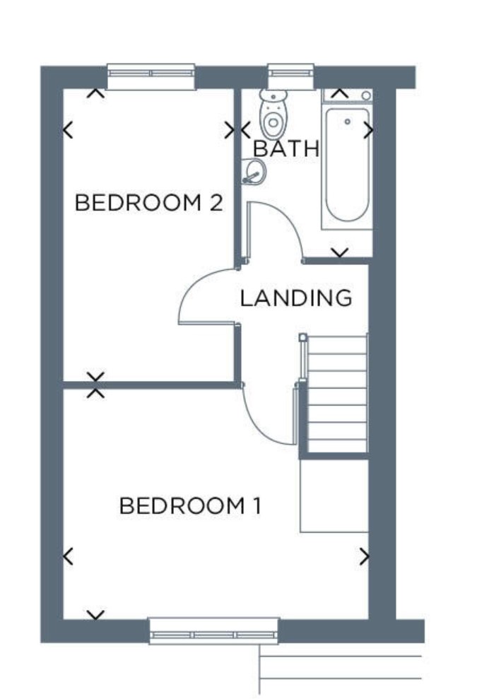

Hi this is a basic floor plan of upstairs. So no exact scale. But the Tank will be about the size of the bath, in Bedroom 2, up against the back wall.
The platform will probs come forward to almost the door but also with the section 2' x 2' not there.
Does anyone think the the weight will distribute through the most of the platform as it won't be in the middle of it, since it's up against the back exterior wall?
Hope this helps.
Edit. Put this up to ask. Does anyone think the the bathroom joists go straight throuh the bedroom 2 since there's no load bearing wall downstairs.

You show a floorplan of a Gleeson - 'Cork'
There may not be a load bearing wall downstairs, but there does appear to be a partition - and that would definitely help reduce deflection...
If the site is completed, just find another Gleeson development, there are plenty about - or talk to them directly.
But, as has been said before, for ultimate peace of mind, contact a structural engineer.

Thanks, I've rang them and the sales person said they will have a word with the foreman.
I didn't use the bottom floor as these are brand new. (You already knew).
And the downstairs is the otherway the kitchen is at the front, so the partition is just behind the doorway of bedroom 2 after the platform I'm making ends.
I am trying to contact both housing companies as well as structural engineers, anyone offical but it's slow getting a response. So i was on here while waiting for responses.
Thanks.

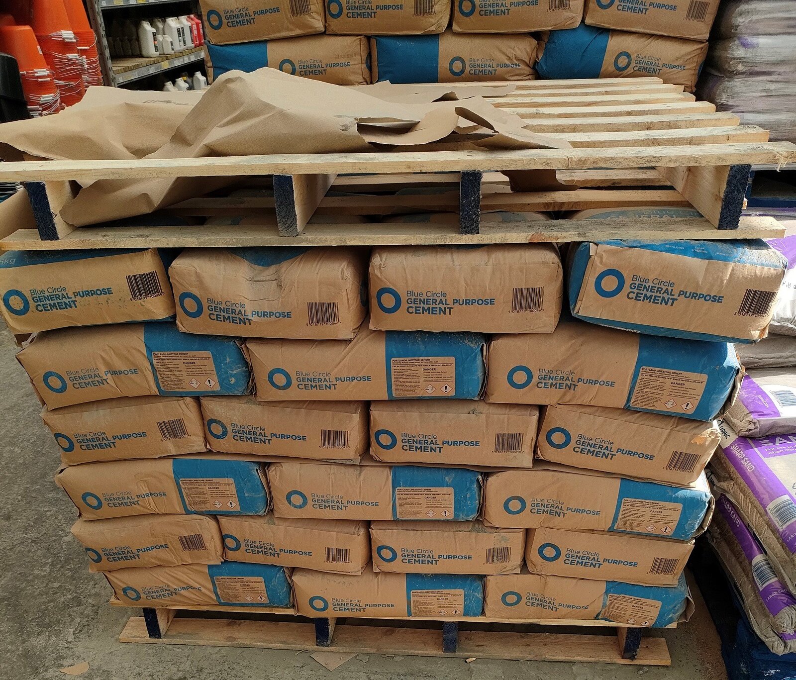

I was at BnQ looking at boards and found this and wondered does this, in any way equate to the floor strength. Added Pic.
Expertes on here will probs be laughing now.
Basically this palete was about 1m10cm by 1m40cm. the 57ish bags were 25KG each so it was about 1425KG and the thin planks aren't even bending at the longer outer gaps.
It made me remember that I've read about 3 different posts from 3 different people who said they've had 1 metric ton of plaster board on a palete on the 2nd floor bedroom.
It's basically dust so would natrually spread, but it's 1.4 Ton over 1.5m2.
When I saw it, it was like The Matrix, cos it made me believe. 450KG should be no probs.
Does anyone think I could get planks like those on the top, not the ones through the middle, instead of the 18mm layer of OSB and then layer the 11mm OSB on top.

They're just standard pallets, availble for free from many places for free. Not sure they look very smart though, they may help a little bit, it depends how the bottom of your tank base already disperses the load onto your floor but if you did do something like that you may aswell make one up with some timber of the right size and make it look pretty.
LOL. I didn't quite mean, just shove it on some paletes. I meant like are paletes special, can they take more weight than a floor.
Cos that palete was also stacked with another palete full on top, you can see from the one behind. So a crazy amount of weight.
And if I just got some planks about 1 cm thick, space those under the feet of the tank stand and then on the sheet of 11mm OSB.
To spread the weight out like a very thin palete on the floor.
