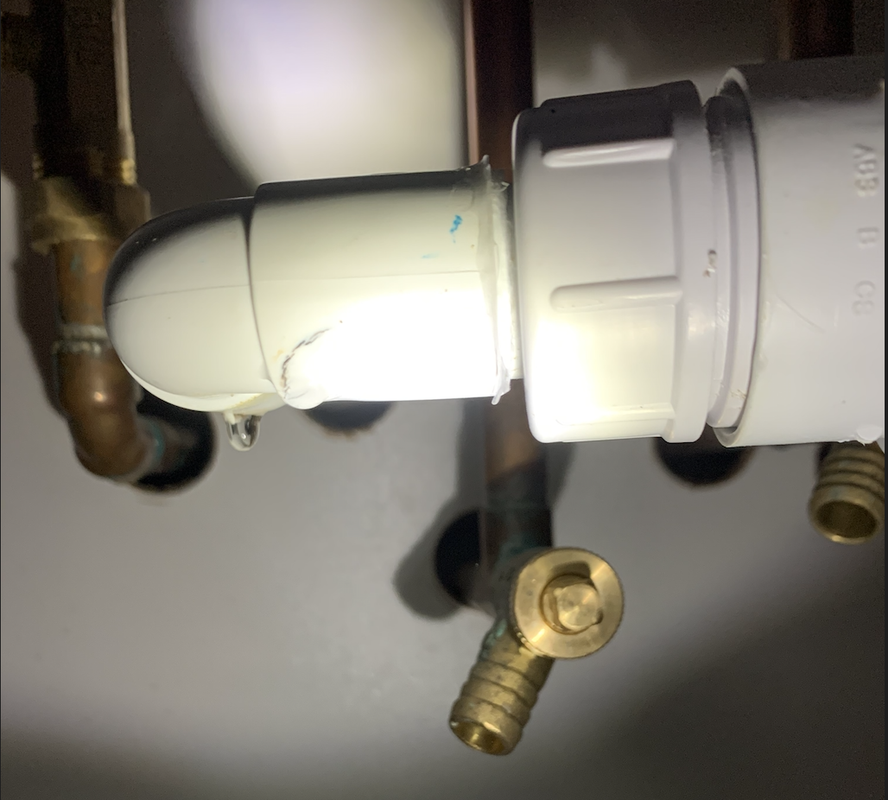

Hi there,
Having owned my Clarion Housing new build for a matter of months, I am in disbelief that I am having my third water leak under my kitchen sink.

3rd - boiler condensate pipe leaking (this is the problem this post is about).

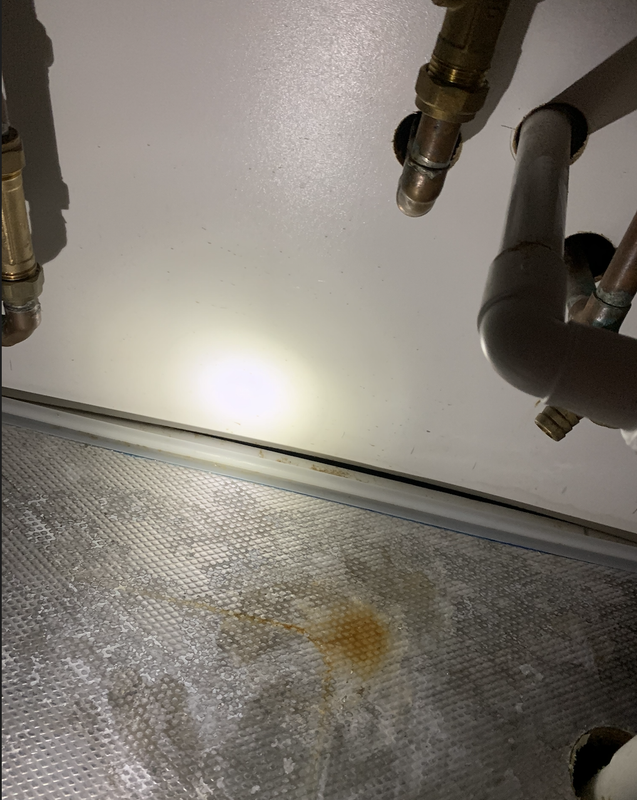

I have reported this issue to Clarion three times now. Firstly as a snagging issue, but on the last two occasions as a more urgent job as I have discovered that this leak has actually caused damage to the kitchen units. The protective metal cupboard liner has actually started to rust as this has been going on for so long. I have a soup bowl under the drain, it has been here for a month since I last contacted Clarion, but again, nothing has been done.
Can anyone tell me what needs doing to sort this issue out? I have tried tightening any parts of the pipe I can, it can't go any tighter.

Yup, water won't run well up hills though. That connection is running up into the fitting. I'd be unscrewing that and see if there's a rubber seal in there and if it's fitted properly, is that the solvent glue that I can see that's ridged up or have they tried to use silicone to seal it up? Try drying that drip up with kitchen roll and watch the join and see exactly where it's coming from, as @Nige F mentions it's may be the fitting isn't glued properly or is that a cut/crack in the elbow?
I'd also cut that hole in the cabinet a bit higher and move the condensate pipe up an inch or 2 so it's all running downhill properly.
