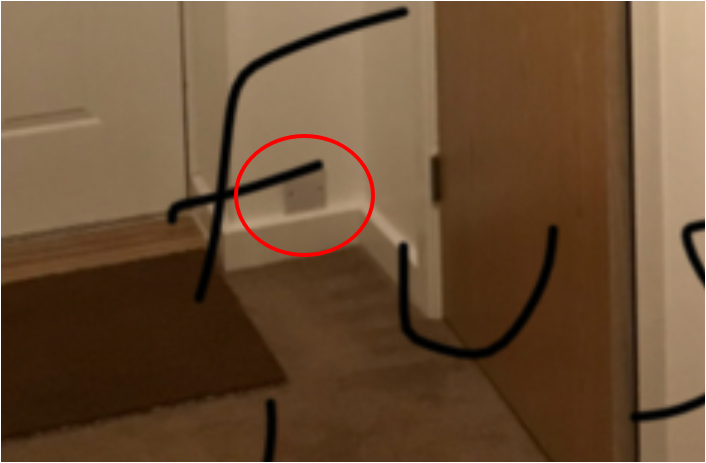

Hi there,
I have just moved into a new build, but there appears to be no door bell and no wiring at all for it. The fuse box is totally full.
Any ideas on how I can get one wired in? Was thinking of going for a Ring doorbell in the future, so would ideally need a 12 volt feed.
The fuse box is located in the right hand cupboard. To the right of the front door is a light switch for the hall light and the outside one. Not sure if these could be useful?
Ditto the above, you can get 2 packs where one sounder plugs into a socket and the other has batteries and can be taken anywhere within a range.
Works well in my 1855 terrace house with damn thick walls too.
A light switch quite possibly won't have a neutral available
One of the switches by the front door switches the outside light, there's a 99.99% chance it does have a neutral there to use.
Henry, if you're happy to have a 12v transformer screwed to the wall next to the light switch, and drill through to outside, then you're sorted for a Ring doorbell.
Not a rose, but many many times there are two cables, permanent supply and cable from the switch. I'd go for 70% the loop is in the switch. I'm holding my breath for the feedback, how exciting can life be???:D

But what is underneath? Maybe it’s a junction for some outside circuit, maybe there is something, such as a voltage conversion device.
What's the room NEXT to the front door?
Maybe you can hide some wiring etc in there.
Thanks everyone for your help on this. I assumed a new house would come with a doorbell, or at least the wiring! Can't believe I have neither!
Absolute last resort, IMO.

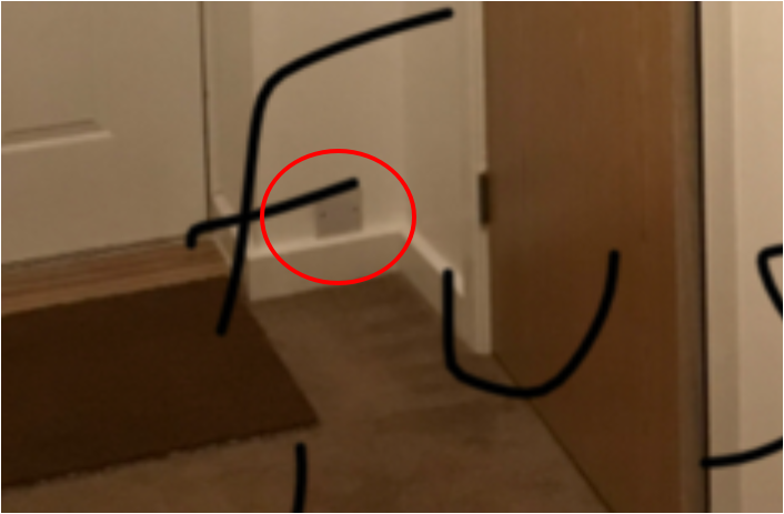

What's this?
That is an access hole BT I presume made to fish through their copper wire. It literally has the outside phoneline coming through. Would rather not tamper with it has had to wait so long for the line.
MVHR is a Mechanical Ventilation with Heat Recovery unit. They often do have their own circuit, and as they are located in the loft, it would appear that someone has probably used it for either a TV in a bedroom below, or maybe a loft mounted TV signal amplifier.
This is a brand new house, so I was not responsible for wiring. Up in loft, there is a MVHR which connects to double power socket. There is also a TV amplifier box which goes to a loft areal. Hope that clarifies things.
The room next door to the right is the bathroom. The one to the left is the kitchen which is really small.
A couple of people asked what the inside of the light switch looked like. Have just unscrewed and this is what it looks like....
