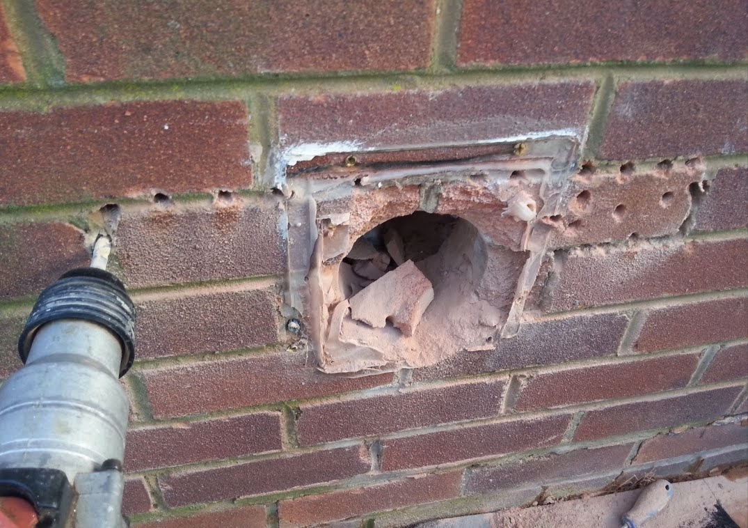

Re hole.
Get match bricks
Use duck tape to cover new brick face and existing wall brick faces.
Fit bricks. When set or dry remove duck tape from brick faces.
Can just brick any old how inside and make good with filler.
Easy job.
Or bodge up as you say

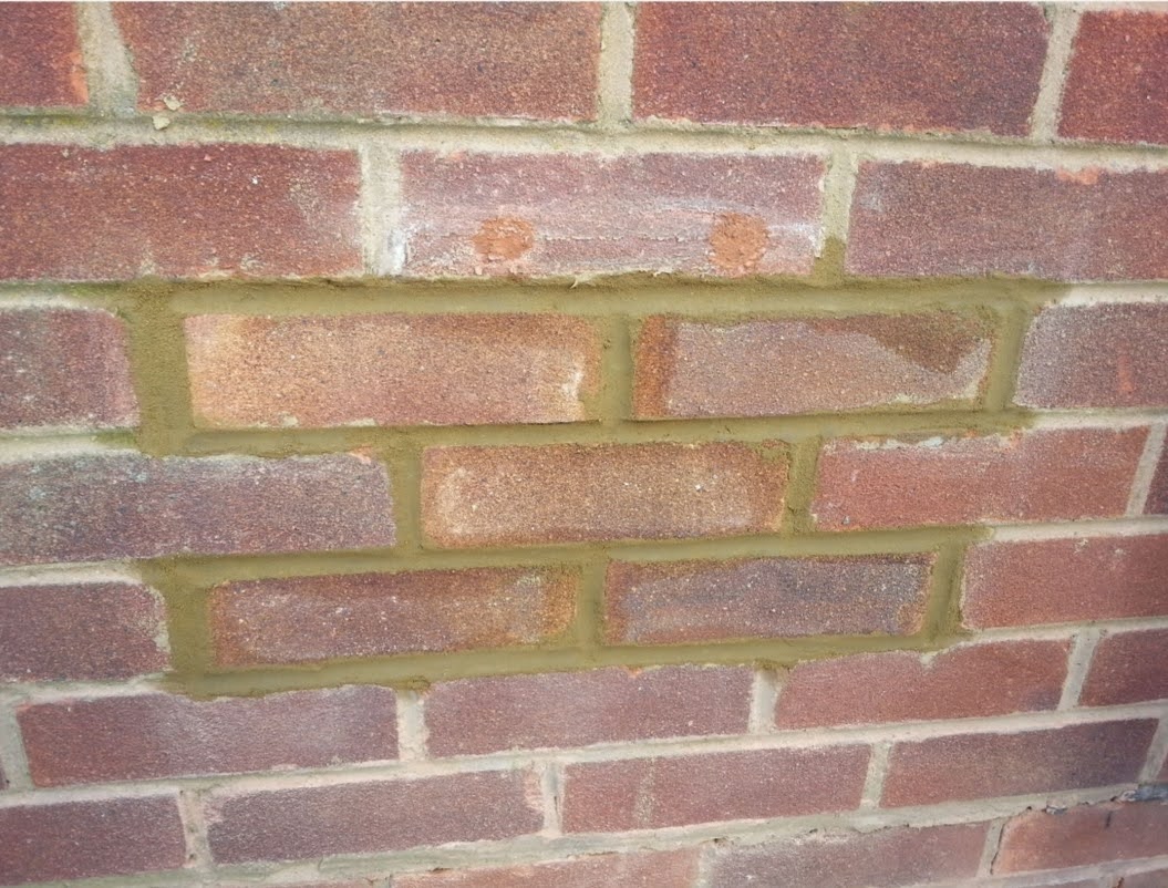

With duck tape protecting bricks you can throw the sand and cement at it. I did... Ha
If ever the mood takes you.
This took about two hours. I used a few stones to pack brick joints but don't tell anyone.
