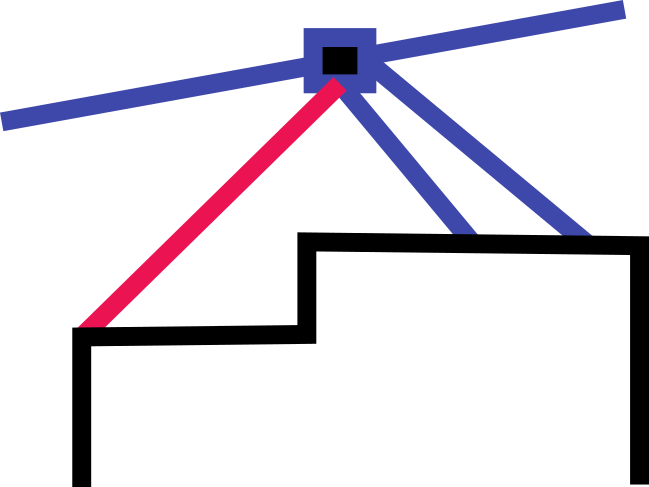

Very rough sketch. House wall in black. Existing deep sewer runs right to left. Existing pipes from house in blue; proposed new pipe in red. Ground is slightly lower to the left.
Connecting to an existing pipe would require a sharp left turn (probably tighter than the diagram suggests). I don't know where the existing pipes drop, i.e. whether there is a backdrop at the manhole or whether they run at low level from the house. Joining to them low down would involve a deep excavation; joining at shallow level might require running up hill.
They always look deeper when you're looking down. That's probably around 12 courses, or 3ft.
What's the length of the run?
So you need about a 5 or 6inch fall. Can you get the depth at the other end easily?
Getting the fall along the red line would not be a problem. The challenge is that that would require a lot of digging, and getting permission.
Getting the fall to connect to one of the existing drains would depend on how deep they are, which is unknown.
Anything we say about connecting to the existing Chamber is probably going to be academic, you will be Governed by the Water Company's requirements as it's their chamber, and also Building Control who will need to approve the work.
