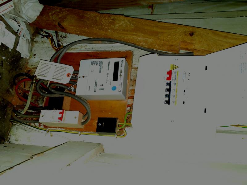

Can you post a pic of your existing consumer unit and incoming service head? It would give people a better idea of what actually is required and will show the rough age of your exisitng CU. :)
Sure, picture of CU attached (link below). If you can give advice ASAP as I have to ring electrician tomorrow, so more info the better.
Many many thanks in advance!
Cheers :D
