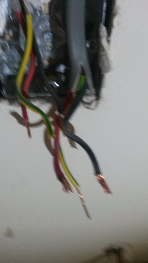

Morning, finally getting round to the job in hand. Ive taken off the cover for the cooker connecting plate and found 2 cables with 2 lots of L, E, N. Wasnt expecting that. Power definitely dead to cooker when turned of cooker circuit at consumer unit (and cooker switch) Would you just go ahead and try to connect into socket (will need an MK one as Kai suggested) or put one set of cables into an insulating block?
The socket to the left in the picture is for the hob, so not touching that.
Apologies for the poor quality pic - rubbish phone and poor light.

So you mean 2 cables as well as the cable to the cooker? What else stops working when you switch off the cooker isolator, eg. extractor fan?
Yes those cables exclude cooker cable (both sets originate from the wall). The extractor still works as on separate circuit (has a separate fused spur above oven, which kills the extractor when I turn it off). Slightly better pic attached (cooker wire cables out of site but are the new blue, brown colours)

It's not supplying the socket on the left though no? Those cables don't look like 6mm so you should be able to get them both in the socket anyway
No socket on left is also wired separately although in to the same circuit as power to hob killed when turn off cooker circuit.

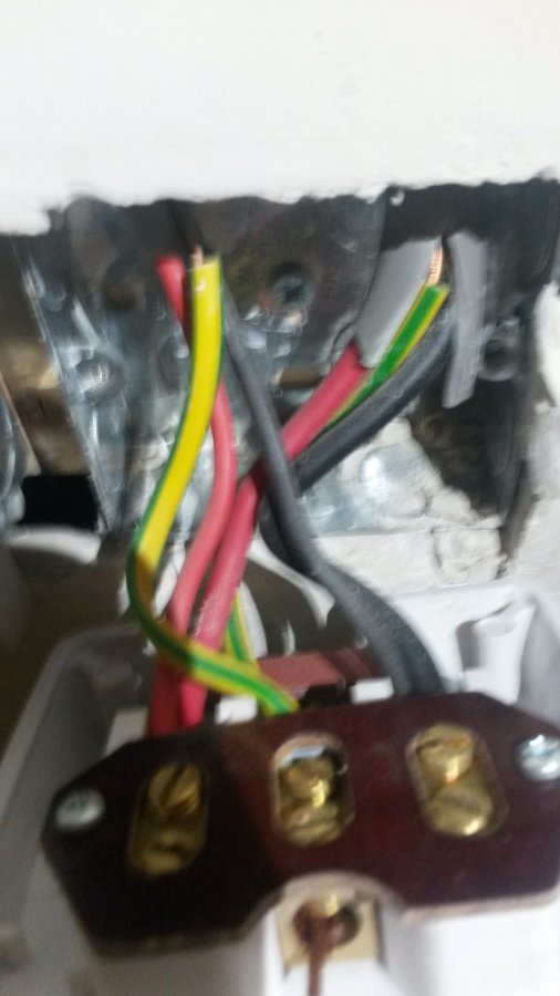

Took the plate off and the left wires are thin ones - the ones on the right are thicker as you can see. I cant understand what the ones on the left are.
Ah... unless the loop around in the wall to supply socket next to it for hob??
EDIT - yes they do. Phew
