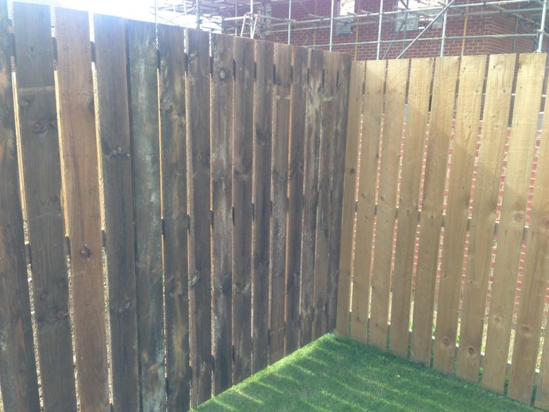

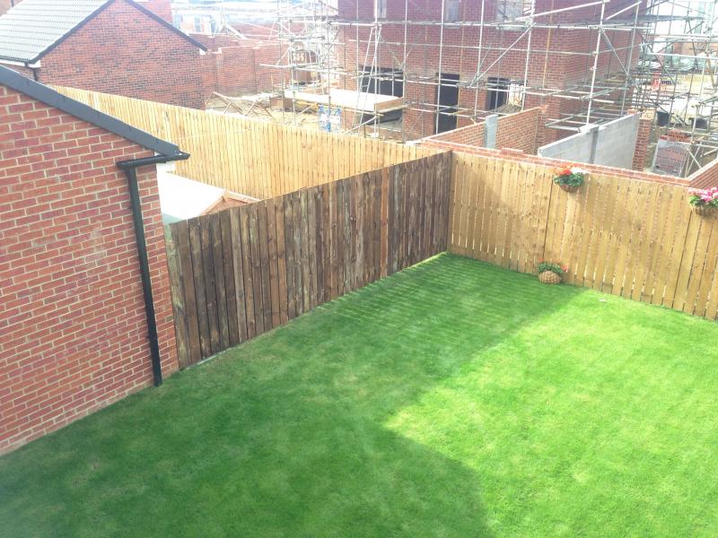

So the fencer came today, and this is what they've put in...

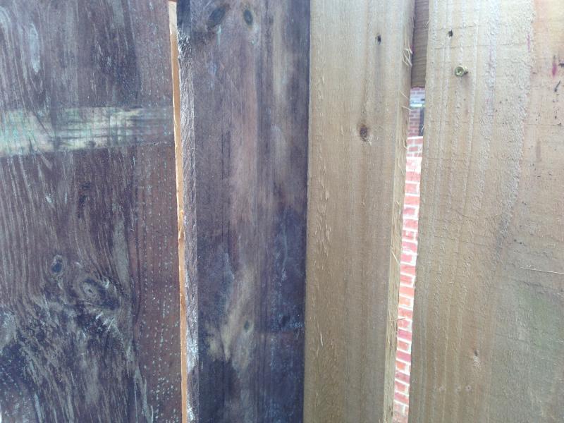

As you can see, the new fence (to the left) is significantly darker in colour to the existing one, which was installed only a few months ago. I made it known that I wasn't happy, and have queried it twice now with the fencing company and they have assured me it is the same wood and will fade to be similar to the existing fence. However I'm majorly sceptical and have said I'm not prepared to pay until someone comes and looks at it who can confirm either way...
In the meanwhile, I'm after your opinions...
...Does it look like the same wood to you?
...Could it just be that the new wood is wet/damp and needs to dry out?
...Would you be happy with this (and be prepared to pay £250+)
Thanks, appreciate the input.
Gareth
It's hard to tell from photo's but it looks like some of the boards have a white mildew on them as if they have been sitting for quite a while in damp conditions.
They would benefit from a light scrub with a water and bleach mix.
As i said its hard to see without being there but the very dark colour is most likely because they have been quite recently treated and so are laden with moisture and treatment chemicals. If that is the reason they are dark then they will dry out fine.
Unless the wood has been treated with a dark stain there is no reason to assume it will not dry out the same as the others in a few months.

The darker wood has either been stored in an enviroment that promoted surface mould growth, or the treatment uses a darker pigment.
Either way, I would agree bleach will "fix" it.
As above. The new panels must have been stored in damp conditions, and algae or mould has formed on them. You could paint them all with coloured fence preservative, which most people do, however mould and algae may stop the preservative penetrating.
I am not sure of your rights here, but I would not be happy with panels in such a state. The panels I had delivered by wickes were dry, and looked new. Yours look as if they are old, and have been badly stored outdoors for a significant time. As you say, they do not match, which was one of your criteria. Did you explicitly request matching panels?
Of course it might be that they will soon dry out and patch the others, given some dry weather ...
