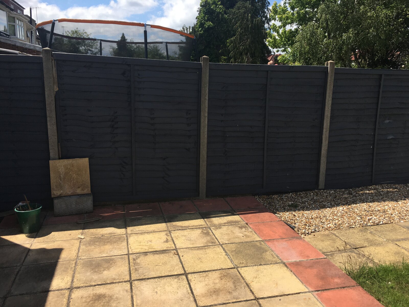

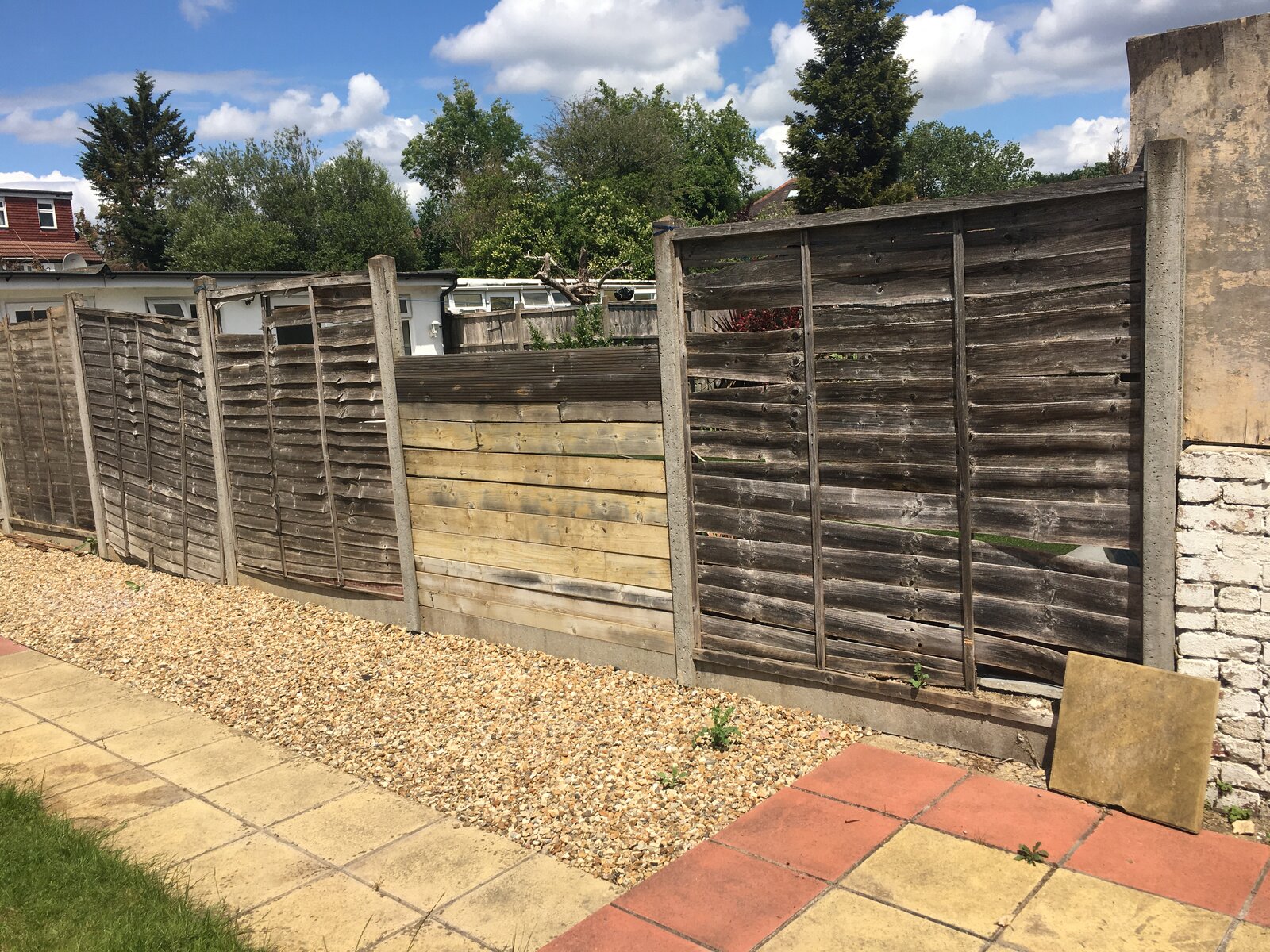

Hi everyone I’m looking to have these fence panels changed the concrete posts are fine I’m looking for a better quality panel what type is best similar design, is pressure treated good, just want something that lasts longer and reasonable price thank you any advice would be helpful
The badly broken ones are my neighbours side which he going to repair and the grey one is mine where the frame at top is torn and I’ve patched up for now
one of your gaps has been filled in with horizontal boards. I've been using decking boards in a similar way, they are treated, strong and cheap. I stain mine before use, it's easier and more thorough.

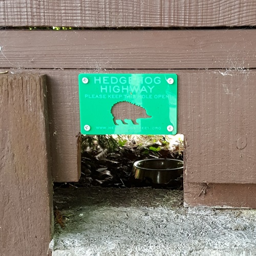

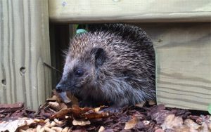

Don't forget to leave some 200mm holes at ground level for the hedgehogs.

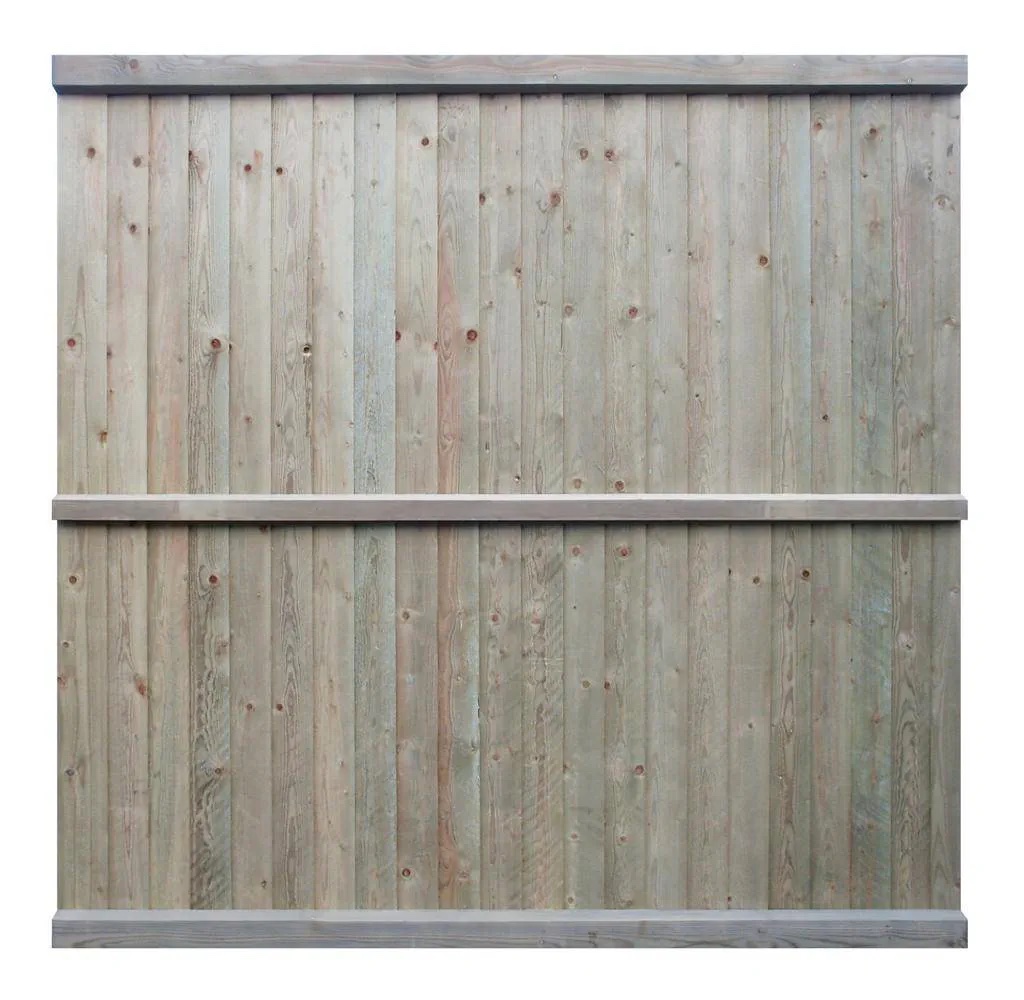

you can get ready-made close-boarded ones which are much better than the larchlap flimsies, but they need two men to carry, especially to slide in from above. It will depend on your local suppliers. Timber yards often have a contract. I got my last lot delivered free by a lorry driver who I thought worked for the yard but had in fact called in for a mug of tea with his mate on the counter.

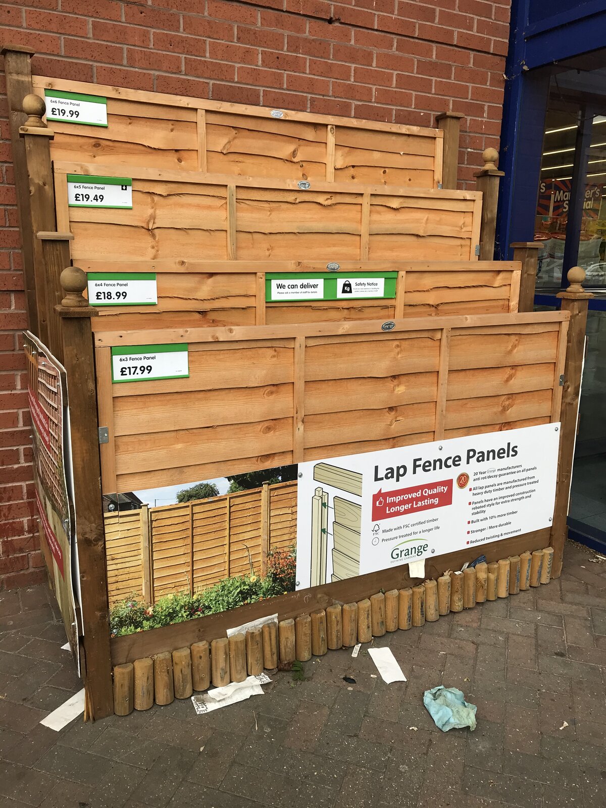

Funnily enough I was ‘shopping’ with the Missus last week at B& M Stores they had a display of Grange Fencing Panels , for off the shelf they looked pretty good quality , maybe worth a look

These are the flimsy waney panels, for a few quid more per panel you can get much better quality
Get "pressure treated" not dip treated whatever you get. The orangey ones are dip treated.
Those waney panels are flimsy and just total crap.
