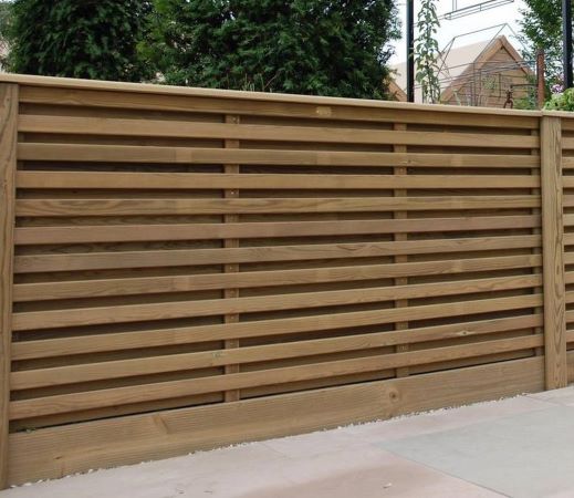

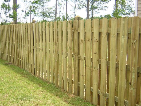

Find a local supplier, preferably a place that treats its' own timber. Alternatively, build your own (this is a DIY forum, after all). The best fencing I've ever seen for wind resistance is Norfolk fencing, or double-sided "hit and miss" fencing. With this type of fence the splats (say 4 x 1 or 6 x 1 treated softwood) are nailed to the rails one side with 2in gaps, and the same on the other side, but with each splat in front of the gap on the opposite side and the gaps opposite the splats, etc. That way the wind can blow through them (and the fences actually slow it down quite a bit), but won't blow over. Not the cheapest solution, but good for privacy and absolutely wind-proof
Can be traditional vertical:
or modern "venetian" horizontal style:
amongst other styles. Any professional fencing firm should be able to supply this style of panel, made to your sizes

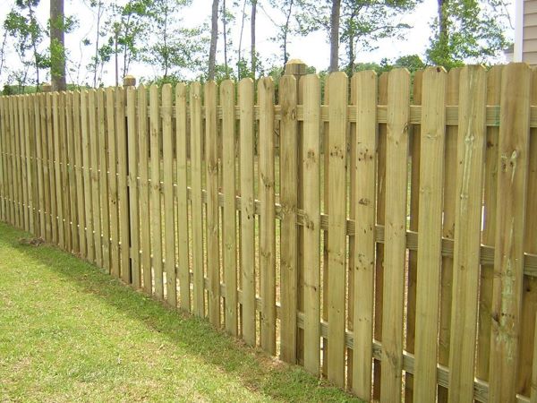

They look good in picture but not a feasible solution when you are replacing old fences in a typical garden surrounded by 6 neighbours. I was looking for fences which I could easily slot in. I couldn't find any local supplier, all I see are B&Qs, Wickes, TPs etc.
They are a very good solution - but generally they are made to order, although they can equally be home-made using a square, tape, hand saw, hammer and nails. Pre-manufactured drop-in solutions tend to be lightweight and often won't withstand high winds due to the design (they lack any form of slots to allow wind to pass through). The first Norfolk fencing I ever made (as a paying job) reached 20 years of age in February and have had little maintenance over the years
