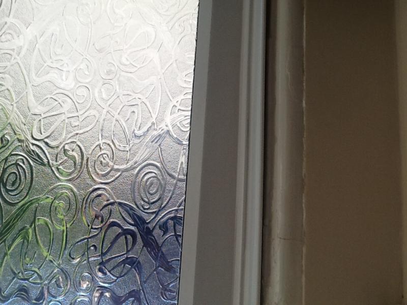

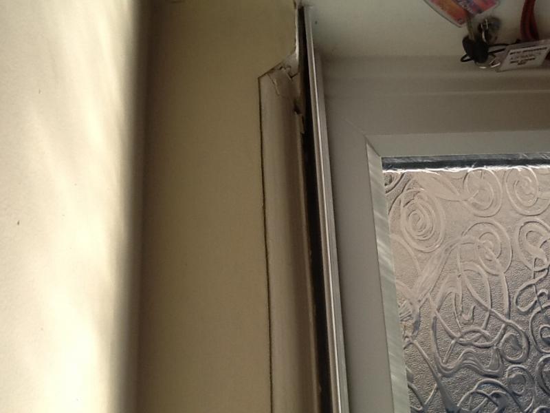

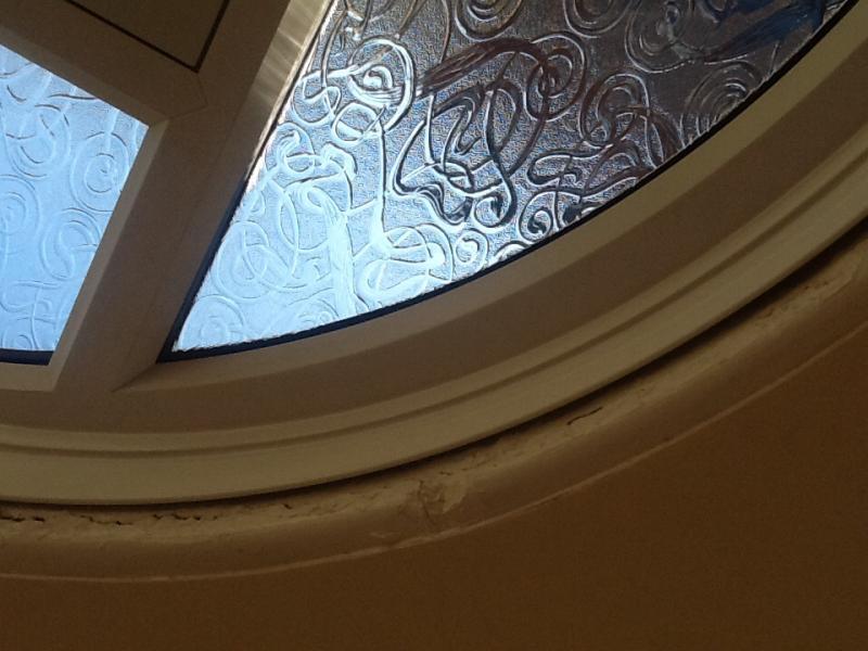

Hi, I had a new arch window and door fitted last month and there is a large gap been left between the upvc frame trim and the plaster.
as you can see it goes right round the arch. I was hoping someone could give me an idea on how to fill this gap, I was thinking of a little bit of expanding foam and then skimming over the top with plaster. But I an not sure would be very grateful for any help. P.s the window company not interested as they say nothing to do with them. Thanks very much .
The trim on the reveal next to the bullnose bead looks shocking its never going to look right why couldn't they fit it tighter? Also fit a smaller trim so it don't overhang the bullnose? Is the window the wrong size? The arch looks easy enough to sort looks like you can put some caulk around it you can get caulk especially for upvc window frames but on that reveal I would take the trim off and get a narrower one so it don't over hang bead I would also consider floating the reveal out a bit and create a sort of step but recessed back a bit from bead and fit the narrow trim on that , how wide is the gap on the arch? it looks small im looking on a phone
thanks for your advice :) I think they had a problem with fitting the door due to old movement in the house, so they told me anyway. The arch gap is pretty small but as you can see it gets bigger as it comes down. I think I am going to have to get a professional in to sort it out as I think its beyond me :(
