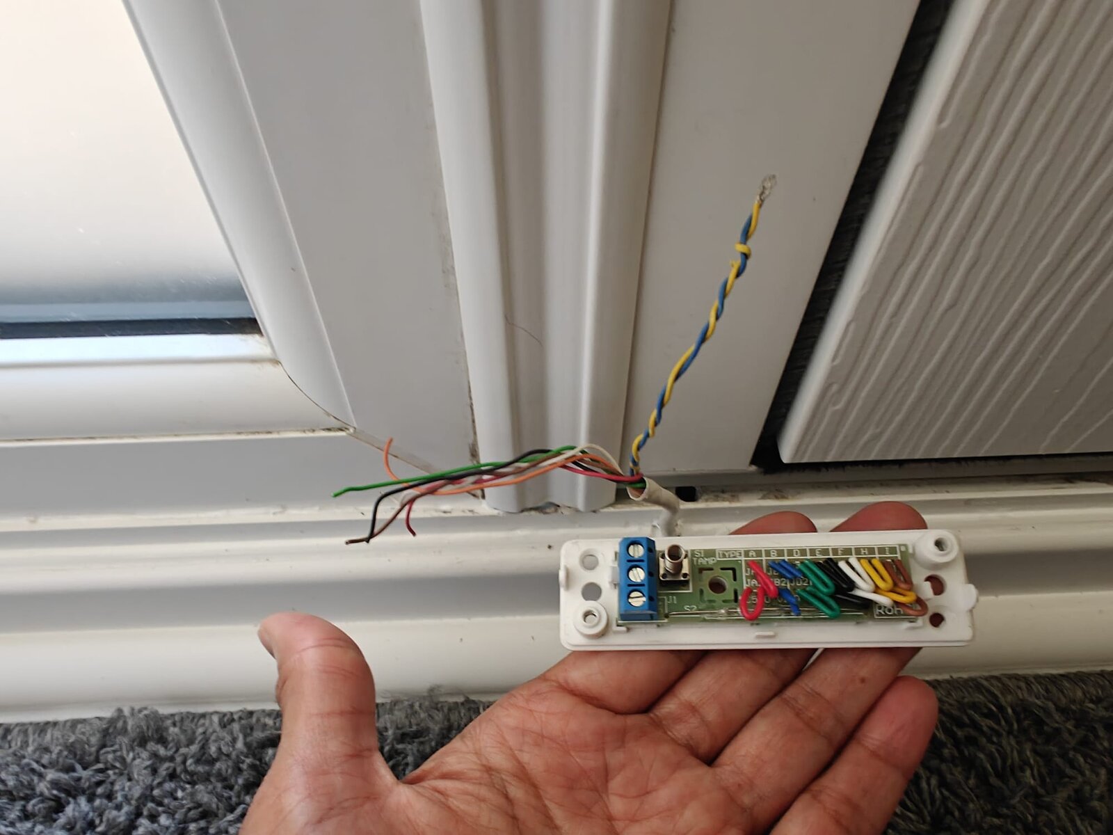

Hello!
I wonder if anyone can help, we had a new front door fitted and sadly I wasn't home, usually when things like this get taken off I ensure a wiring photo is taken so we can replace.
The door engineer didnt do that and has left us with the contact to reattach.....
Blue is already cut and I've got 2 cables blue and yellow twisted together...I assume the door guy did this and that one colours goes in top slot, one in second slot and 3rd is empty?
Does it matter which way round the colours go? (Could i have just tested both way with any "blowing up" issues?)
thanks in advance Lou

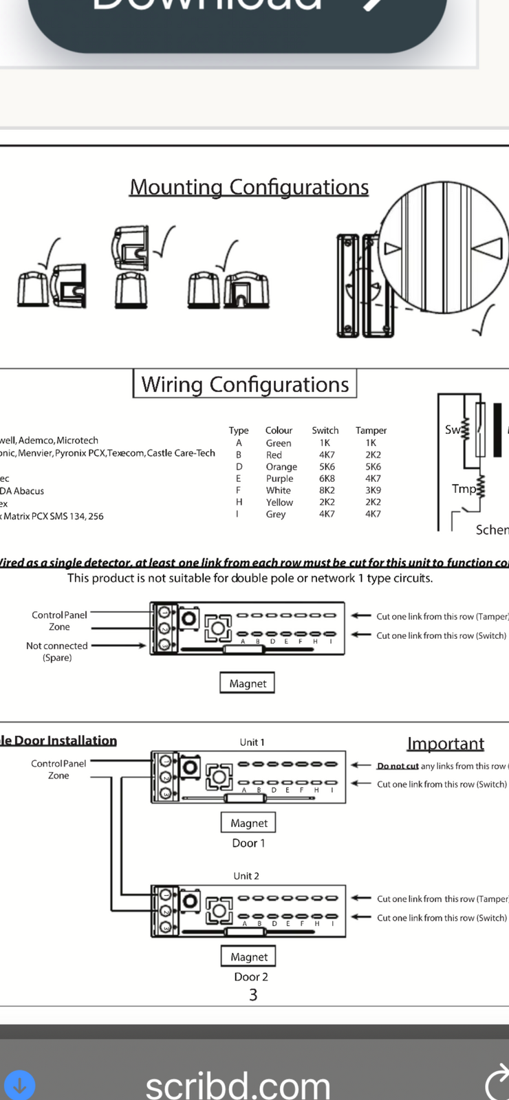

Top two across from microswitch any way around
