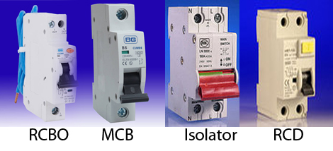

First, is the circuit protected by an RCD or RCBO?

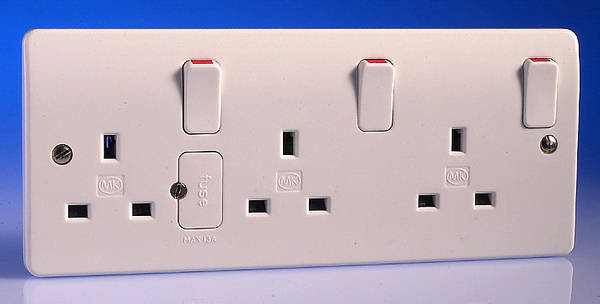

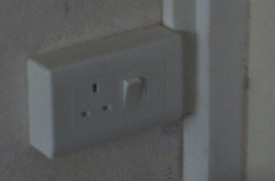

Eric means one of these:
[Actually the cable is the spur. Stupid people call these accessories 'spurs' because they think that is an abbreviation of Switched Fused Spur Connection Unit.]
If only one socket - single or double - on the spur, then you don't need one.
If more than one socket on the spur, then you will need one (them's the rules) but obviously you will then be limited to 13A.
