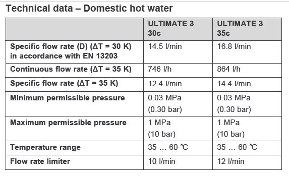

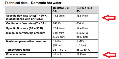

New Glow Worm Combi Low Flow Rate
In this boiler's technical data there are "specific" flow rates listed.
All these "specific" flow rates are greater than the flow that the flow rate limiter will allow.
Perhaps "specific" has a special meaning.

Problem is they specify on their website a flow rate of 12.4, when it is actually 10.
That is just a small problem eh !!!

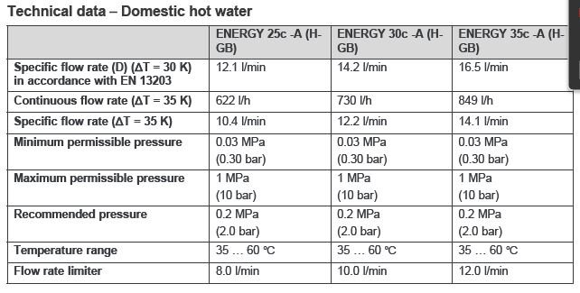

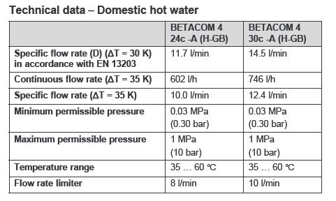

ULTIMATE : Restrictor
STORE : no
ENERGY : no
BETACOM : no
So it seems that the advertised value is reliable for Glow Worm products, but on the Ultimate they have for whatever reason created a situation where they advertise 12.4l/min but only deliver 10l/min.

The energy, betacoms and ultimates all have restricters, like most modern combis. And yes, they are all 8/10/12litre restricters depending on boiler size.
Now where you say they advertise 12l/min, they do not. You just don't know how to read a technical manual. They are required to state a flow rate at 35 degree rise, its not a statement of what the flow rate is, flow rate will be dependant on a number of factors, plenty boilers are fitted on supplies that cant flow enough water to reach the full flow for example. The manual states what restricter is fitted, its the person who specifies the boilers job to arrange and fit one to whatever spec they have agreed with you.

Okay, the manuals for the Energy, Betacom, Store don't seem to mention a restrictor - I checked all the pdfs this morning. Perhaps you can point out where they mention the restrictor?

No Unless your water pressure is unusually high a 10l/min restrictor will only allow 10l/min. They have to state what flow rate would give 35 degree rise in temperature from the cold going into the boiler and the hot going out, it has zero correlation to the actual flow you get from a boiler, its a technical document that must include this information.

Misleading? I think so. No doubt somewhere in the approvals there's a reason for fitting a 10 litre/min flow limiter but to publish the 12.4 litre/min figure knowing it's unachievable and not saying so is incompetent.
Under the type approval the specific flowrate at delta 35 must be given....and over the years that flowrate has become a benchmark standard for installers and the public to compare performance. In fact many manufacturers will actually state that flowrate is achievable.
Something has changed, I've looked through several boiler specs from many years ago, as an example I looked at 24kW boilers that typically quote 9.5 litre/min at delta 35 and they are sensibly fitted with a 10litre/min restrictor.
