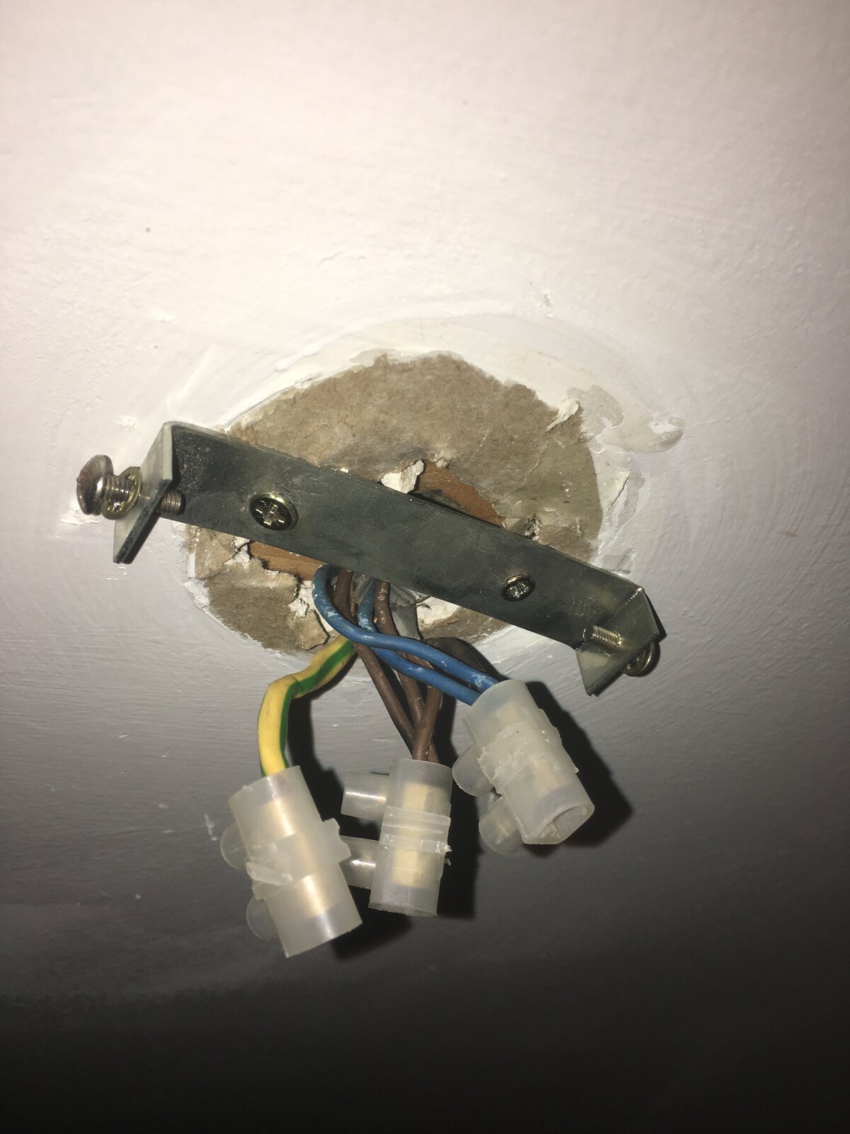

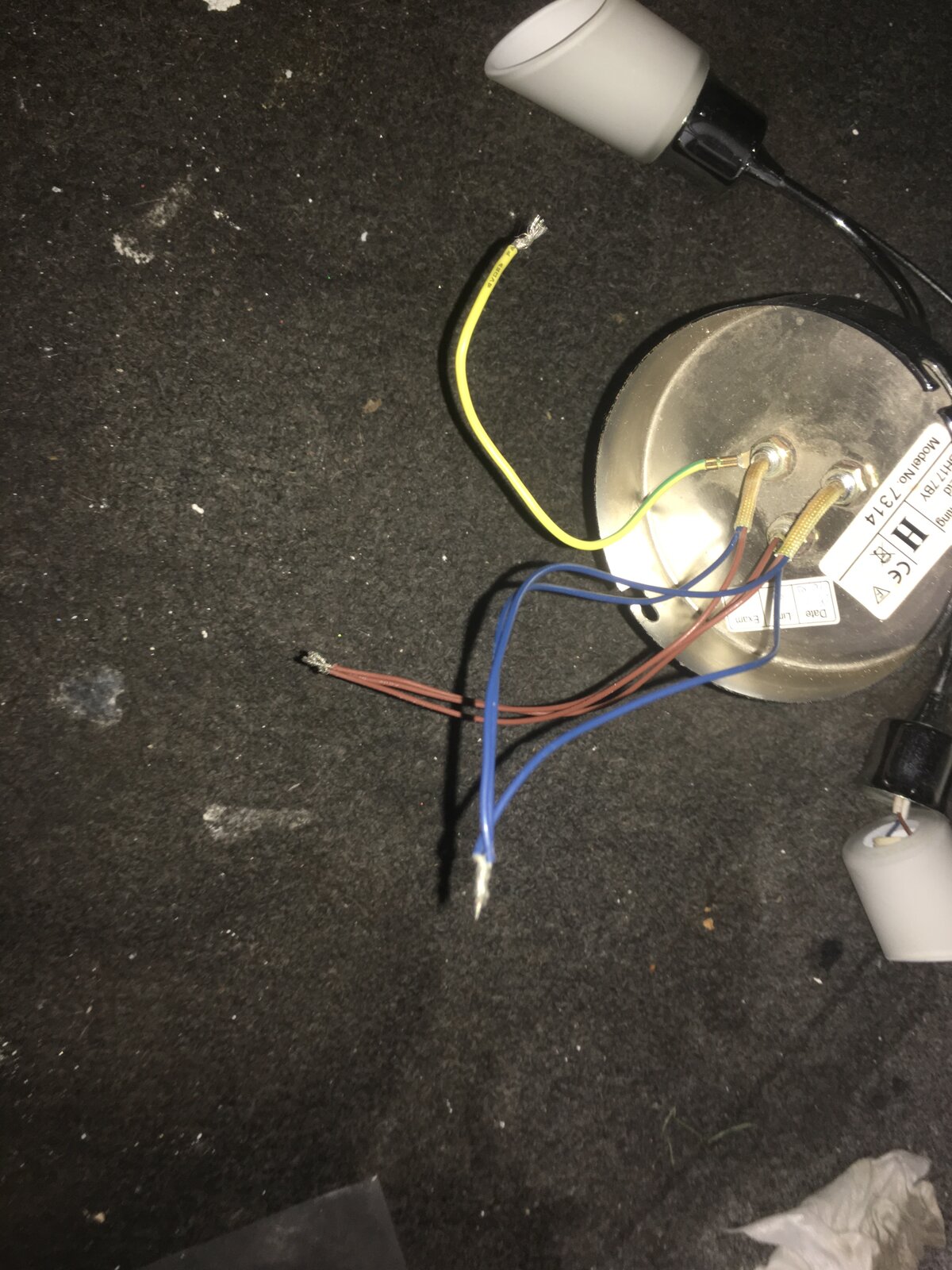

Hi there recently I bought a 2nd hand light fixture for our hallway this particular unit uses G9 Halogen bulbs now the wiring for this has 3 blue wires going to a screw terminal connector with the same with 3 brown wires and a thick earth wire.
now from my ceiling I have the same 3 neutral and 3 live wires my question is do I only use 1 of each type when making the connection but when I did that and had the wall switch off and turned the breaker on the light went on and upon switching the wall switch which popped and is now dead can some explain weather the neutral and live wiring On the light is coloured wrong and I reversed polarity if you need more info I can try provide it I will include photos.

Did you remove the existing ceiling rose which was there and simply put the different coloured wires together in three separate terminal blocks?
I removed the rose yes and on the picture of the ceiling wires those terminal blocks were on the new light fixture I just removed the wires to the light and left them up there rather than have exposed wires but as the previous rose light used all the wires shown I uses all wires for this one.

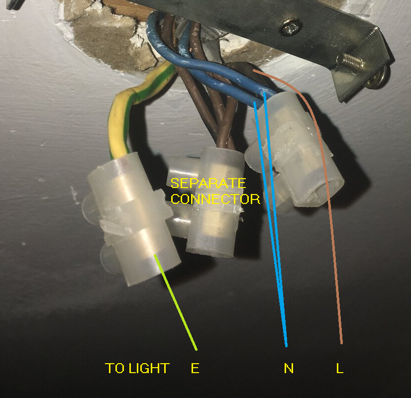

The 2 blues are your neutrals which the blues on your light go to.
The blue wire with brown sleeving is the switched live which goes to the browns of the light
The brown stay connected together with no cables from the light connected.
The green/yellows go to the green/yellow of the light.
You didn't examine or mark the cables before you unwired them I see.
If you had you would of spotted the wires don't go together as shown, all you have done is create a short with the light switch which will cause the fuse to trip as soon as you turn the switch on
You can put them together as mdbalson says or because you clearly don't know what you are doing when it comes to electricity or wiring I would not touch it and get in a spark to sort , it won't cost you a lot
