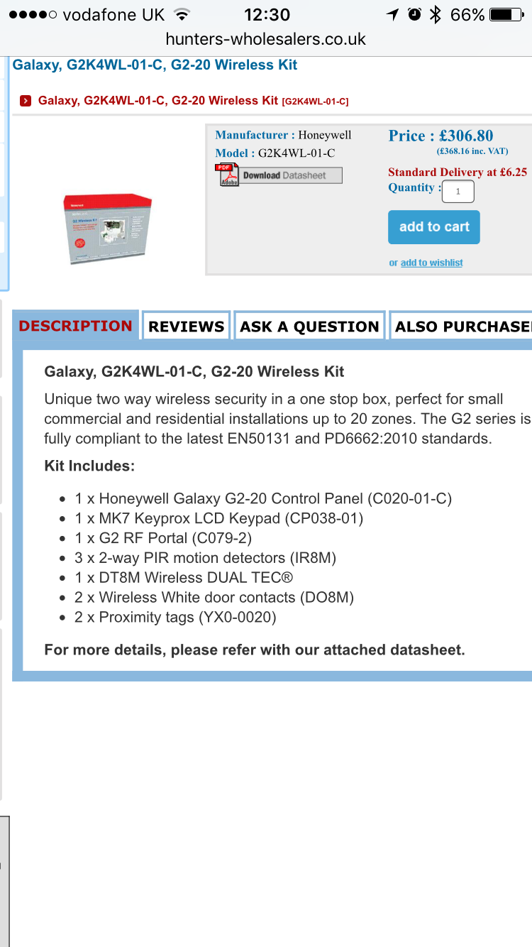

I attached a photo of the above pack I was thinking of ordering.
I am happy enough with programming. Just wanted to check: would the only wiring that would be required between the panel, bell box, RF portal and keypad?
Thanks!
Yes, if going wireless, then bellbox, keypad and portal need wired. You may also want to add an internal sounder or speaker. The portal is usually wired near the panel depending on the location.
