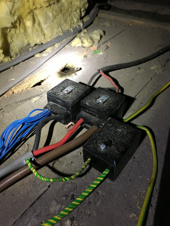

I have found that the split concentric goes into the loft, and terminates in these Hendley Blocks that are on the floor of the loft just inside the hatch (nice place that) The twin & earth and the dodgy rubber cable feeding the two CU's are run from these.
What is the best solution to this?
Cheers,
Will
