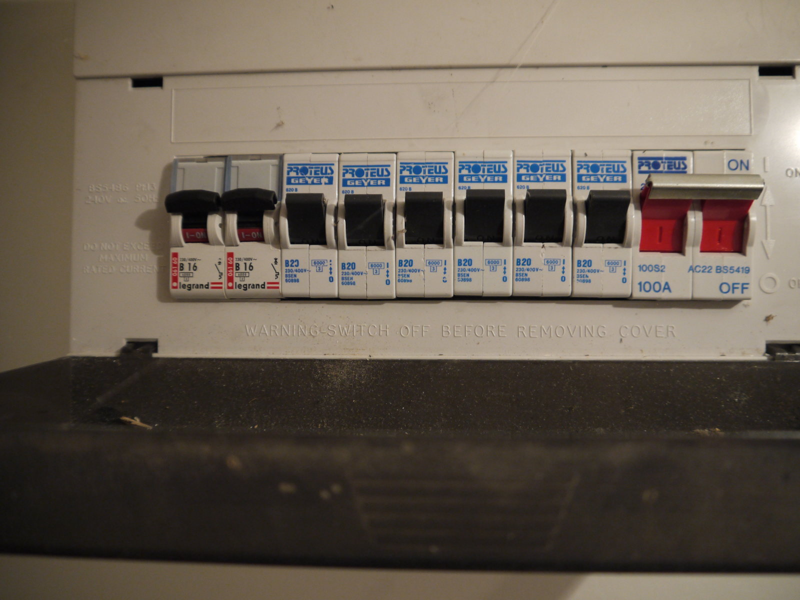

Now I think that the idea of wiring the lower heater to the economy 7 system is a very good one. And a separate booster switch, too, on the daily rate. So I've photographed the econ 7 consumer unit for your info.
Oh dear: . We have seven storage radiators in our bungalow but only 6 mcb's in the consumer unit. We must have one mcb supplying two rads. Maybe that ought to be changed regardless.
If I want to connect the hot water cylinder lower heater to the Econ 7 consumer unit it seems i will need a new 8 way jobbie. (The cylinder heater is supplied now from one mcb in the larger consumer unit).
I hope someone understands the layout in the Econ 7 consumer unit. I dunno what the two mcbs on the left do.

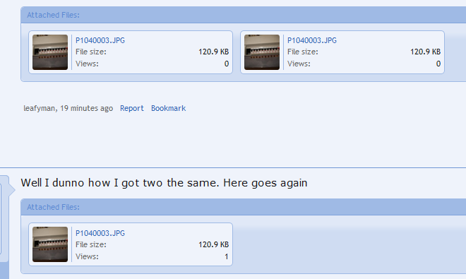

Ouch. I didn't get the photos on. Trying again. No luck. I have the jpg numbers of the snaps I have in my computer. How do I get them into a reply?
Well I dunno how I got two the same. Here goes again
I can see 8 - which would match very well with 7 heaters and one for the immersion.
Two are LeGrill rather than Proteus, but that doesn't really change anything.
