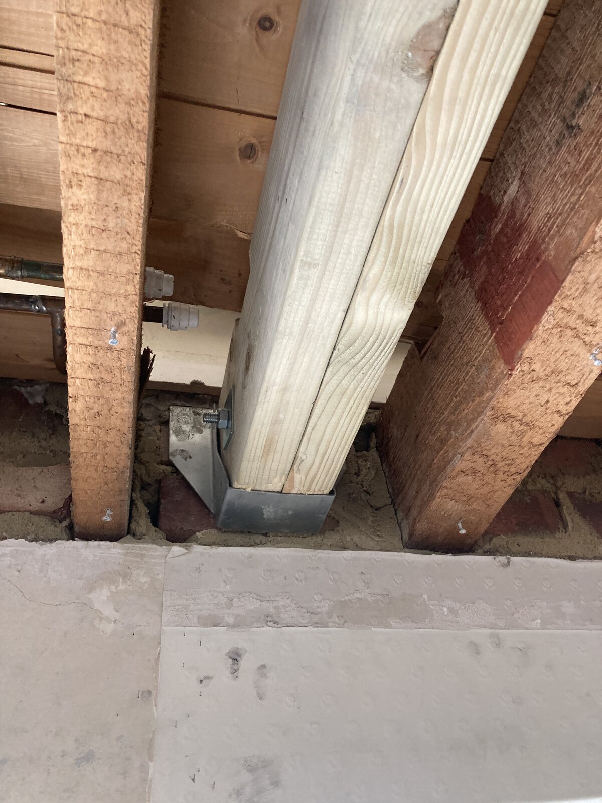

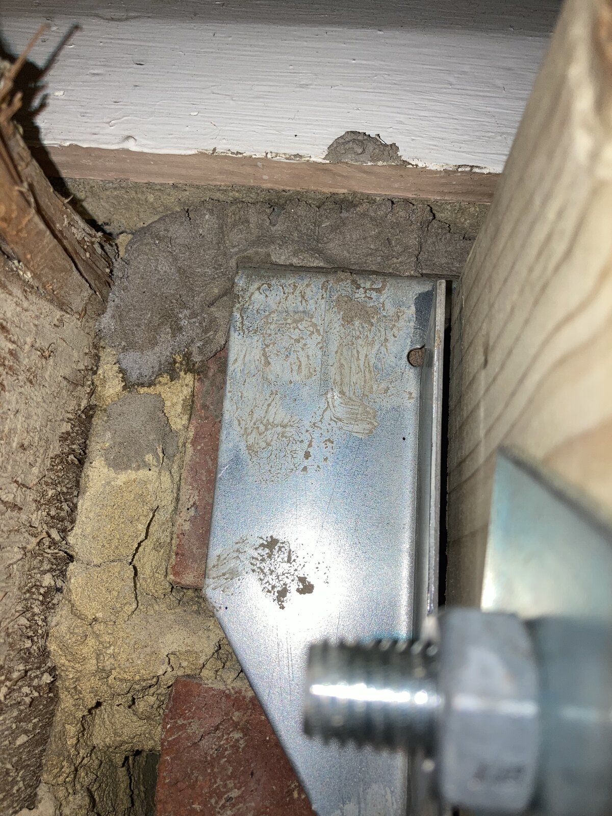

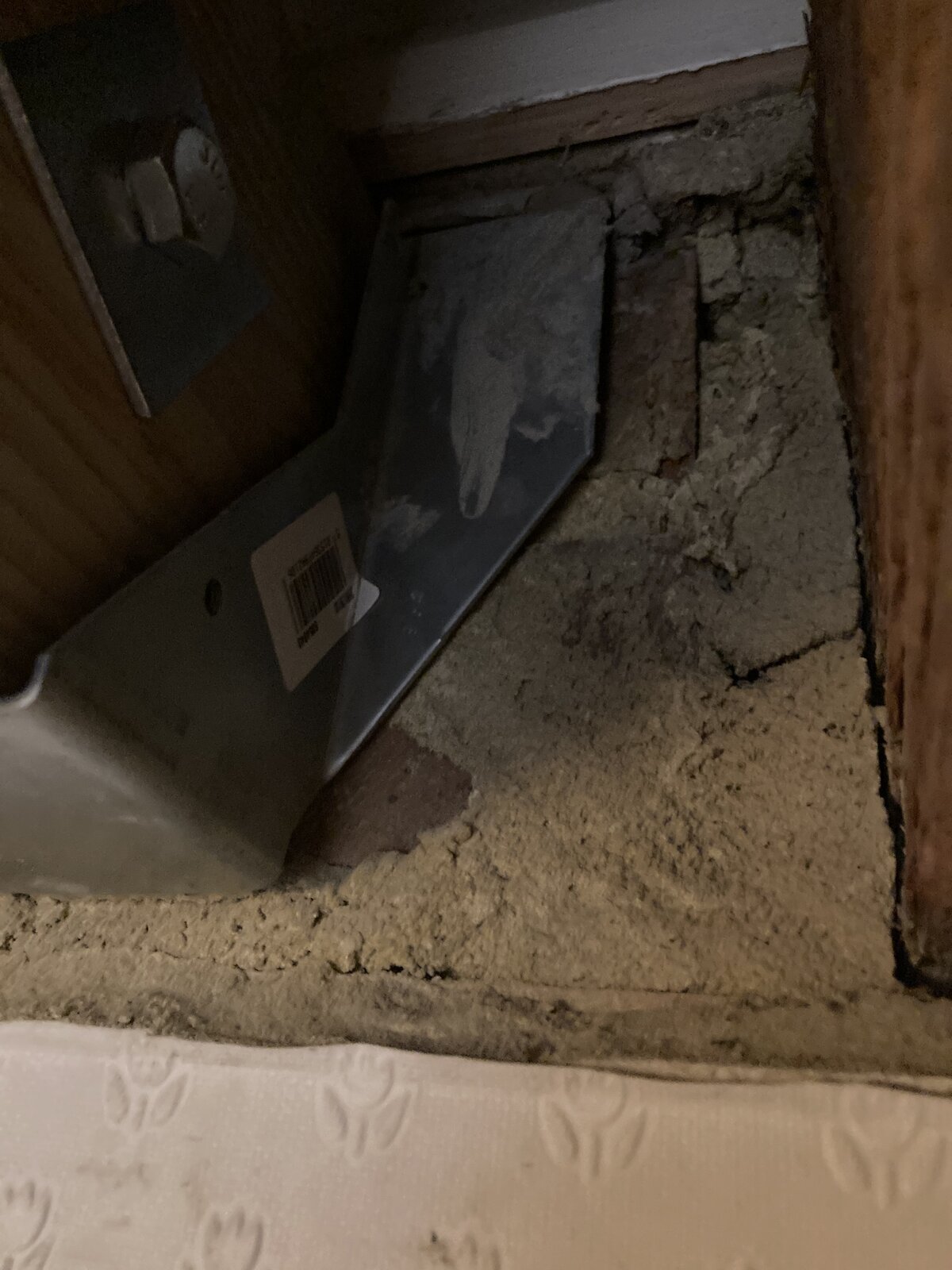

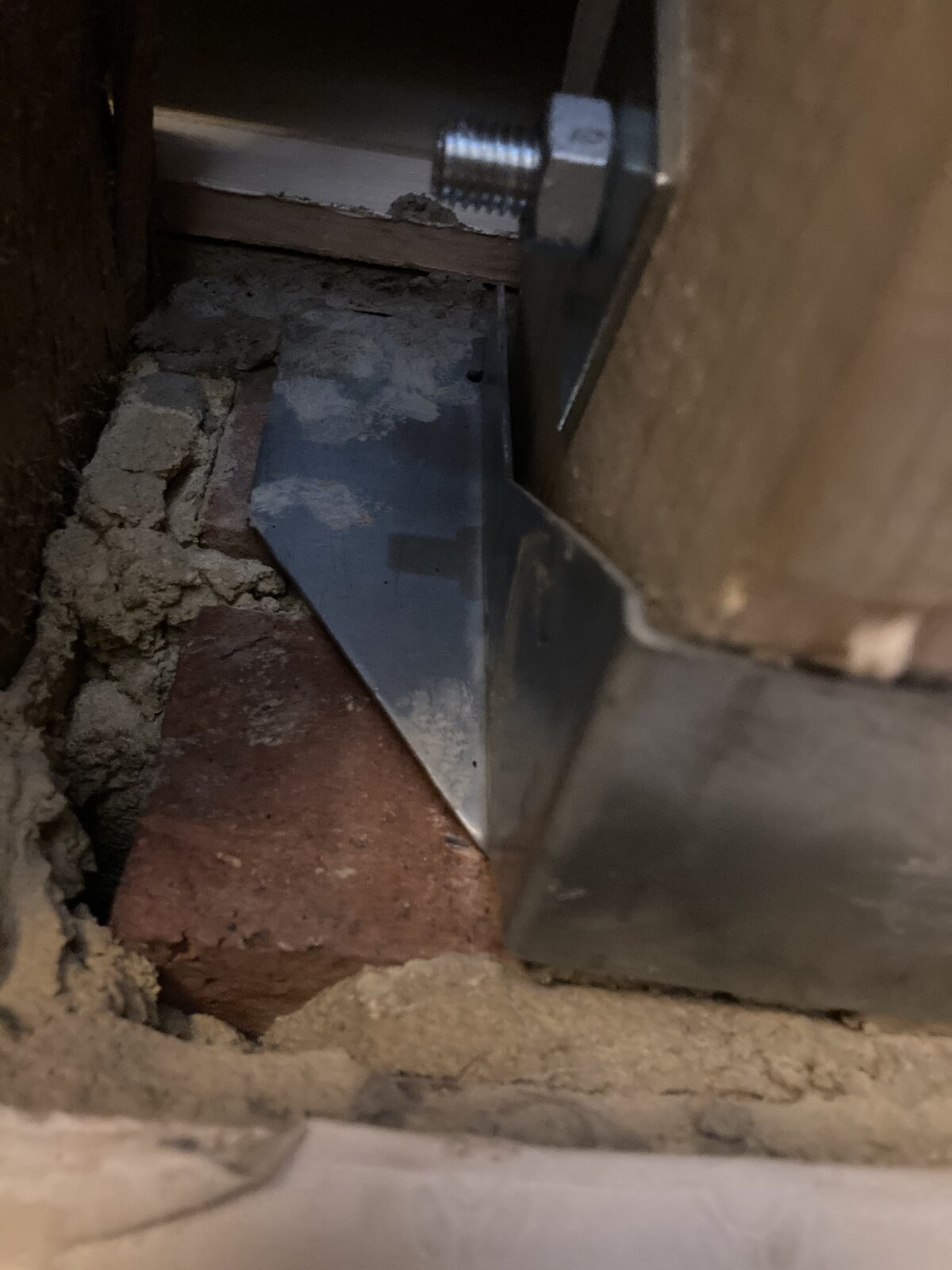

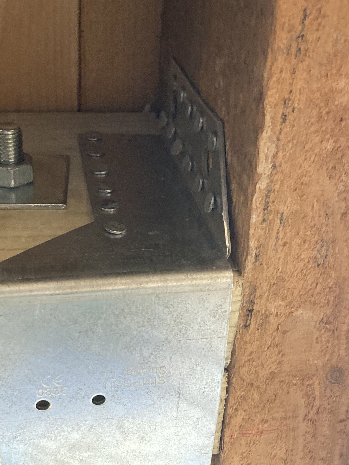

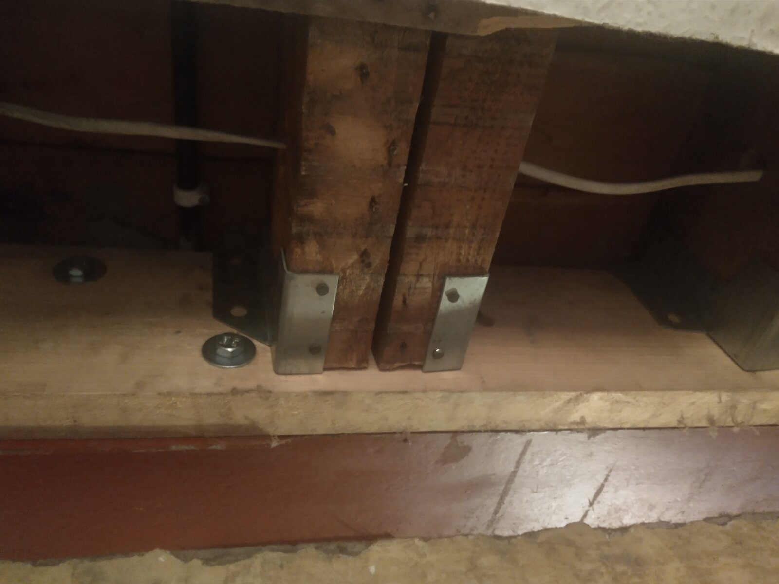

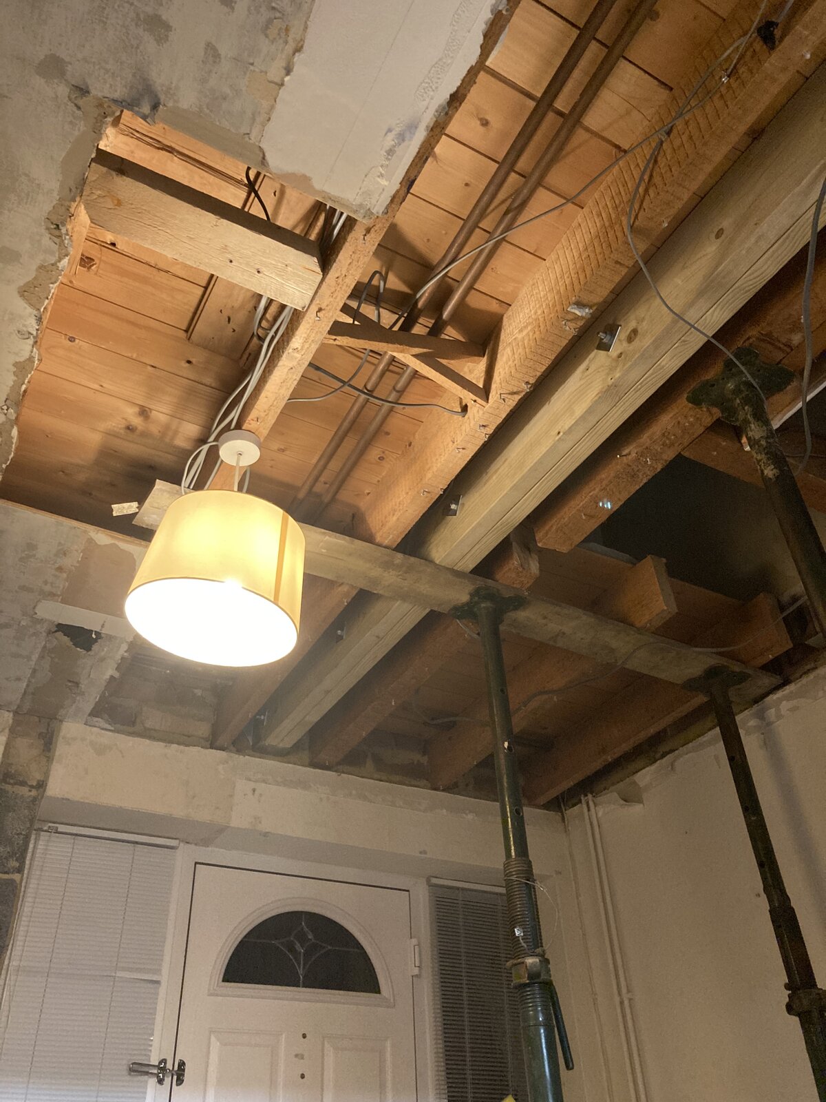

Hi all,
first time poster here.
move been embarking on planning an extension project, which will be a new sips structure connecting to my existing house.
as part of the project I need to replace my existing stairs and enlarge the opening. After months of planning I had my first weekend of real work and installed the long length trimmer, which is a double joist bolted together. All generally went well with a number of hiccups on the way, but nothing insurmountable.
Anyhow, now I’m completely paranoid about not having fixed the joist correctly. I have attached some photos and wondered if any one could have a look and put my mind at rest- or confirm my fears .
thanks all.

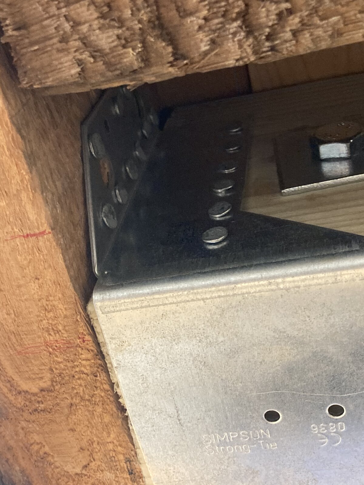

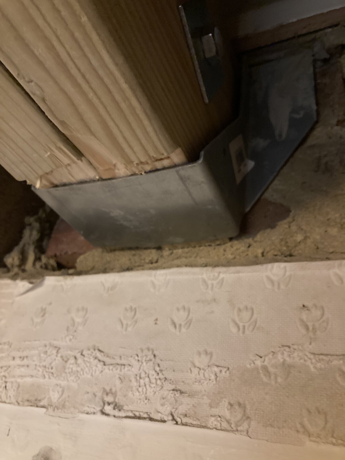

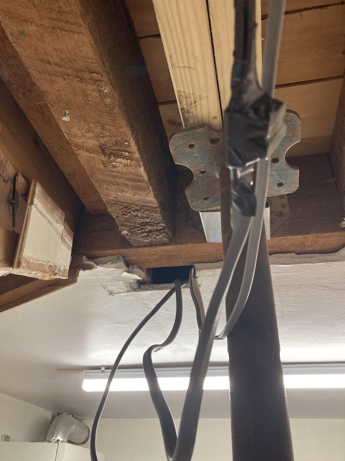

Looks OK to me. All the holes in the nail-set joist hanger have twist nails in them and your bolt centres look to be 600mm or less (although the middle one is still missing a washer and a nut - photo 8 ). I'd probably have put a nail into the side of the zip hanger (the one in the masonry), but that's about all
Thank you so much for looking and commenting. I was tying myself up in self doubt despite having planned the work for ages.
I’ll get the missing washer added and will add the nail to the zip hanger. I couldn’t think how to get the hammer onto a nail in the small gap, but having thought about it since, I’m going to try hammering onto a flat bar resting on the head of a nail, which will hopefully get it in.
That or use the flat cheek at the side of the hammer head

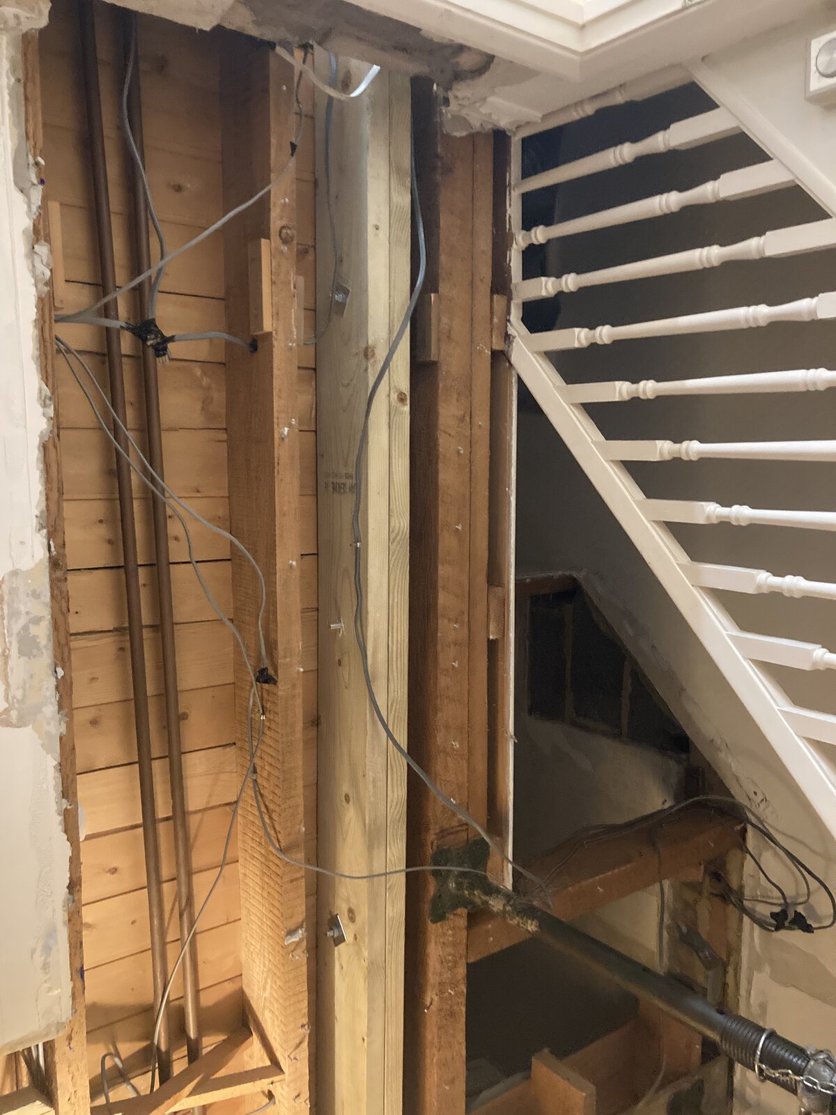

Maybe you know all this but.
The pipes need clipping to backings and the cables need sorting and clipping too. No cable should touch a pipe.
The obvious tape wraps need junction boxes. fix the J/B's to a backing dont leave them floating.
For down lights see the sparkies forum.
Bolt on Timber connectors dont seem to have been used - before closing up the ceiling give the nuts a last tweak.
Put some bouncy weight, yourselves, on the floor above to test for squeaks or movement.

Thanks for the comments - yes, much of this is on the radar. The tape wraps and existing cabling pipework will be replaced in the next phase of works.
Will also do the bounce test and give the nuts/bolts a last little nip-up before closing up.

Under no circumstances should you ever drill extra holes in joist hangers (if it were necessary, I'm sure that firms like Simpson Strong-Tie would have done it in the factory). Their strength is calulated and drilling extra holes can weaken them, especially as they are only thin metal. You should, however, fill every hole with a twist nail, as this is specified by all manufacturers
AFAIK what engineers mean by timber-to-timber connections is generally a coach bolt and nut and square washer with a dog washer placed in between the two joists. My understanding is that coach bolts are specified for ease, as they only require one spanner or wrench to tighten, whereas an engineering bolt requires two. In circumstances where we have not been able to source appropriate size coach screws they have accepted conventional bolts with two washers.

Thanks - I wasn't thinking of drilling extra holes in the hangers - just using the large bolt holes that are there (there is one on the flange on either side). My thinking was that drilling large holes in the joist would weaken the overall joist - hence my use of twist nails only.
yes, noted and agreed on the existing flooring.
A lot of joist hangers don't have them at all and they are very rarely specified as to be used, about the only instances I've ever seen them called for by an engineer have been where one trimmer is being carried by another trimmer or where the floor is to be subjected to heavy loading (as in a commercial building). In that case you don't use twist nails on that face, just bolt it on - it's one or the other, not both.
I think photo 3 is the clearest one showing the holes. I've gone down the route of twist nails, so i'll stick with that and will elave the bolt holes empty

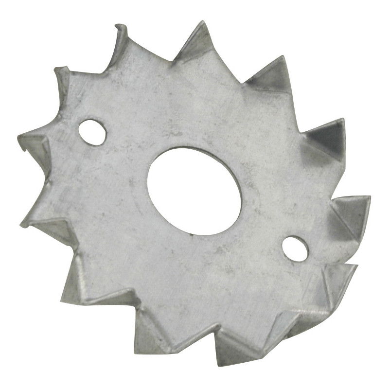

No i dont mean coach bolts. Bolt-on timber connectors are jagged washers that prevent any slippage movement betwen the connected pieces. See Simpson M12. Should always be used with Bolt-ons.
Ah, timber connector washers, or "dog washers" (see above)
