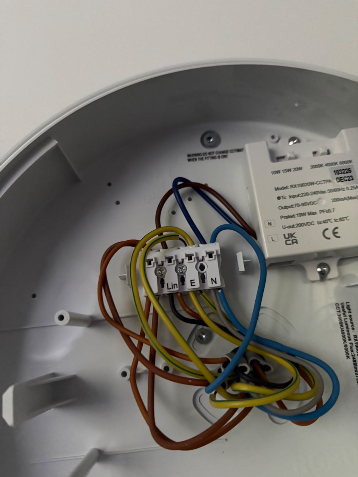

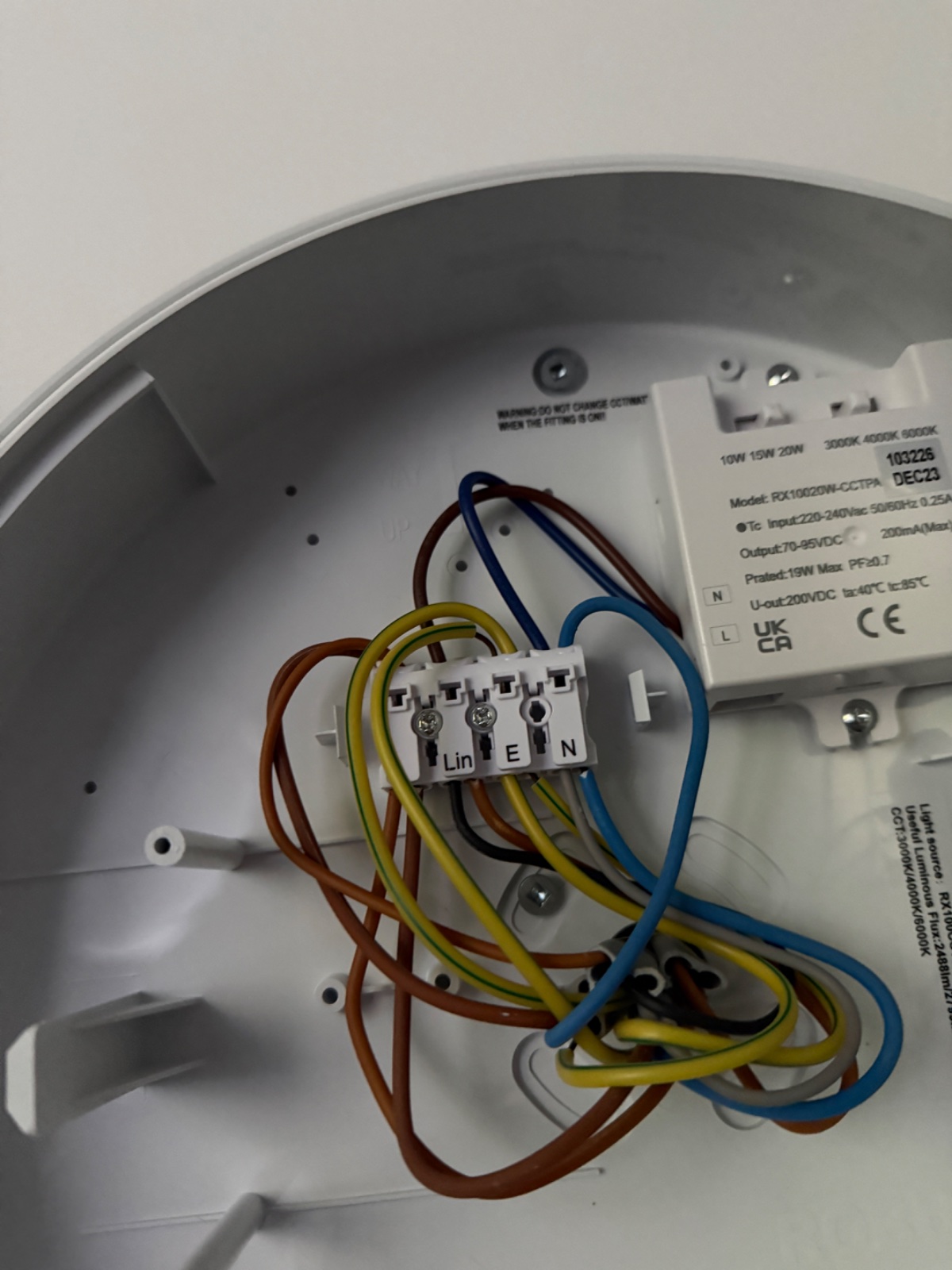

Hey guys,
I want to install a new LED light fitting and require a little guidance with this wiring. This is the wiring into the current light that I will be changing.
Using Wagos, I have access to the 4, 3 and 2 way connectors.
Just use what you need to connect it as it is now.
The 4 browns on the left will go into a 4 way wago and not into the fitting, unless the new fitting also has a loop connection?
No it just has a terminal block for live and neutral and limited space for much else. I may have to cut into the ceiling plasterboard a little for wagos.
So correct me if I'm wrong (most likely):
4 browns on left into a 4 way wago
4 earths into a 4 way wago
2 blues + grey (on the right) + blue from new fitting into a 4 way wago
Brown + black (middle) + brown from new fitting into a 3 way wago
Sounds about right, the wagos need to be enclosed in a box not just floating about above the ceiling.
Make sure you dont mix any wires up mark them with tape or pen or however.
(Looks like it's only the one brown you could mix up so be careful)

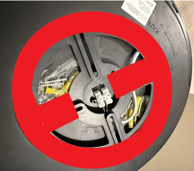

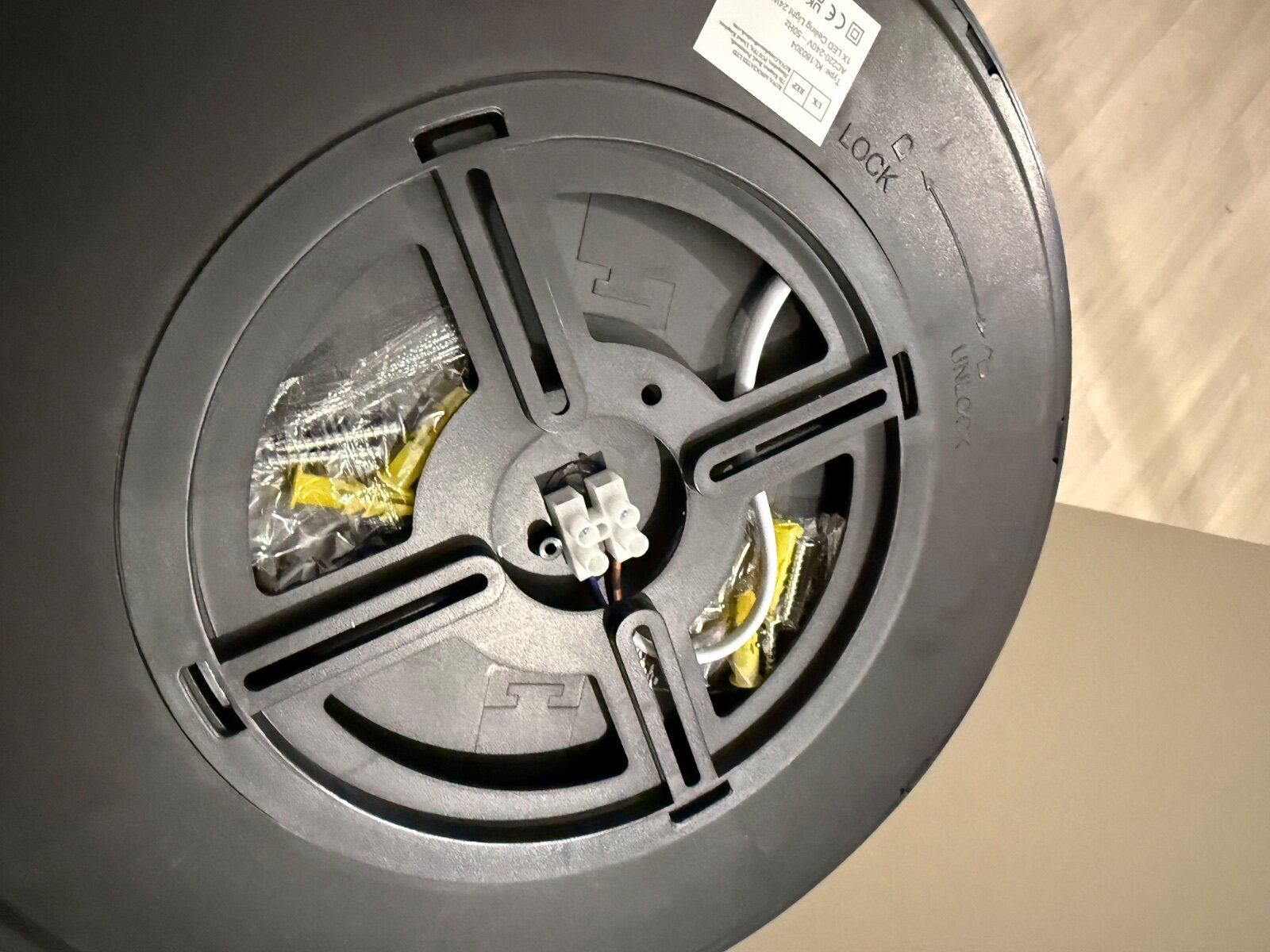

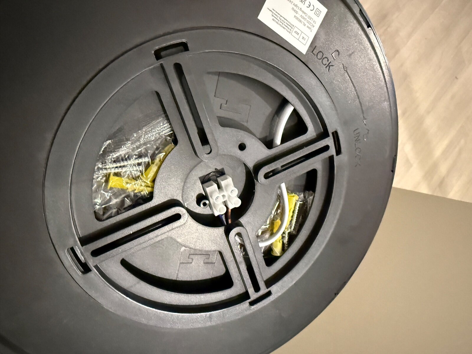

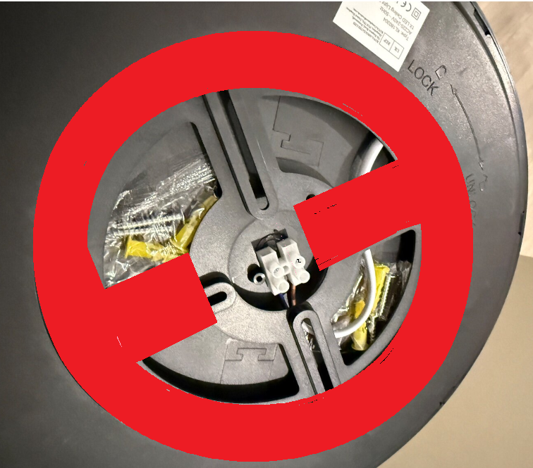

The new light looks very tight is that the inside of it?
Yeah. Amazon!
Fitted two before in my old home with just a little struggle. Good for the money.

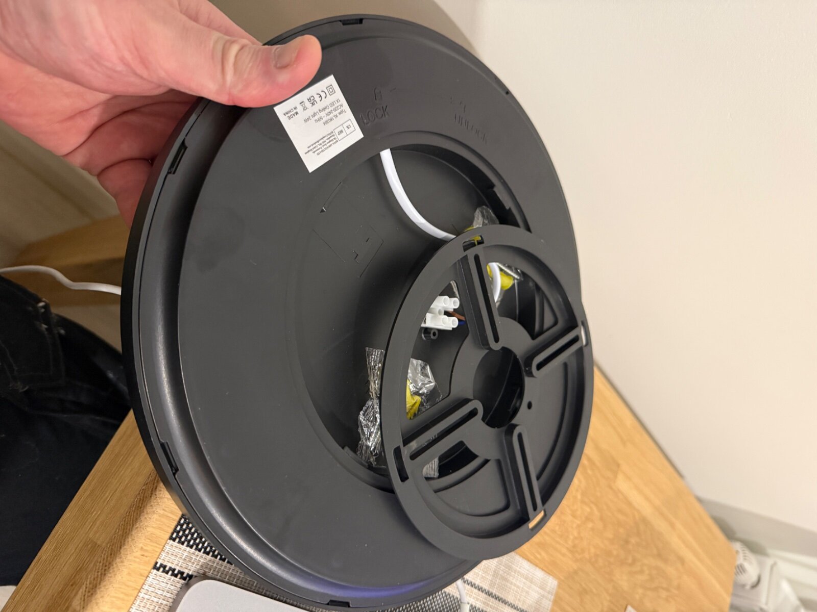

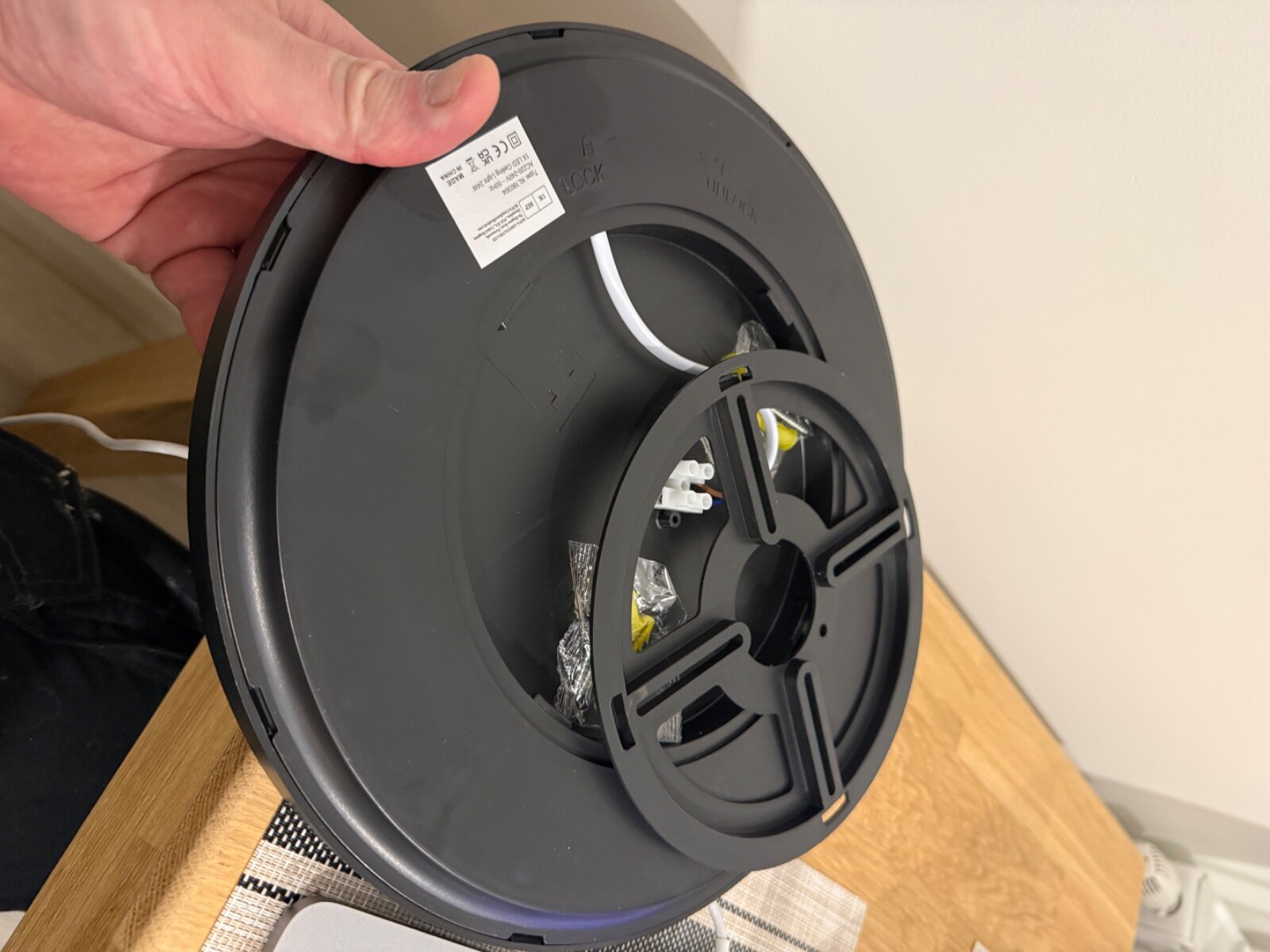

Would a wago box be required if the connectors managed to be located at the back of the light fitting and not into the ceiling? Be some hole to make for a wago box.
No you wouldnt need a box if the wago were inside the fitting, but it looks tight
I agree. I'll give a go tomorrow and see how I get on. Thanks for all the help and advice. Much appreciated.
How about creating a spacer between the ceiling and fitting just thich enough to give the extra space required, I imagine it's only looking for an extra 6mm so perhaps a piece of ply or a cheap plastic chopping board.
How about creating a spacer between the ceiling and fitting just thich enough to give the extra space required, I imagine it's only looking for an extra 6mm so perhaps a piece of ply or a cheap plastic chopping board.View attachment 405472
I get where you're coming from. I didn't get a chance to tackle this today, but will do so tomorrow and update. Thanks for your input
Hey Pete,
I only got around to fitting these ceilings lights today. I used the Wagos and followed your wiring advice and they were a doddle to install. The wagos actually just sat in the spaces at the back of the lights nicely. Thanks for your time. Much appreciated. (y)
