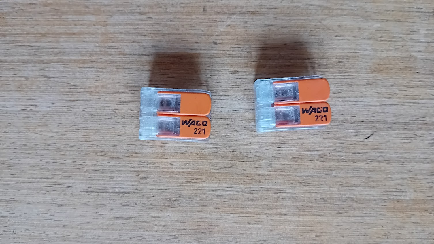

A neighbour knocked on the door last night while I was out until late, Waking at 10am I find the note.
Their decorator removed a wall light and trying to refit it "Blew out the whole house", at that they 'made it safe' by terminating all 3 wires into Wago's to leave it for me to sort.
Seeing what had been used and todays posts here I thought time to add a comment.
All 3 wires had been inserted into Wagos but the power could not be restored... the decorator didn't understand why.
Here are the Wagos I removed.
They made it safe alright. If the power can’t be turned on the circuit is perfectly safe. Just not particularly useful
Ah yes but this is tripping the RCD covering half of the circuits
