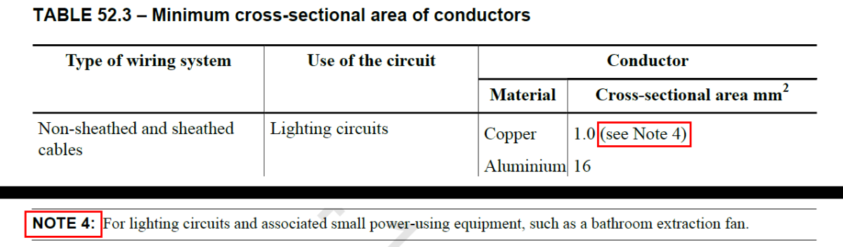

The 18th DPC has a new Note 4 for the infamous table 52.3:
The 18th DPC has a new Note 4 for the infamous table 52.3: ....
I suppose that's a (very) small step in the right direction but, quite apart from anything else, as far as I can make out the DPC still leaves 'lighting circuit' (part of the new Note), per se, undefined. I suppose the implication will now be that circuit must only supply lighting and 'small loads' (which is essentially what we have all always 'assumed') - but regs obviously should not rely on implications.
I also imagine that some of you lads are involved with 'lighting circuits' (in the everyday sense) with a load which is greater is the case with many a domestic or commercial 'power' circuit! The more I think about it, the less can I understand why there needs to be a distinction.
Kind Regards, John
But the DPC is still using "power" to describe circuits distinct from lighting. As Ban says, all circuits are power circuits!
So if Table 52.3 is going to end up saying that you may use small cables for small loads, but you have to use larger cables for larger loads, its point is what, exactly?
Would it not still require a (clear) definition of a 'power circuit'?
In the absence of such a definition, I would expect that many people would probably feel that a circuit supplying, say, a string of BS1363 sockets was a 'power circuit'. However, even if that circuit were designed/intended to supply only tiny loads, if it were regarded as a 'power circuit' then it would have to use cable of a minimum of 1.5mm², wouldn't it?
I think we are probably all agreed that it appears to make no sense to try to subdivide circuits in this essentially arbitrary fashion.
What about a dedicated circuit supplying just, say, a (very low power) alarm or router? Will we be allowed to call it a 'lighting circuit' (daft!) and hence use 1mm² cable, or will we have to use 1.5mm²?
Kind Regards, John
