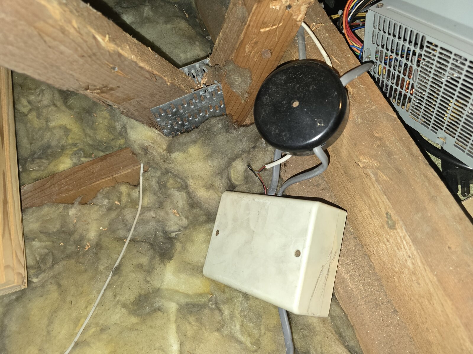

I have these 2 boxes (one black, one white) in the loft where the lighting cable goes into, then out of and services a set of 16 halogen downlights across 2 bathrooms.

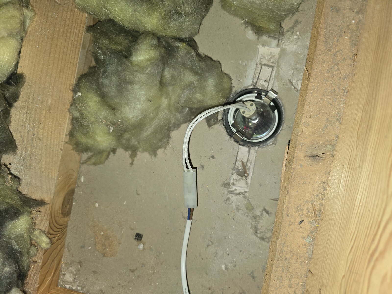

Then this is what the connection to each downlight looks like.
Where do I put the transformer? Is it replacing the 2 boxes or do I need one transformer per bulb and put the transformer just above the bulb cable?

Just tried to swap the last one again for an LED and all of the last row of 3 started to flicker, very strange. I don’t think there are transformers on any of them (as in they all look like the 2nd picture below)

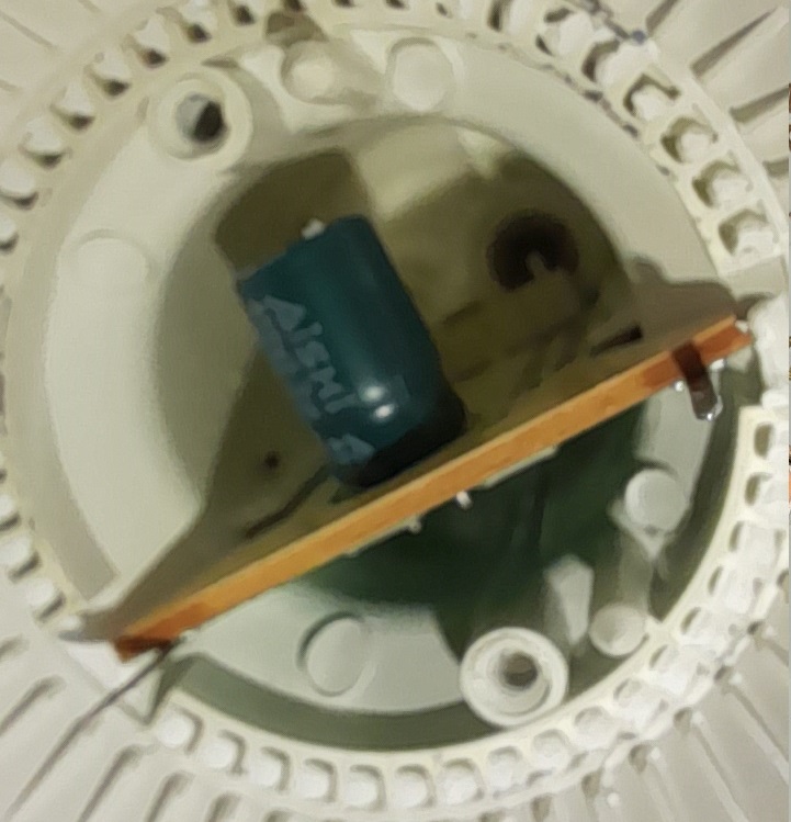

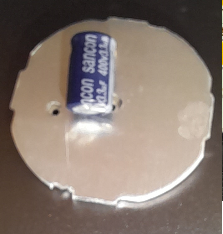

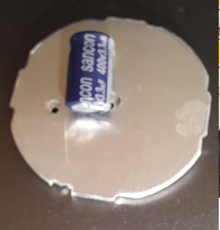

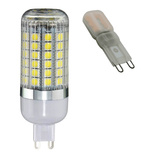

I had the same with low voltage (230 volts) switched with a smart switch without a neutral. Five lamps, four LED and one halogen OK, but five LED flickers and would not turn fully off. My wife found some bulbs on the internet G9-comp.jpgthe larger bulbs worked OK, well one failed, so I took it apart to see how it worked, the smoothing capacitor in the large bulb which stops the flicker, was nearly as big as the whole of the smaller bulb.

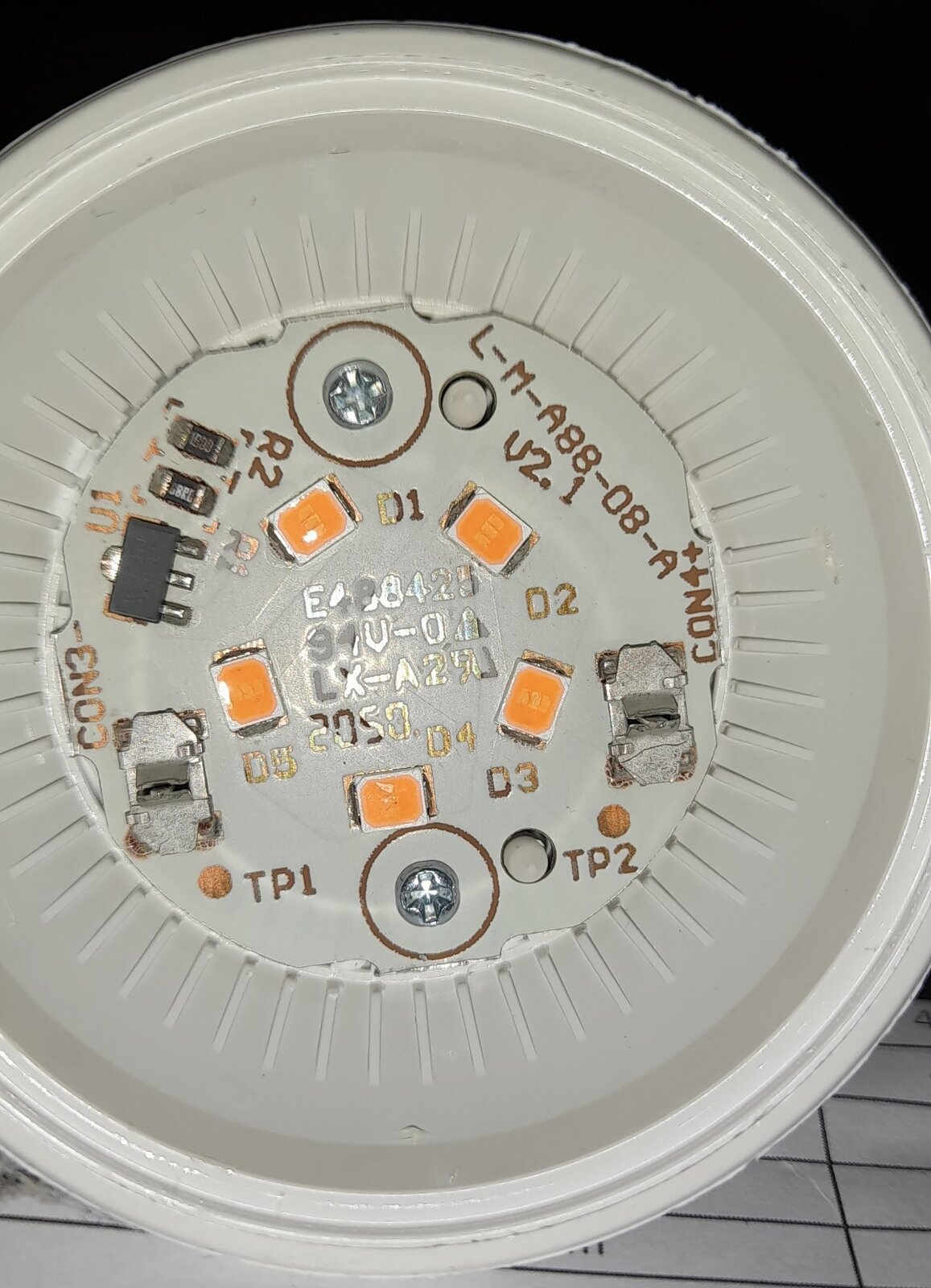

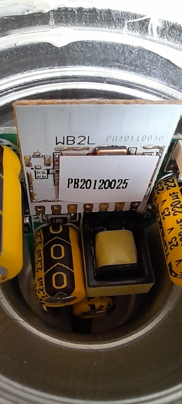

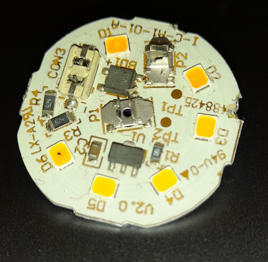

This is repeated with many bulbs bulb inner1.pngbulb inner2.png shows a smoothing capacitor under the printed circuit for the LED chips, and again GU10-inside-1.jpgGU10-inside-2.jpg this one a GU10. As to smart bulbs 20220603_113820.jpg even more capacitors crammed into the small space in a GU10 type MR16 compatible bulb. One does not get many true MR16 LED bulbs, as most LED bulbs don't have a multifaceted reflector, which is what the MR stands for.
Yes, I am showing 230 volt bulbs, not 12 volts, but my point is even with 230 volts, loading of a control device (smart switch) can cause flicker. Except for some bathrooms, there is no point today of using extra low voltage. But it seems likely the problem in your case is the voltage dropping device.

Returning to @ferkh10 we can have groups of lights from an electronic transformer, in the main distance transformer to lamp is the problem, since they work in the kHz range, the wires can transmit, so often a limit of around 3 meters total cable to an electronic transformer, a toroidal transformer works on 50 Hz, so there is no limit to cable length.
So to keep extra low voltage cables short, often we have only around 3 lamps per electronic transformer, but using DC or toroidal transformer there is no limit, my transformer I think is 200 watt, so it could do the whole room with LED, with 50 watt tungsten however just 4 lamps.
In the main, non-contact voltage testers
will not work on extra low voltage, or DC, so easy to test if 230 volt AC in a cable. But what do you have to test with? I assume inside this
there is a transformer, but as yet not seen one.
