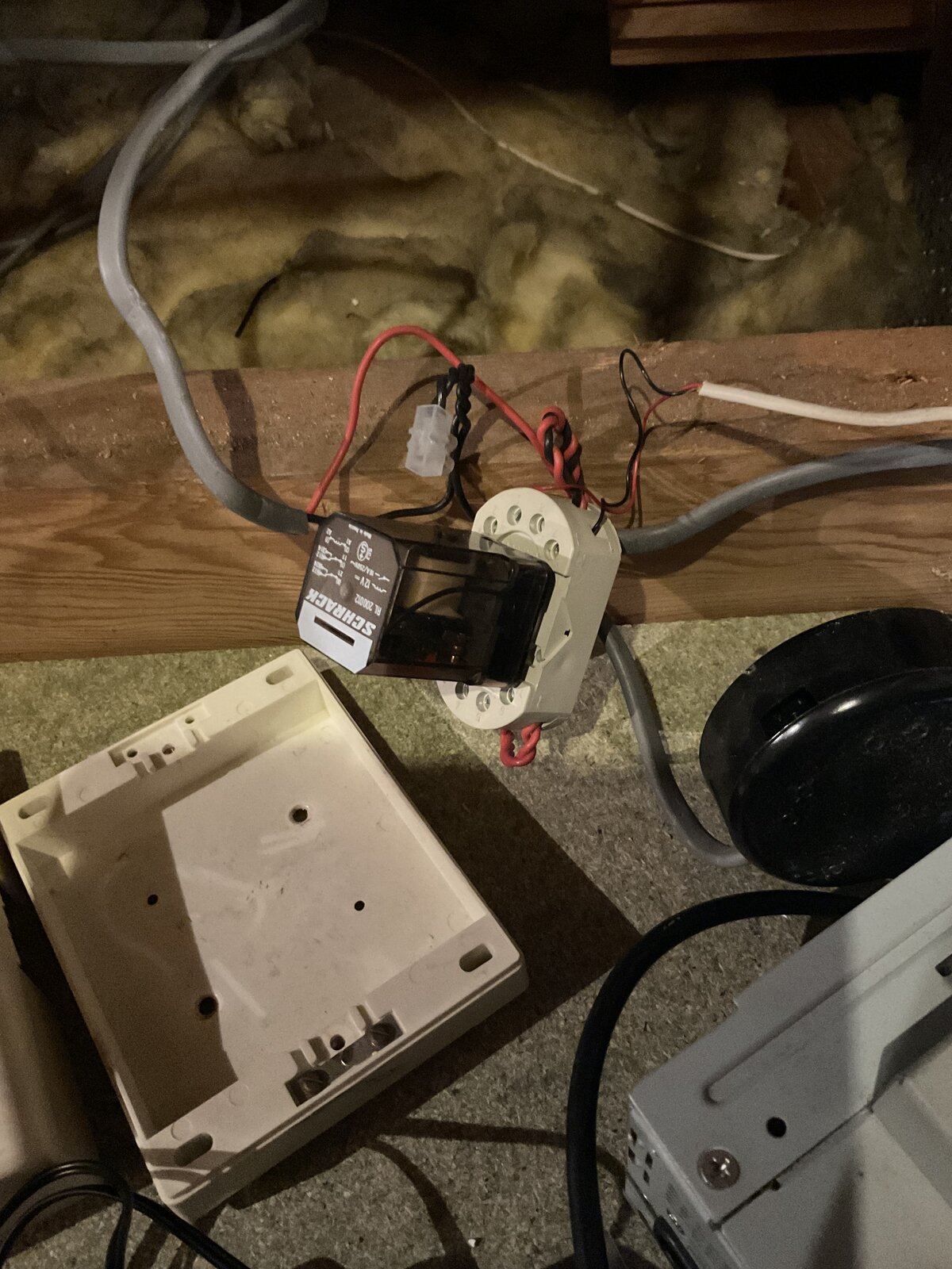

I have these 2 boxes (one black, one white) in the loft where the lighting cable goes into, then out of and services a set of 16 halogen downlights across 2 bathrooms.

Whatever those two Junction Boxes in the 1st photo are doing, they should both be fixed to a Ceiling Joist, or some other solid timber
and
NOT be just "floating in space".
Also, what is that "telephone cable" or "bell wire" doing?
It looks as though it is going into the white "Junction Box", which appears to contain 230 V wiring !!!!!
There looks to be a (discarded ?) PC Power Supply lying there -
and I hope that the 230 V cable is not going into it - via a un-bushed "slot" !

Sorry, been busy for a few days. Here’s what’s inside that white box.
It is an old PC PSU, it’s in the loft just stored with other PC bits - nothing to do with the lighting
Could well be an old wired house alarm (decommissioned) in the mix also.

There is more to this than meets the eyes.
Let's go back to the beginning, what lamps have you purchased: 12V or mains 230V?
Any chance of tracing the cables.
Post 1 picture looks like a G5.3 push in 12 volt lampholder and MR16 12 volt lamp
Yes I think that is correct but I have encountered them in mains voltage too... Yeah, total PITA when I replaced with 12V without realising the error. And so far we are not privy to any form of transformer but there is a 12V dc relay.

Cheers, I could replace the whole unit with the above. The actual units are not under boards, the boards are through the middle of the loft and the units are at the side (not under boards). Would replacing all of the units solve the flickering problem though?
Yes - but only if you remove whatever transformers/drivers/converters/power supplies are there for the old lights, and preferably remove all of the junk and obsolete wiring.
New lights require a 230V AC supply.
