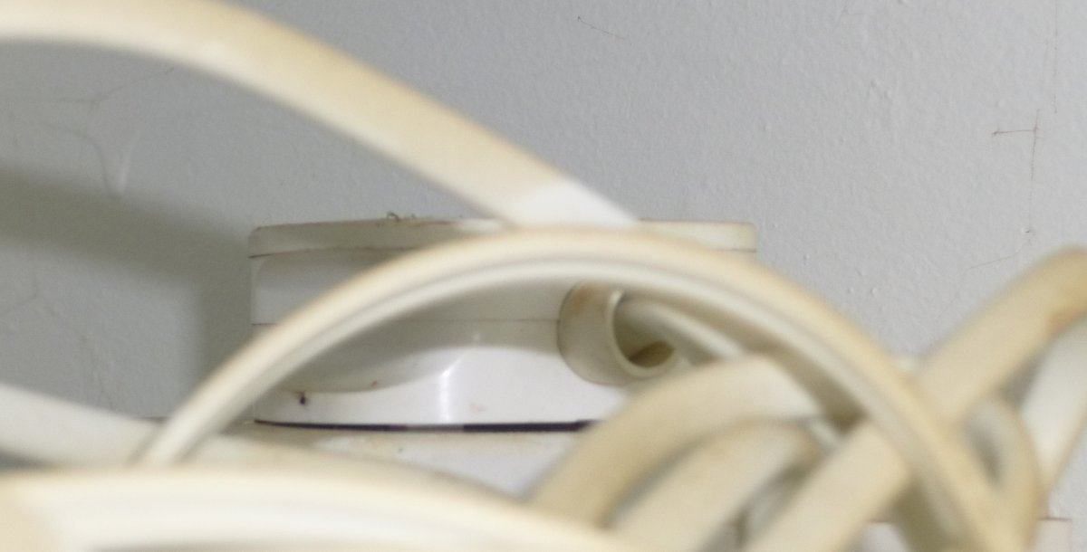

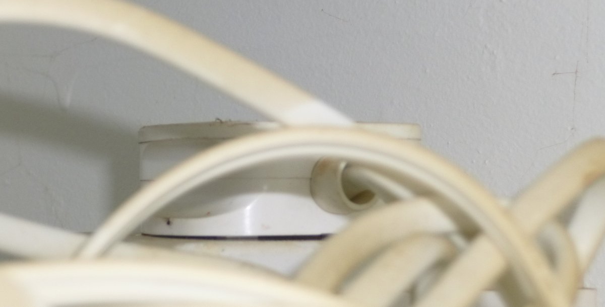

I'm going to rise to it ...13amp sockets on a lighting circuit ...these are on top of the kitchen top cupboards -extra high ones... about 2 inches from the ceiling and not visible unless you are on a ladder. They were installed as part of a whole kitchen rewire. There are multiple 13amp sockets above the kitchen counter -not on the lighting circuit and at a useful height (and sockets behind every appliance with an isolation switch at counter height) - the likelihood of someone choosing to use these sockets for anything but lighting is minimal...
I do have a double socket on a lighting circuit elsewhere - in the under stairs cupboard...put in by a previous owner - I assume it was 'mr bodge-it' who was responsible for several dodgy electrical things....unearthed metal socket being one - a light wired with a switched neutral etc. I discovered it was on the lighting circuit when I tried to use a hoover in it and it tripped the RCD.... the only thing I ever use it for is a 12v dehumidifier...
Back to my problem - I am going to try and get a picture of the set up later today (like I said I need a ladder etc) - pretty sure (from memory) the plugs aren't wallwarts - the individual ones had those . These multipack ones with transformers have standard 3 pin plugs but will double check and get back...
Actually thinking about it more I think the sockets are fixed to the top of the cupboards - rather than in the wall - so I could just take them off all together - it was done 8yrs or so ago and it was discussed with the electricians and kitchen fitters. I think the point was the most likely thing needing to be replaced would be the transformer - so make them accessible and easy to change.
I'm going to rise to it ...13amp sockets on a lighting circuit ...these are on top of the kitchen top cupboards -extra high ones... about 2 inches from the ceiling and not visible unless you are on a ladder. They were installed as part of a whole kitchen rewire. There are multiple 13amp sockets above the kitchen counter -not on the lighting circuit and at a useful height (and sockets behind every appliance with an isolation switch at counter height) - the likelihood of someone choosing to use these sockets for anything but lighting is minimal....
Indeed - and that's the very sort of situation in which I am personally comfortable with having such sockets on a lighting circuit - and particularly if they are there for a dedicated 'permanent' purpose and, even more particularly, if 'just to be sure', they are 'labelled' appropriately - just in case someone climbs a stepladder with their kettle, vacuum cleaner or welder in their hand!
Kind Regards, John

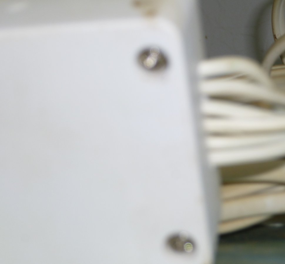

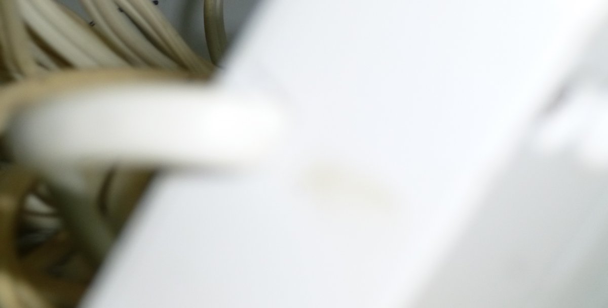

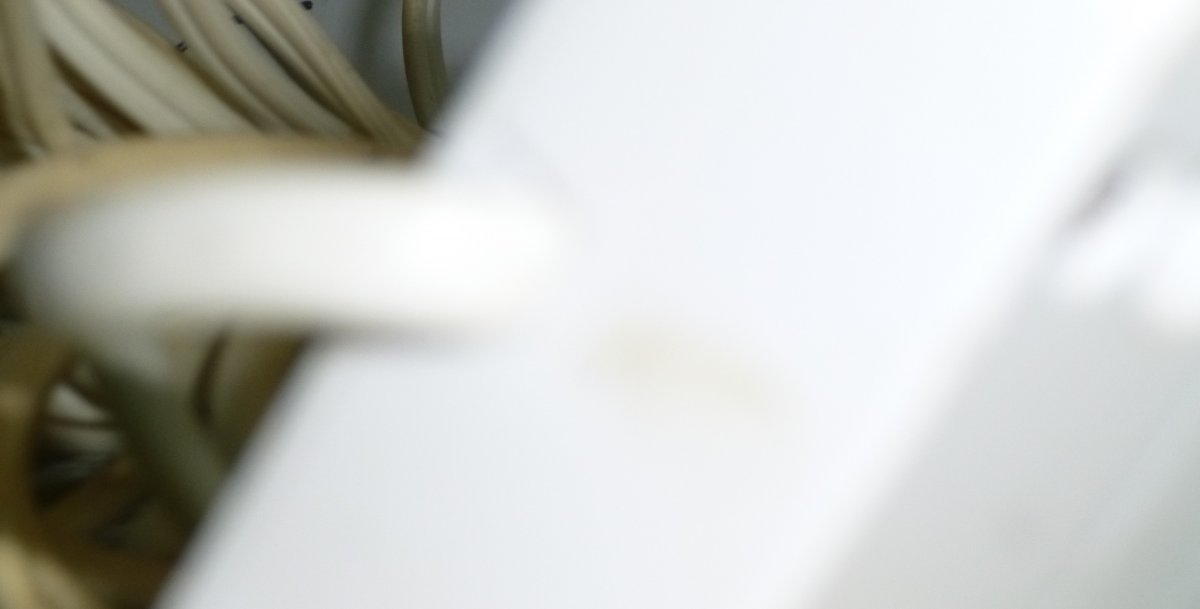

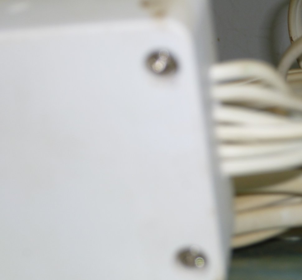

Right a couple of photos - not the best -it is tricky to get up there -had to stand on the kitchen worktop as ladder wouldn't go close enough (ad realised it is quite dirty up there :oops: ). There is more spare cable/wires than I remember. ...I knew there was enough left to put them both sets on the same transformer if I wanted to...
It is a standard (13 amp) socket and plug - socket is a surface mounted one on top of the cupboard - I could remove it and wire it straight in but inclined to leave it -it will be hard enough fiddling around up there. Better to disconnect the pucks and do as much as I can on the ground - just plug the new one driver in and reconnect the pucks... and I should be able to move it out the way for cleaning easier...(seeing as I plan on cleaning up there more often now ...honest ;))
Currently a white cable feeds into the transformer and the wires for the 3 pucks feed out...So if I can fit three of the light cables into one connector on the driver (and that is completely ok to do?) -that will be the best way to go - 2 new drivers and no fussing around with connectors etc...and will get rid of some of the excess cable now - it isn't needed and could always be replaced if nec -it was me future proofing more than anything ...
