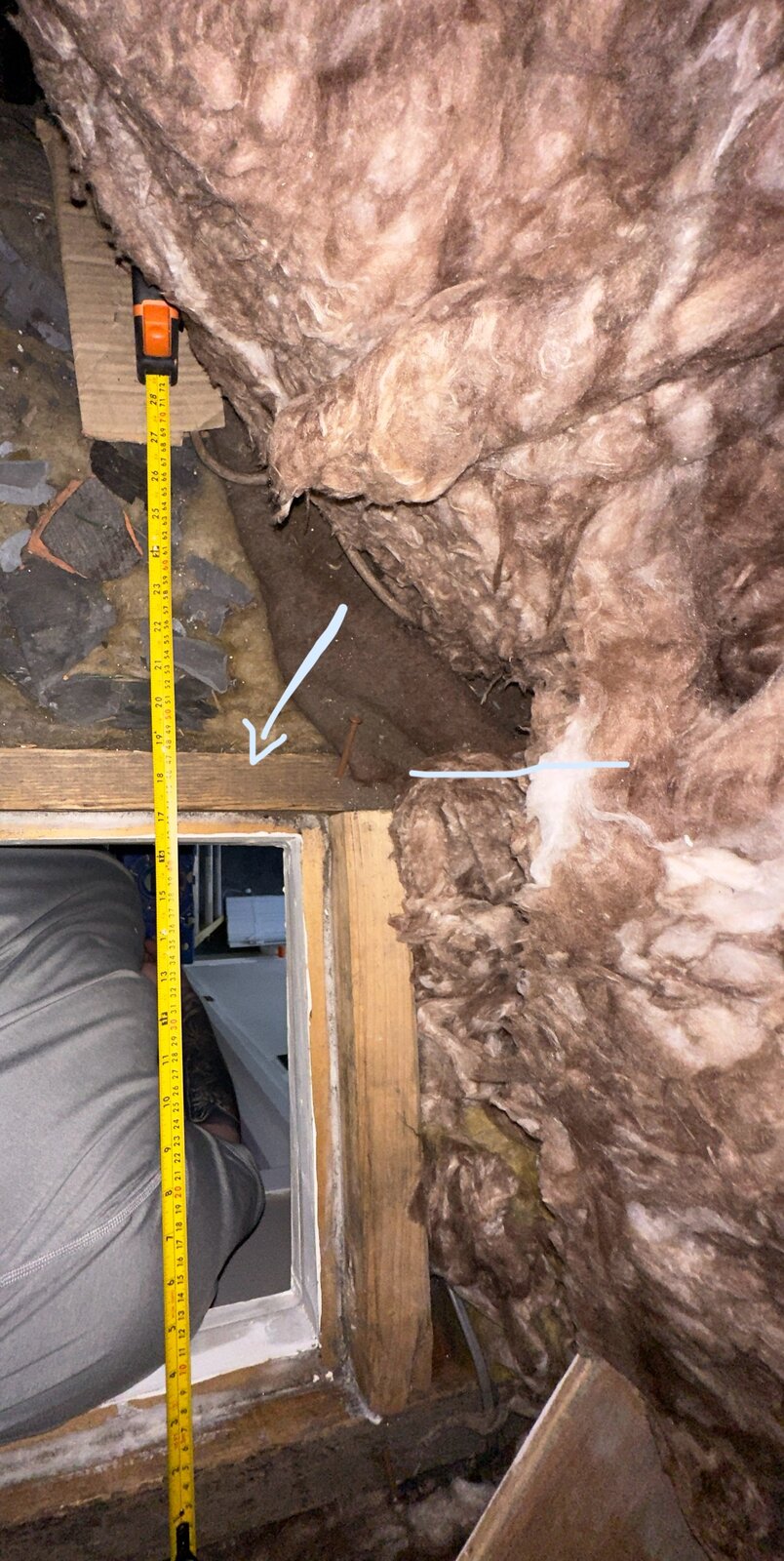

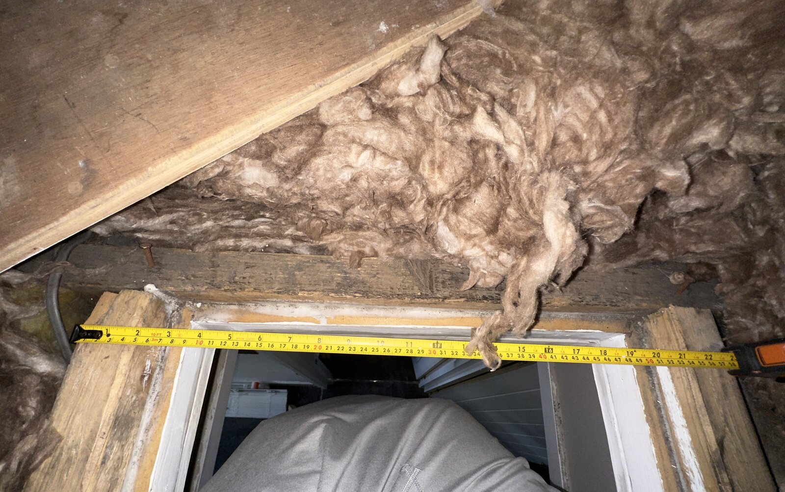

Hello!
Just bought an early 1900’s house and the tiny loft hatch has really bugged me the most, i’d like to get a GL250 hatch and timber for the fitting but noticed what looks like a wooden support beam going right across where the new hatch would be fitted. sadly there isn’t any movement to fit the hatch elsewhere based on its measurements as the landing is rather small and don’t fancy it in the bedrooms.
I’d like to know if it would jeopardise the structure or movement elsewhere if cut.
Attaching pictures for reference of the support (arrow), appreciate the support!
Thank you

Isn't the usual approach to add additional joists so you have a 'frame' in just the right place to attach the trapdoor to, then you can cut away the joist that's in the way.
I was about to do similar in my roof, but realised that the roof was a 'modern' (1990!) engineered truss design, which I understand you are not supposed to meddle with. So I've left it alone - just got an outline where I cut the plasterboard out. Oops.
