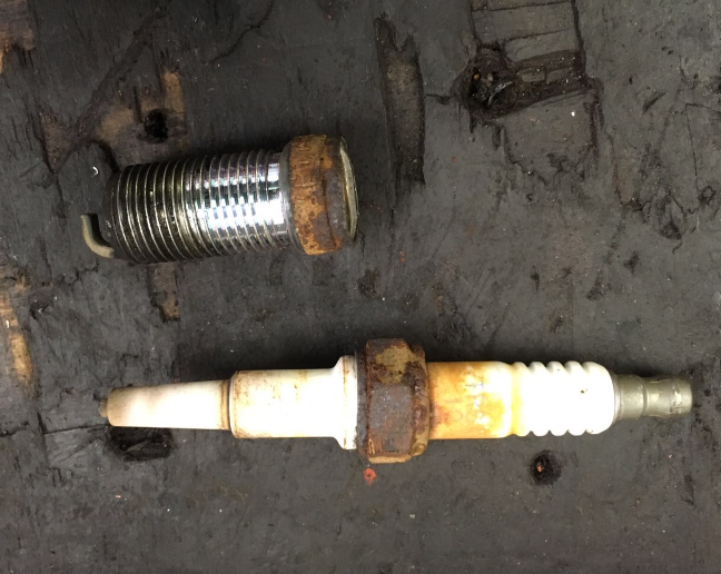

Took this one out of a Focus my son bought. Luckily, the thread came out with an easy-out.

Lady Luck was with you there mate.....I've had a couple, both came out with a splined extractor made by Sykes Pickavant. Absolute bloody nightmare :eek:

Looks like that plug has been sitting in water . Why's part of the thread shiny clean and the end bit oily? Almost looks like a plug that's too long for the head.
Being a MK2 Focus, it probably had sat in water for some time (o/s washer jet leaks into spark plug recess). Don’t know why the bottom of thread is like that - definately not too long but a lot of them are like that.
