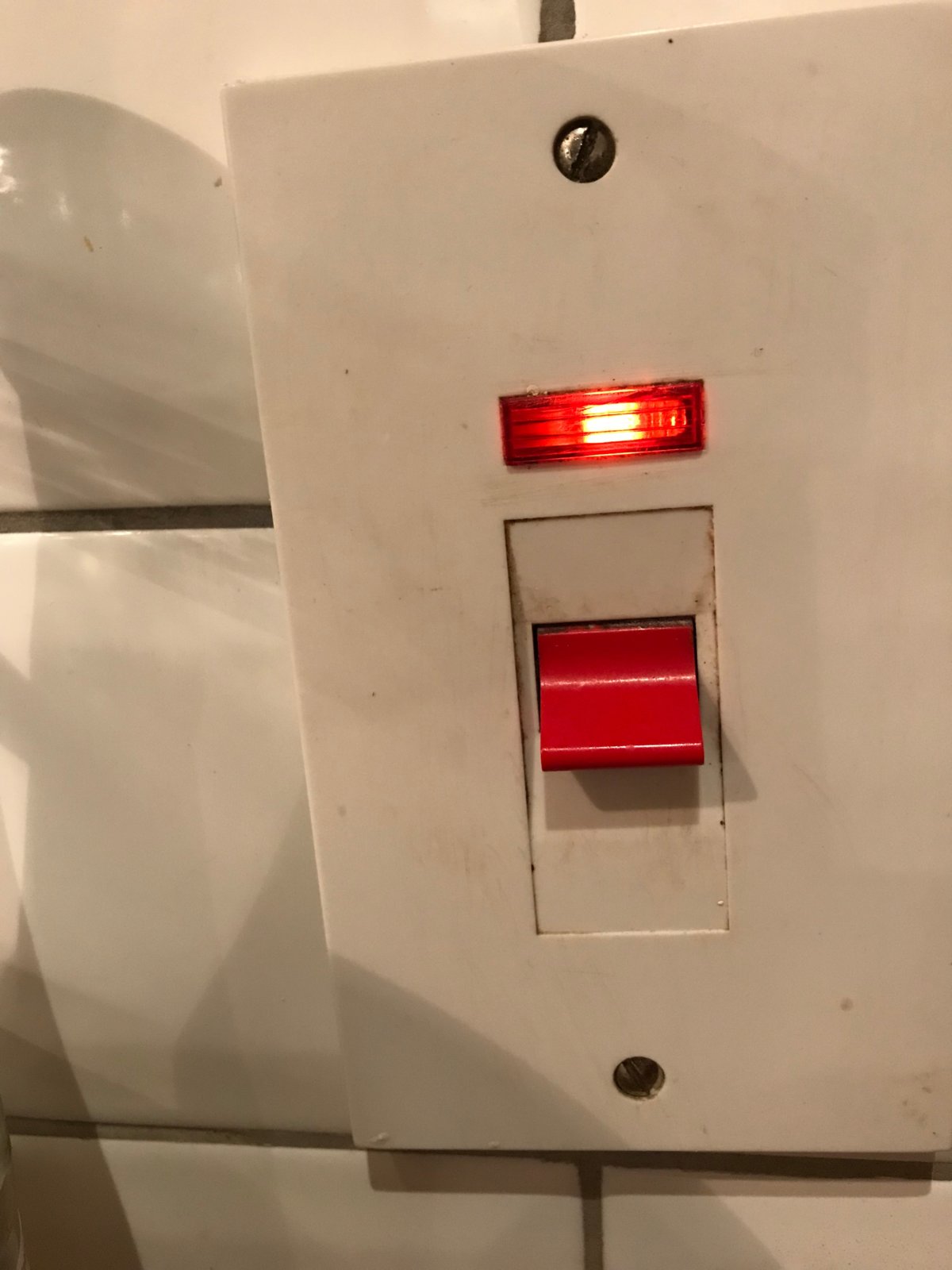

Hi all,
I'm looking to buy a new single electric oven, but I have noticed that some of them come with a 13amp plug. My problem is, my current setup and oven came with no plug and wired straight into a junction box to a separate cooker switch on the wall, and is on a different wiring system with its own fuse. Is it a big job to get this changed so that I can use a plugged oven, or is it simply a case of removing the plug and wiring it into the JB?

What is the rating of the fuse?
In general it's likely to be ok, but there's a chance the fuse in the plug is necessary to protect the cable to the oven (as the fuse may not blow within the required time of a fault at the oven). If so, you'd need to change to a socket on the wall, or an fcu, or reduce the fuse rating in the cu.

The chances are the the fuse (or whatever) protecting the circuit would be rated too high to theoretically be able to protect the cable of the oven (which comes connected to a plug with a 13A fuse, in which case the OP would be left with your "If so ..." option, which he has said would be a 'big job'.
However, if one is prepared to agree that an oven is, by its nature, not capable of creating an 'overload', then the requirement for the cable to have adequate overload protection goes away - since it is very probable (probably 'almost certain') that there would be adequate 'fault protection' for the cable.
The question of whether the oven, rather than its cable, needs 13A protection is a matter often discussed here (including recently) - and I think that the consensus is that, if it really needs such protection (which is probably doubtful), it would/should be provided internally within the oven.
Although I dare say that I might get criticised, if it were me I would simply cut off the plug and hard-wire it (as with the OP's existing oven).

Change existing junction box for a socket, and plug in the oven.... Simples!
Yes, that may be possible. However, the 'junction box' is actually a "separate cooker switch on the wall" (maybe associated with an 'output plate'), which may or may not be serving things other than the oven and which may or may not be dimensions-compatible with a socket.

There is also an electric hob connected to the switch, and its not from memory connected into the junction box. I'll need to double check when I get home, and I'll update this thread with what I find.

Ah right didn't realise the connector was an fcu separate from the main fuse box, in that case it'll be 13a so go ahead.
So this is the wall switch, I could've sworn that there was a fuse slot on the front.

This is important.
If the oven is not directly connected to the same cooker outlet plate as the hob, then you can do as TTC suggested.
If they are then replacing the outlet plate with a double one, to feed the hob directly and a new socket to plug the oven into would be the way to go.
