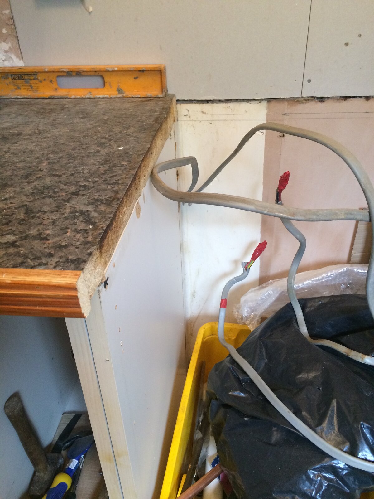

The situation is: I’ve removed the old double-oven and old ceramic hob which were both hard wired in to one switch box, each with its own 40amp cable. Each of these 40amp cables were three core (L,N,E). The switch box is inside the next base cabinet under worktop and the two 40amp cables were fed thru to the appliances from there. I detached the old hob and oven at the appliance end and left the two 40 amp cables in place (switched off and heavily taped up for now), hoping I could simply connect them up to my new appliances. Now I see that the new ceramic hob has its own heavy duty cable attached but this has four wires (not three like the old one) and the oven has a 13amp cable which would seem to render the second 40amp cable still in situ redundant. So now I’m wondering if the new four-wire hob can be connected up to the existing three-wire 40amp switch box, replacing one of the old 40amp cables which I’d been hoping to re-use. Also wondering if I now need a spur off the 40amp switch box to cater for the 13amp cable from new oven .

What is this switch box? Just a box with a switch on it? If so, remove the existing cables and just connect your two appliances.
Need a picture if it’s more complicated wiring wise than that.

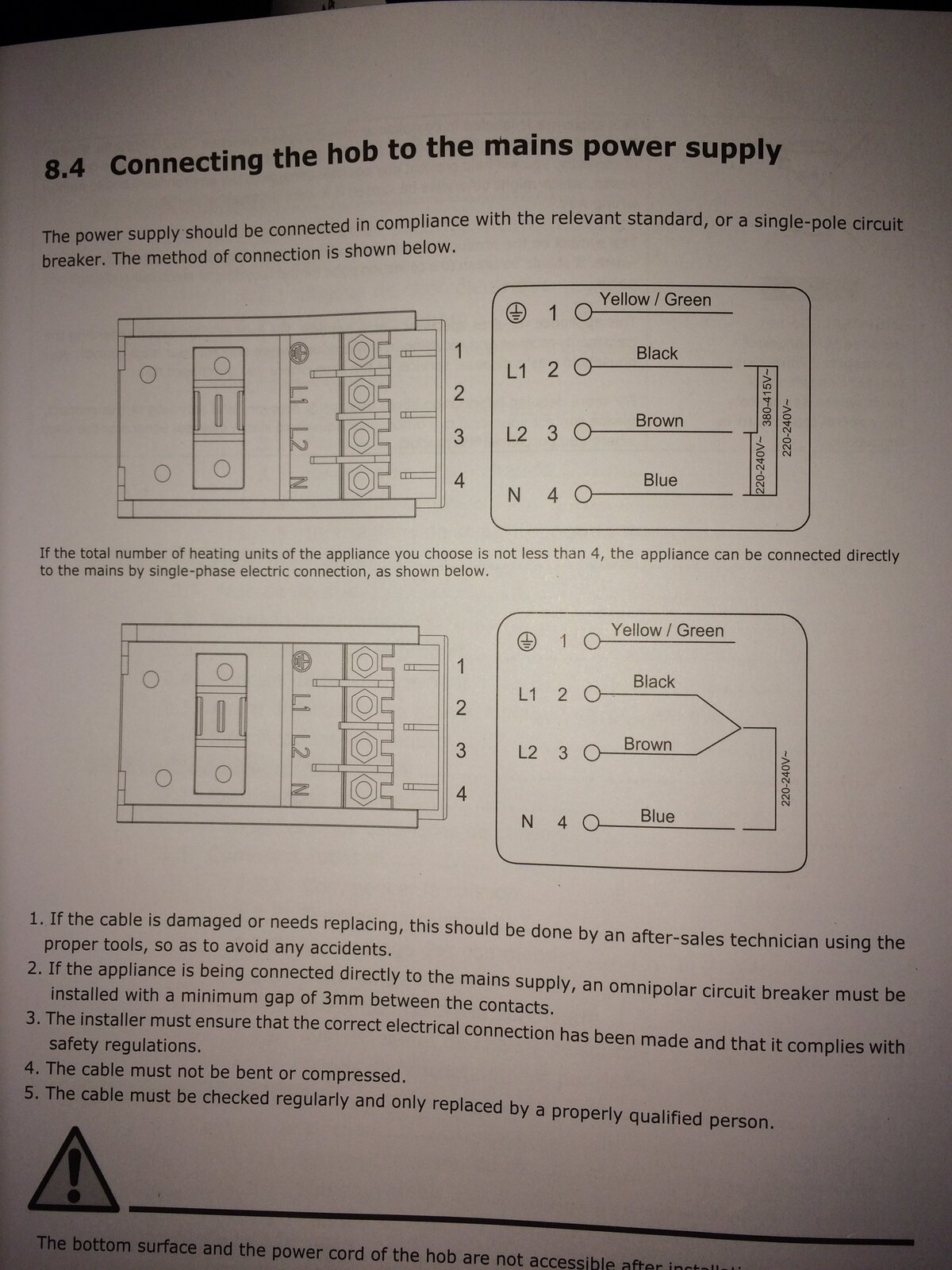

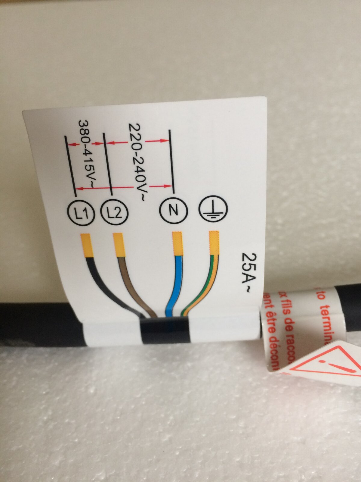

Need sight of wiring instructions for the hob. Obviously there’s an earth connection, and that leaves three. Sometimes the hobs can be connected to multi phase supplies, but Smeg instructions are usually good.

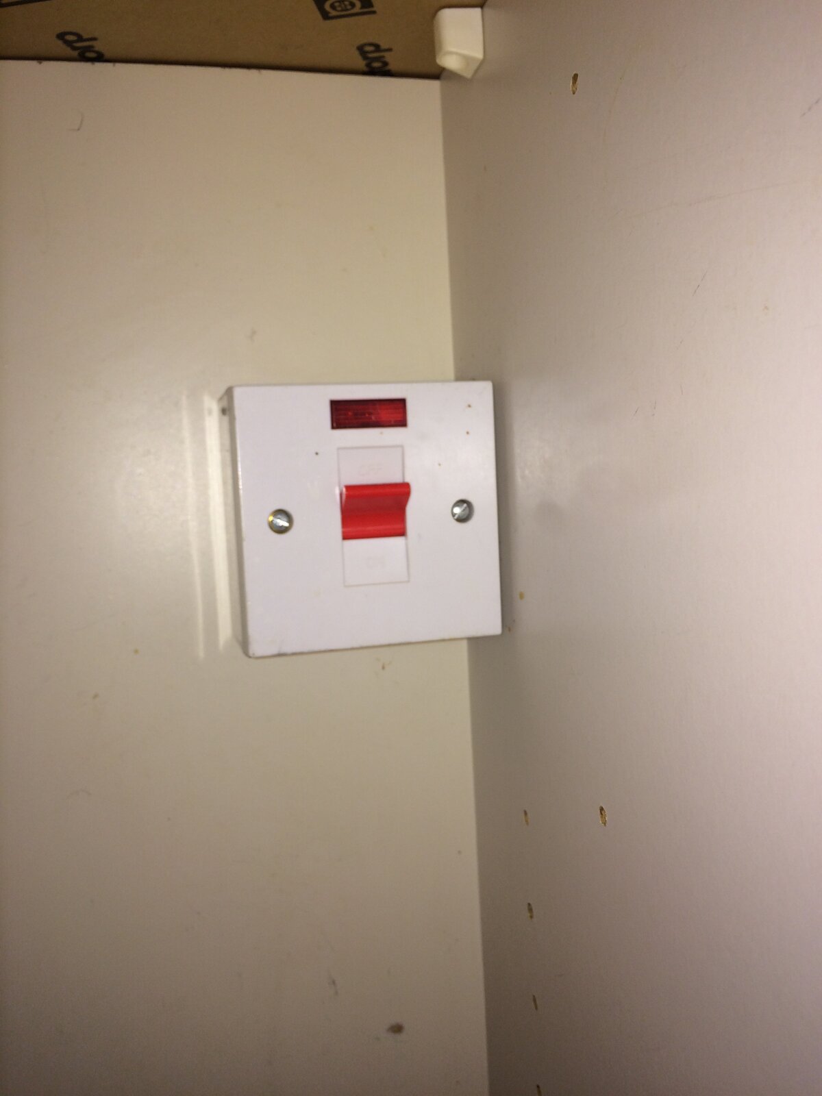

When I say “switch box” I mean like a circuit breaker switch which is located in one of the base units next along from the oven housing. I believe the mains 40amp cabling runs into it from the consumer unit and then the two old appliances were in turn connected to that via two 40amp cables, one for the old hob and one for the old double oven. As I mentioned, I disconnected the old appliances at the appliance end, so their cables are still attached to the switch which is off and the cables all taped up.
Here are some more photos to do with wiring hob (it has four burners but not induction). Hope helpful.
Ok. Just a switch then, and not a breaker. Just connect the hob and oven to the switch, power off at the consumer unit, remove the old cables.
just need to see the installation instructions for the hob.....

Looks clear to me. Black and brown together are the live, blue is neutral. Gn/yell is earth.

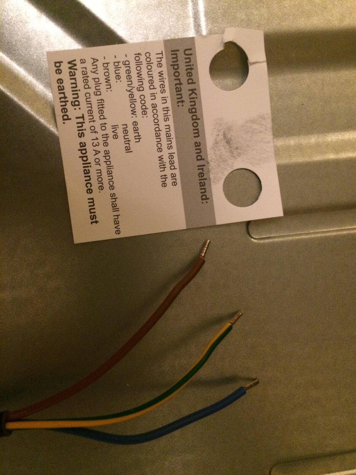

Hello, just to say, thanks for your advice. Just one last question: when you say to remove the old cables and just connect the new oven and hob to the switch.... what about the 13amp wiring that comes with the new oven going directly to the 40amp switch. Don’t I need to fuse it at 13amp somehow? Keith
Usually I find ovens rated at 13A come with a plug already fitted by the manufacturer. AFAIK this is a legal requirement put upon them in the UK. Those that don't have a plug fitted are often rated at 16A, so over the rating of a standard UK plug. The oven manual / rating plate will tell you. I've just installed two Siemens ovens that were like this.
Hi Stem, the new oven is a Smeg single oven, the old one was a Stoves double oven. I attach a photo of the wires and à notice from the new Smeg oven. Keith
