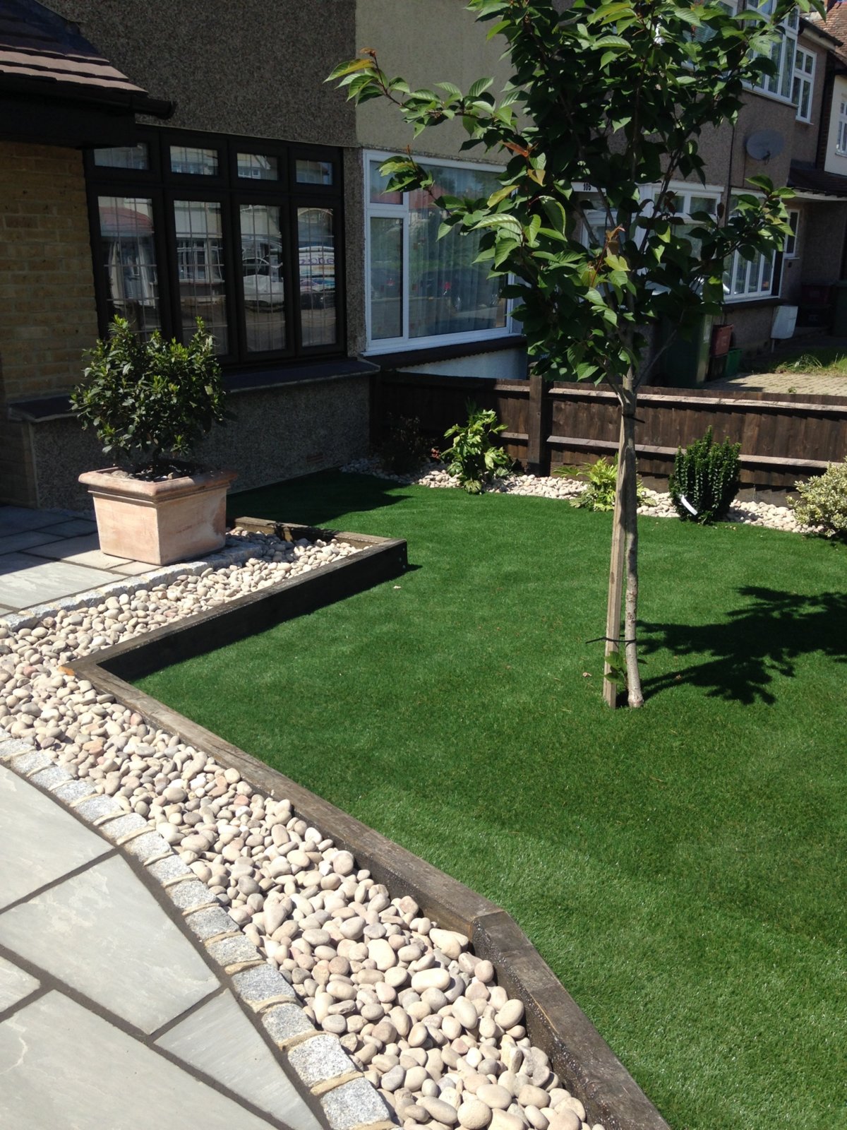

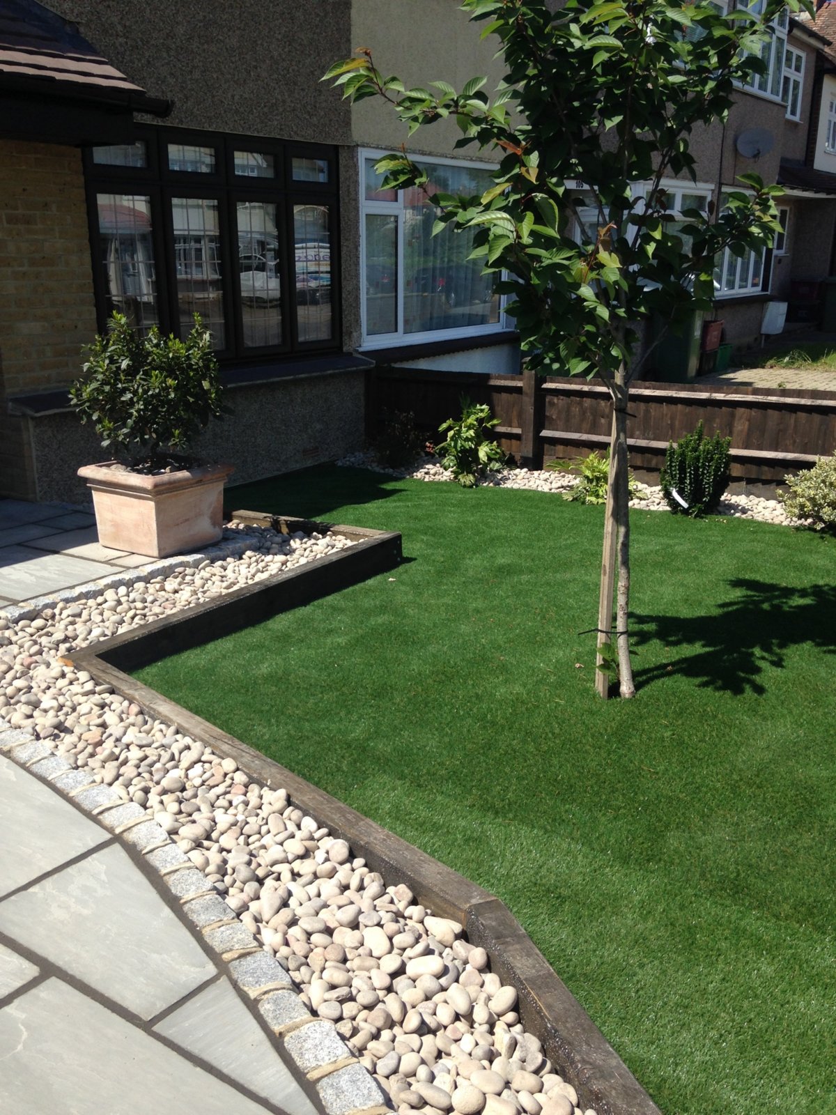

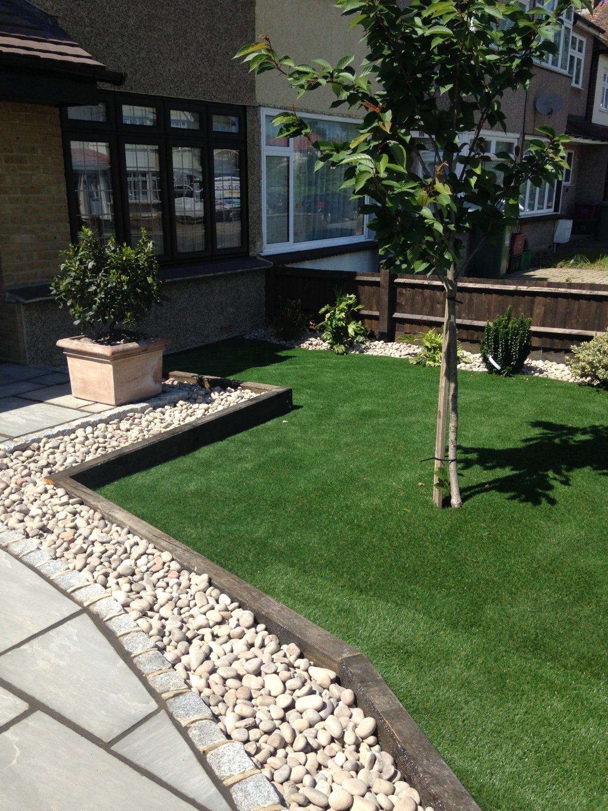

B325F843-417E-4D4D-979D-DC13DF768A63.jpeg Too manage the big height variation on my frontage I edged my path with granite sets then pebbles held in edge with small sleepers .
View attachment 145482 Too manage the big height variation on my frontage I edged my path with granite sets then pebbles held in edge with small sleepers .
That looks great.

that path has no edge, would be concerned that soil from the garden and the lawn would be washed onto it .
