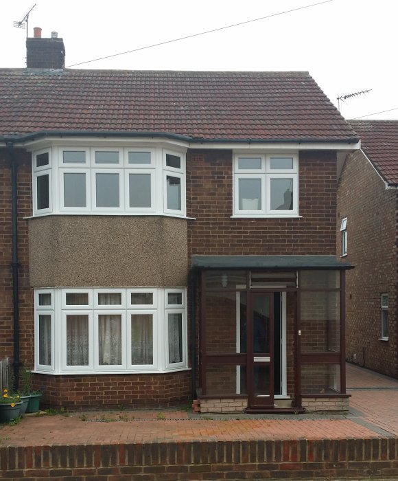

Judging by the photo, do you think a toilet could fit in there, with a new surrounding of course!
I'm about to go with a new uPVC porch using Safe Style UK. After the usual sales pitch where he phones his boss to bring the price down etc, they have quoted me £2900.
I don't know if that's a bit much especially as the foundation is already there but I'm wondering how much more would it cost to get a builder and plumber in to do the job with a toilet instead?
Are we talking double the money?
If it's not possible anyway then I'll crack on getting better quotes with the uPVC option.
Thanks very much and hope you can help.

Not an awful amount of room there with that door in the centre. Can you measure up and put a rough sketch on here so we can see if its feasible? If it is, I'd be asking for a quote to do it in brick, may not be far off that quote....

Impossible to say without dimensions.
Is there scope for moving the inner door left or right?
That's what I was wondering but don't know if that's generally possible. I guess that would add to the quote but how much?
The depth is okay but from the edge of the house to the door frame it's 88cm.
I think this might be pushing it. I'd have to have some corner unit of some kind.
Don't think there's any room to move the door either, even if it was possible.

There is nothing internally until about 70 cm in where there's a window down the side.

I was thinking of scrapping the uPVC idea at £2900 and go for a brick one instead that has a small toilet but because of where the front door is positioned it now looks unlikely.
If you are serious about the idea, and don't mind spending a bit more possibly to get it done, I'd suggest you look at moving the existing front door slightly to the one side, with a new brick 'box' built on the front, you have a porch/front door one side opposite the repositioned front door, and then the new WC could be incorporated into the other side of the new brick box. Access to the WC would then be from the hallway, through a door adjacent to the new front door opening.
Looking at the pictures, you couldn't fit a toilet in the porch area itself, but you could knock a hole in the wall, and position it half inside the house, and half inside the porch, I assume that there is a suitable drain nearby to pipe the toilet waste in to. A porch that size, shouldn't really cost about £12-1500, and for £3K, you should be able to get the builders to install the toilet, and then add porch area that'sleft.
Then you'd have to build the porch to building regulations for thermal insulation for new habitable space. If you keep the porch and house separate then it's a cludgie.
