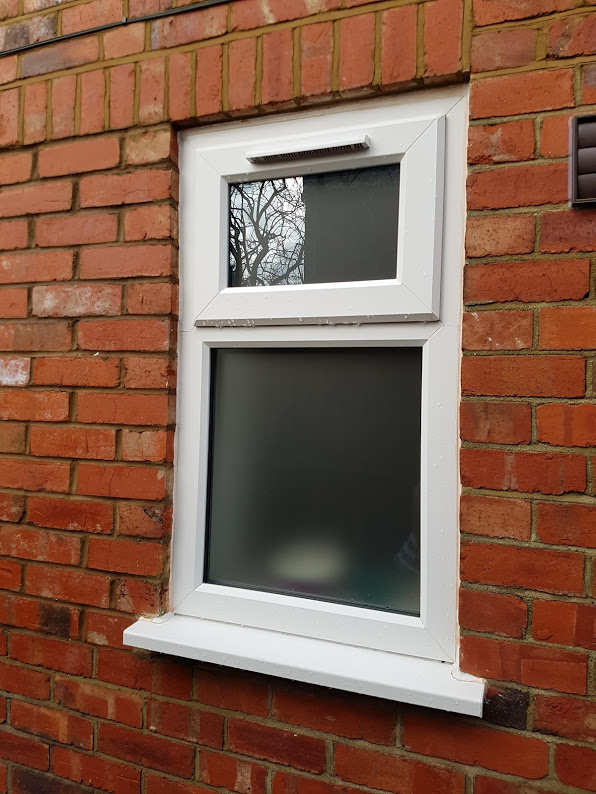

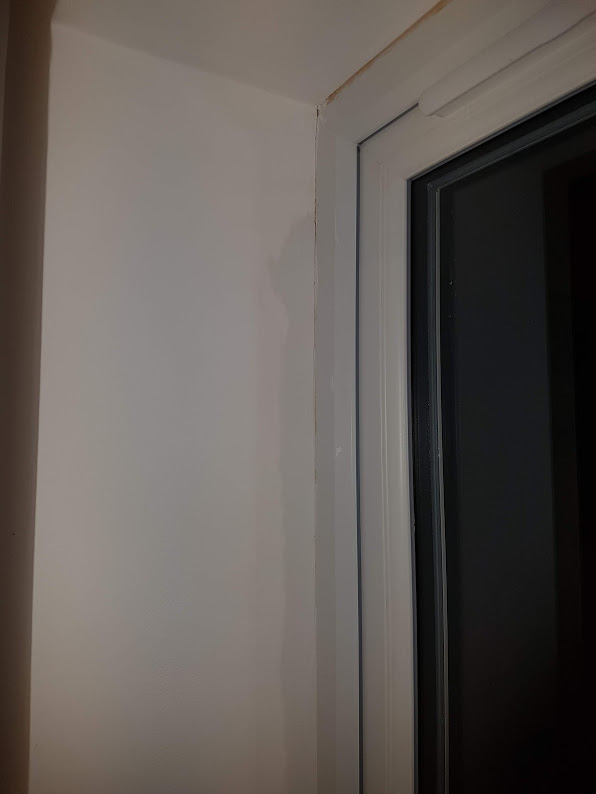

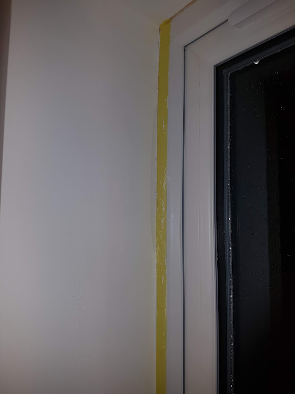

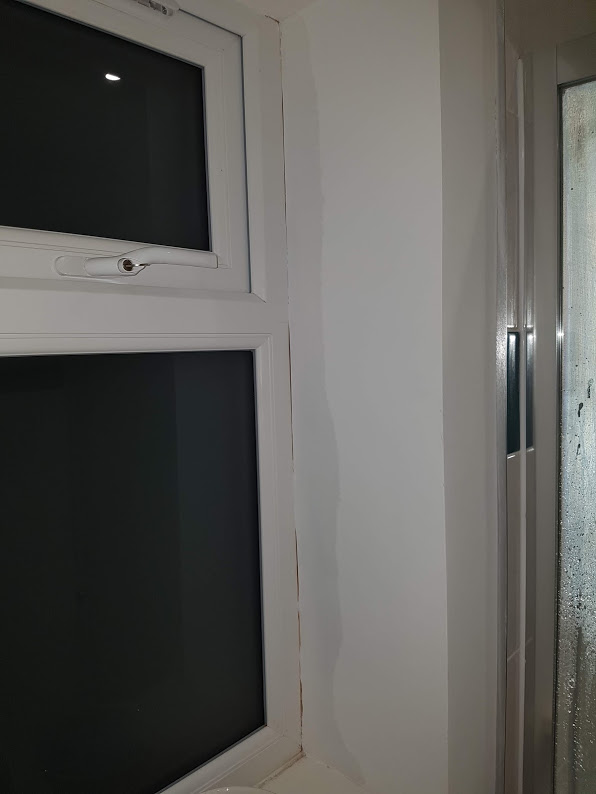

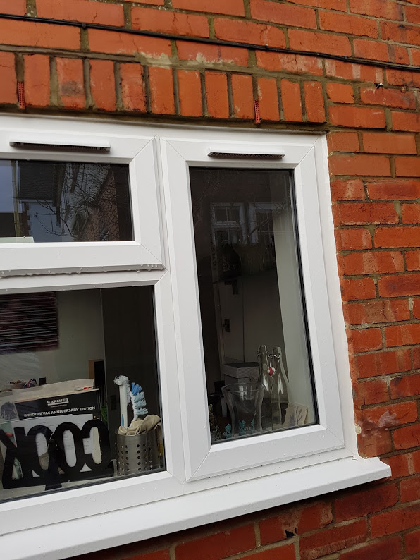

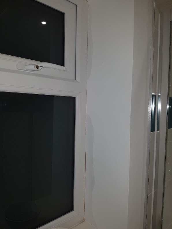

Hi. I'd really appreciate some advice on where to focus to fix the problem.
I think the photo's speak for themselves I have put some text in 2 photos to explain what work was done in altering apertures (before rennovation work, the smaller window aperture was wider and the larger narrower). Opposite of what they are now.

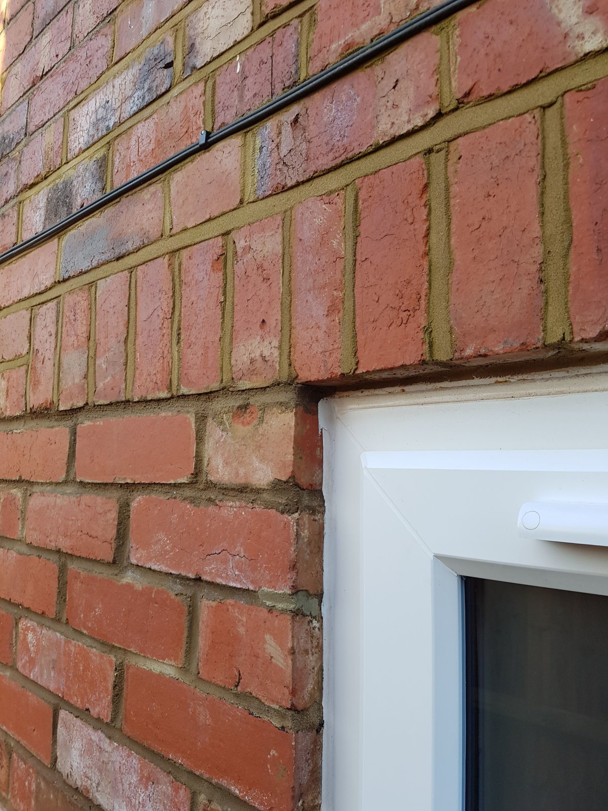

I don't want to put words in your mouth, as I have already repointed locally the brickwork down the sides of reveals affected (where is was poor or loose) and cut out and put new mastic down the kitchen window frame on the external RHS and it has made zero difference. I was surprised as there was some poor pointing towards the top of the aperture where some new engineering bricks have been inserted under the RHS lintel bearing. And the frame sealant didn't go properly into both top corners before. Alas that work has solved nothing....
The windows have been in place for 14 months and have only just shown this problem now with recent wind and driving rain ( the elevation is south facing).

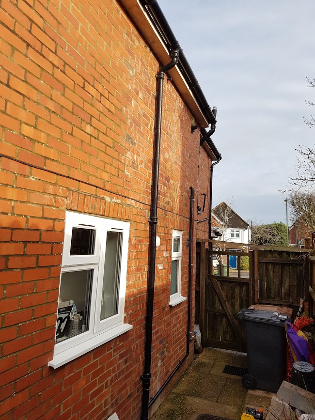

I should of made it clear for reviewers that there are only 2 windows involved. But leaky reveals on one side of both. Any takers?

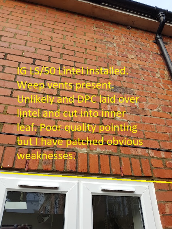

Someone, please put me out of my misery. I've already covered the water marks and stains once, repointed all looses mortar around reveals and cut out and re-applied external mastic down the side of the larger window reveal.

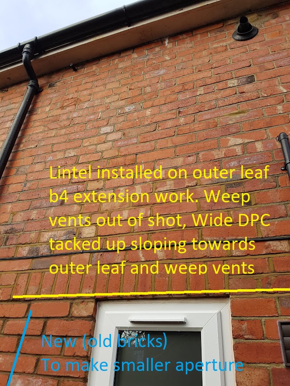

It seems to be coming from above, but the lintel and improvised cavity tray were already in place for what is the smaller BW (bathroom window) now.
Also the IG lintel above the larger aperture, has a sloping ski ramp to the outer skin and has 2 x weep vents.
Could the windows be faulty? Seems unlikely?
Poor face pointing and penetrating moisture assisted by the windows being set too far forward.
No drip from the head of the opening
Otherwise it is most likely related the the felt tray being incorrectly inserted, despite the damp being more recent.

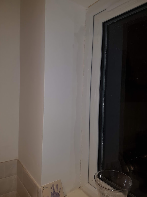

. The 2 panel window (Kitchen Window) had brick work cut out with a saw and a cavity closer installed. It was a bit messy above though as the cut out was on the line of an 1980s small two story extension and there was a massive metal track used as a wall starter spanning both leafs from memory. Had to cut that and rip out where the window was and the lintel installation area. My builder was not known for his fine detail skills.
The single panel window had the aperture reduced by inserting bricks to both the inner and outer leafs, to the side that is leaking now. Again a cavity closer was installed.
Close up bicks externally on the corner and above of the reveals that leak attached.....

The problem with having external brick showing internally AFTER the windows are fitted are the obvious transfer of moisture either by the brick or the joints wicking rain through or by the brick wicking cold, thus attracting condensation internally.
It can be mitigated with some clever use of cav closers and DPM along with some diligent dabbing techniques, so that the reveal plasterboard is not in contact with any of the outside masonry.

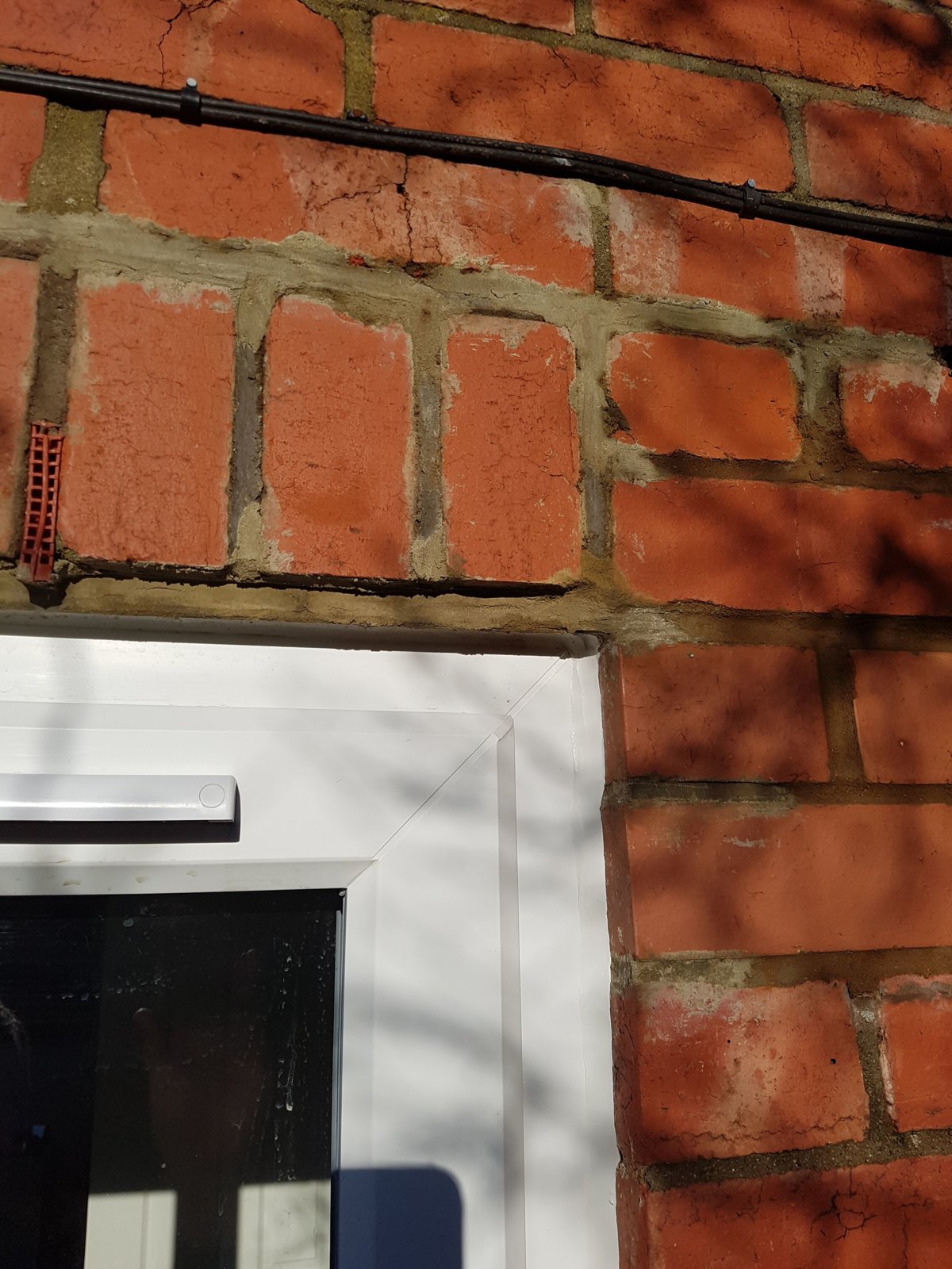

Some of that pointing does not look suitable - joints look rough and do not have a weathering face to cast off water.
Knowing the potential routes and likely culprits, it should be relatively easy to inspect the area critically, all the way up to the eaves and determine what's causing it.

The pointing on the other single window, looks pretty good though doesn't it? That one has perplexed me a bit as the aperture has been reduced and didn't leak before. So using that logic it has to be the infill area. The bricks are hard as nails so has to be mortar? It took a few days of driving rain before that one showed. One day of driving rain on the other....
Being super critical, on the single window, there is an area at the top left, where the finish has been brushed and doesn't look the same as the rest of the pointing. I could revise that area.
The brick weep vents positioning and spacing seems a bit poor unless I am mis-interpreting. On the old double window, the aperture, now reduced and a single window, there are only 2 x weep vents 1, at each extreme end of the lintel probably 1.4M apart.
On the other, double window, there are two above the double window area, probably 800mm apart and none near the top corners / lintel bearing.
Plus they all appear to be set at the height of the bottom of the brick, rather than immediately on the lintel. Wouldn't that mean 10-12mm plus of water needs to build up before they release and the water would more likely spread accross the lintel width? The weep vent itself could let water in that is trapped by a 10mm lip?
