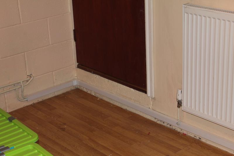

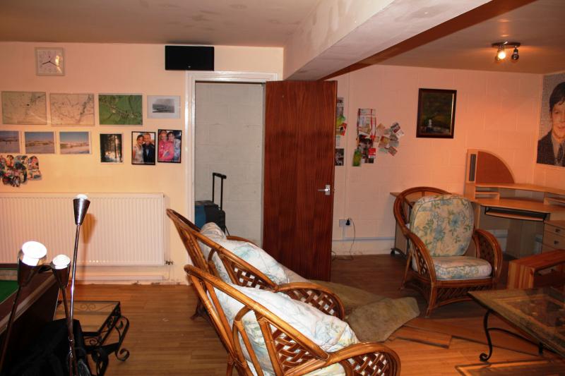

I want to install a 600 x 1600 type 22 double panel rad (2861W) to the right of the door below in the back half of my converted basement.
[/img]

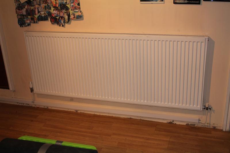

There is an existing single panel 700 x 1800 rad to the right of the open door in the pic fed with 10mm pipe
The 10mm for the existing rad is fed from 15mm some 1.5 metres away.
The run from where I could Tee into the 10mm to the position of the new rad is 6.5 metres, from the 15mm it would be 7.5 metres.
Given the size of the new rad and distance would 10mm suffice or should I run 15mm?

I would simply change the existing radiator to a double panel double convector that will give twice the heat of that single.

Its a bloody big basement though, we we only use and heat it from time to time and so need more rapid heat up. Both existing rads are near the front. Our TV flat screen, bar and seating is nearer the back and my thoughts were that an extra rad would help warm it up quicker and provide more heat at the back where we sit

BTW I went with 15mm and the new rad does the job
