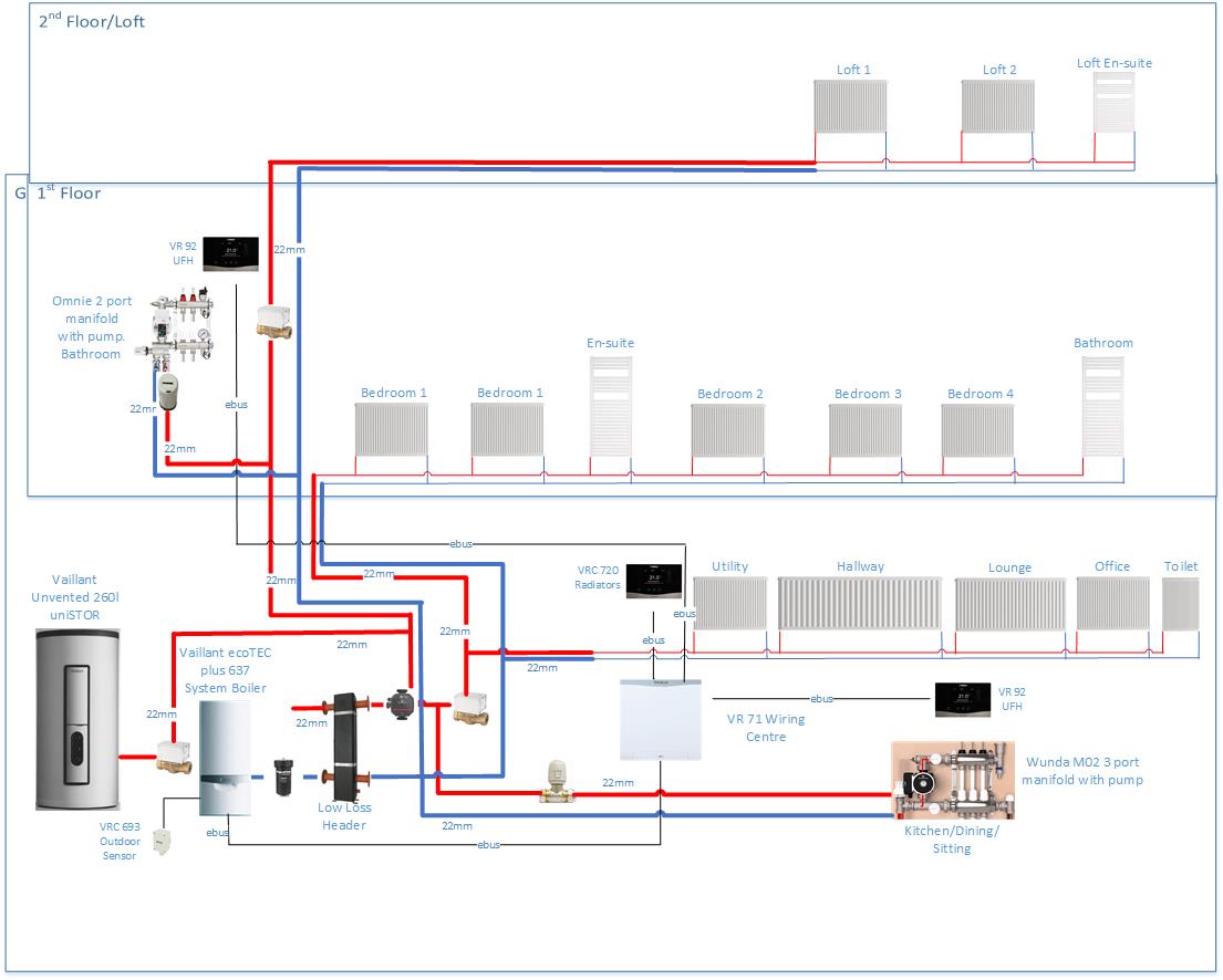

Just had a scan through some fairly recent posts of yours and see it seems that you have a LLH??, if so, what is the boiler make/model/circ pump, internal/externally installed? and what is your secondary (rads etc) pump make/model?

The boiler is a Vaillant ecoTEC plus 637 with a built in pump and it was installed 15 years ago. The pump has never been replaced and I'm not sure what model it is as I'm "not allowed" to open up the boiler case as I'm not a heating engineer!
The external pump on the circulation side of the LLH (not the boiler side) is a Grundfos UPS3. This was installed in 2020 along with the LLH as part of adding a second UFH manifold to the system. The two UFH manifolds; one for the kitchen/dining/living area, and the other for the house bathroom, both have their own pumps. The following is a diagrm of the full system, although the order in which the radiators are shown connected may not be correct, apart from the loft as I did a lot of work getting a botched install by a loft extension company to work properly.
I meant to include in my earlier post that I wouldn't have thought my issue was due to unbalanced radiators, since turning the radiators off doesn't seem to make that much difference.
The LLH makes your trouble shooting easier as you can rule out boiler HEX fouling as playing any part of the problem.

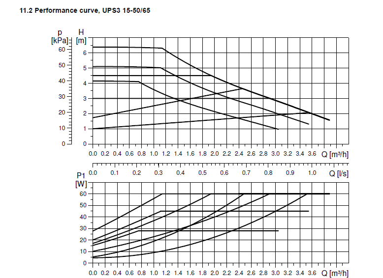

Also, the UPS3 is a giant of a 6M (6.4M) circ pump at 60W as against 40W for most of the "others". You can see, below that it will circulate over 20LPM (1.2m3/hr) and still maintain a > 6M head on CC3 and will circulate over 18.0LPM at > a 5M head on CC2, so bags of circulating head there so definitely looks like a piping problem or the "new rad" problem, anyhow install that new TRV and take it from there:giggle:
