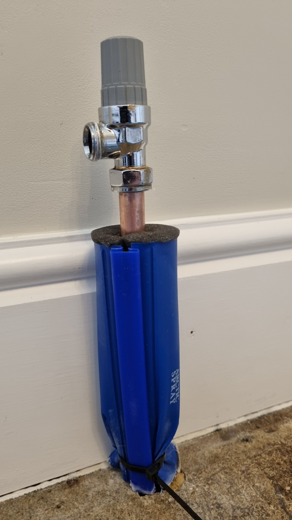

I've now used the pipe freezing kit to replace the TRV.

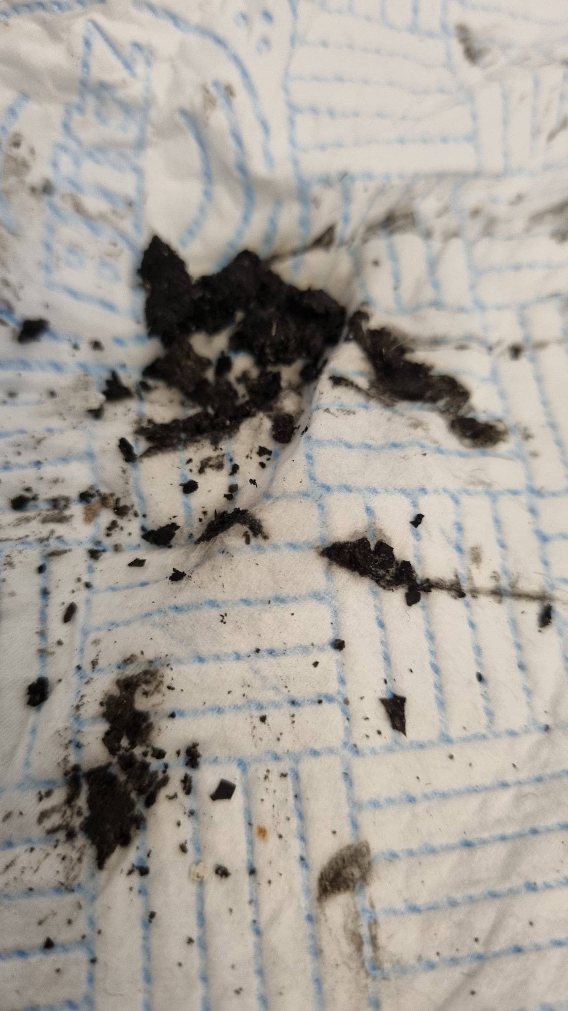

When I removed the old TRV there was a lot of iron fillings in the top of the pipe so I scooped it it with a screwdriver. This is obviously what is reducing the flow.
Having fitted the new TV I opened the valve (radiator still not on) and caught the gushes of water in a bucket. This was very black and contained more iron fillings. It spluttered to a stop and the water then only trickled out of the valve.
Opening and closing the valve managed to allow more gunk to escape, but after turning up the circulation pump there is now only a slow flow of water out of the valve. I'm guessing the iron fillings have built up again and blocked the flow.
So, although slightly better, I'm still not getting a full flow through this TRV it would seem.
Any thoughts on what I could do next?

I take it the ice plug has fully melted? Sounds like a blockage still. Maybe a flush, or use a magnet on the pipework and trace where’s it could be?
Yes, the ice plug has definitely fully melted now. I'm currently getting a slow flow of clear water from the TRV when I open it and the pipe and water gets hot.
I have another can of freeze spray, so could remove the new valve to see if there's another blockage in the pipe and if so remove it.
I'm beginning to think this leg of the CH has an issue causing the flow to be poor, however all the pipes run under the house so it would be very difficult to fix.
Given the flow is better than it was, it may just be good enough to heat up the radiator.
I have a large project planned for the Summer when I will need to drain down the CH, so potentially could try flushing these pipes with the valve off when that happens.
