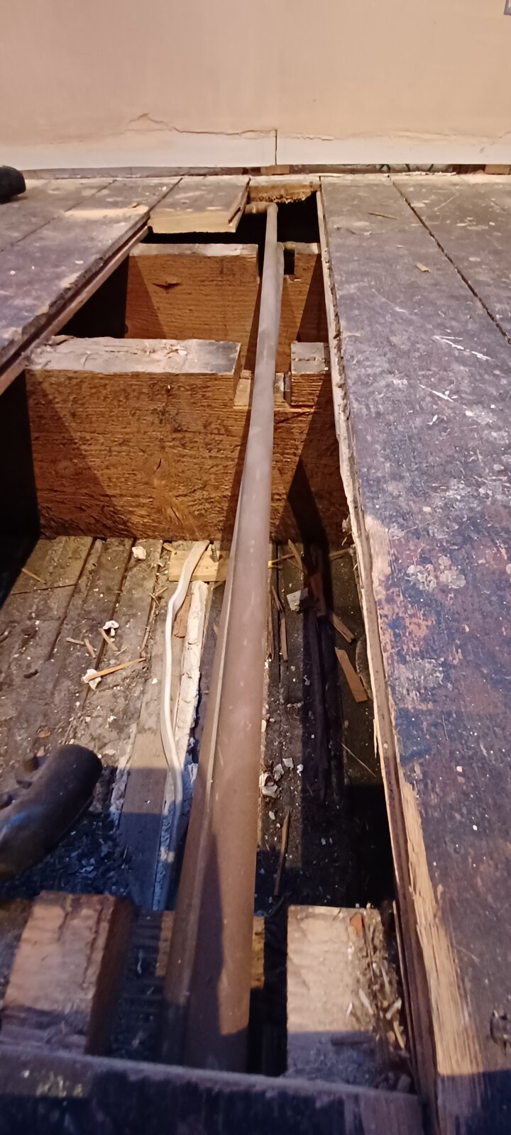

Replacing an old Radiator as part of Decorating a Room.
Valves further apart on the new Rad.
The Pipes move so I widened the Pipe Holes in the Floorboard
If I move the Right Pipe Right it pulls the Left Pipe Right???
Lifted the Floor. The Feed and Return come down the middle of the Room at 90 Deg to the Middle of the Rad and then elbow Left and Right.
However....
Feed is on the Right and elbows Left.
Return is on the Left and elbows Right.
Pipes are sat side by side in notches in the Joists.
I can move the pipes so one sits tightly on top of the other and would allow me to fit the Rad.
The Pipes sit slightly proud of the Joist.
I have a feeling this is not the way to go.
Have never Soldered CH/Water before and don't have any Kit.
Plenty of Circuit Boards and quite a bit of Silver Soldering in the distant past.
Compressions and Speed Fit a bit chunky so may not fit. Are they even suitable?
Comfortable draining, fitting Valves, etc.
Any bright ideas please?

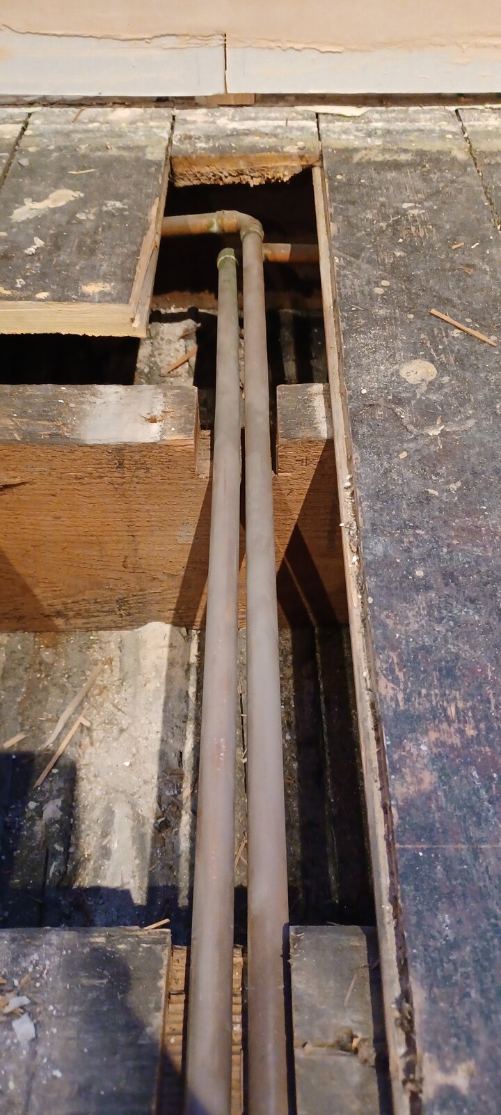

Pics
First one is how it was when I lifted the Boards.
Second is with the one Pipe moved on top of the other.
Pipes are touching (bad/noisy?) and higher than the joist (Joist or Board would need notching)

Don't cross them just a good way of creating noise
Take another board up and if necessary use 2 sockets to extend.
If you don't fancy soldering use tectite fittings (avaliable at screwfix) slimmer profile than plastic push fit.

Cheers Exedon :)
Obvious if I had thought about it properly!
I was incorrectly thinking I would need to replace the Elbows that are in the Pics.
The Pipes and Nuts to the Valves are a bit manky, so will renew those at the same time.
Are Speedfit OK to use on Copper in Central Heating?
With your solution there is more space than I thought and I think I have some JG Elbows and Couplers in the Shed.
Might be best to cut the pipes and swap them round then swap valves over to mantain direction of flow. Not a big fan of pushfit under floors but if you must do ensure the pipe is supported to stop strain on the joints.(y)
