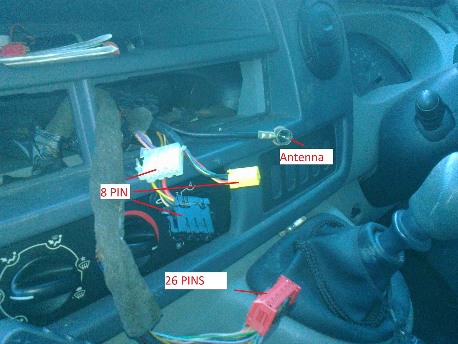

Hi,
At long last I'm changing the Renault Master 2004 car radio/cd player for a cheap FM radio.
I've just pulled out the old radio, and the are lots of sockets/pins, compared with the new radio.
Here's two photos of the radios, showing the connections, now I need to know how to connect all of the original wires into the radio, to the much fewer new radio.
Any hints welcome
Cheers, Camerart.

Hi S,
I looked through the adaptors, but I didn't see any that connected the old red and the old yellow sockets.
It looks like I'm going to have to check each wire and solder it in the correct way.
C

Hi C,
Do you know what the red and the yellow sockets connect to?
I'l go to Halford and look, but the new raio, is a cheap Aliexpress one, so I doubt it will be known as a name. Does that cause a probem?
Anyway, two replies say the same, so it looks to me that the two other sockets mentioned are for a different 'thing'?

Looking at the radio in the box; the top socket is for the speakers. I think you only have two speakers, so that appears to correspond to the white male socket in your other picture. I think you will have to get an aerial adaptor.
I don't really understand your photos, as apart from the aerial, the connections are the same, no?
If you have steering wheel controls and, a remote display that's probably what the 26 pin plug is for.

The new radio has connection info, e,g, 12V, 0V, left Speaker etc, and I should be able to get a sound from the speakers with a little battery.

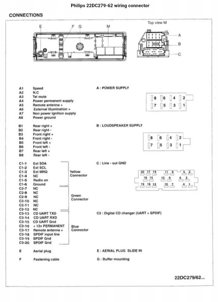

Have a search on Google for your existing radio, and compare the connections to your new one.
This may not be correct, but it was the first result that came up for the Renault Master...
As @Stivino says, you may only need an antenna adapter.

I see on the red connector are some connetions, that hopefully will be in the new 8 pin sockets.
