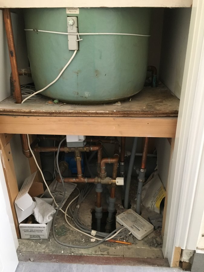

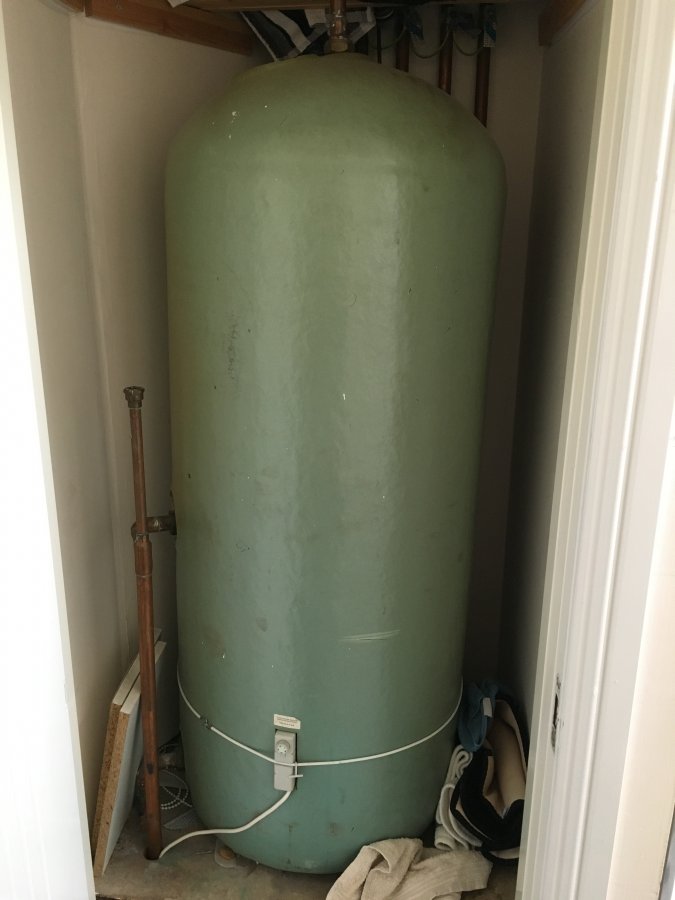

As DH6 says you have an airlock in the cylinder indirect coil, post a pic of the HW Cylinder and we will tell you how to remove it
Above and below the cylinder. Thanks for any help.
And you dont have a gravity system, you have an open vented Y plan, they are very different systems
Oops my bad. I thought that was a gravity fed system. Thanks for letting me know.
I have bled the valve you guys referred to and hasn't made a difference. I should add that the water is like warm, slightly warmer than cold, as if some heat is getting to the tank. Not sure if that changes things.
Any other ideas?
