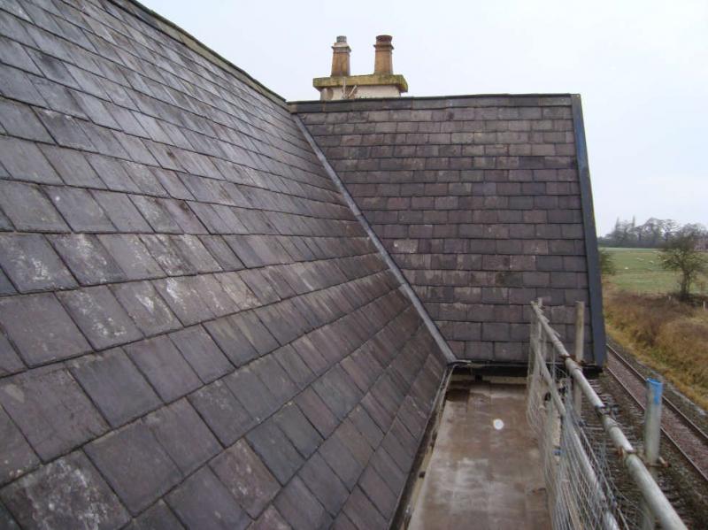

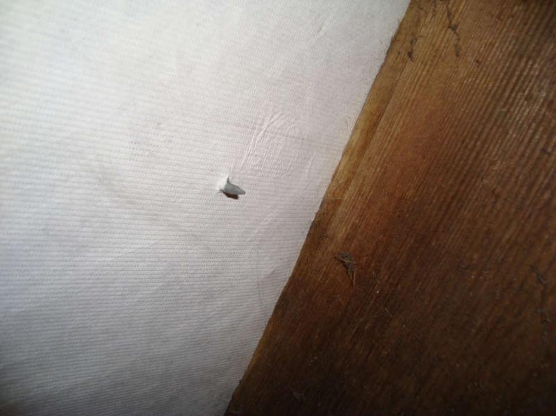

Here is a pic of part of the roof and one of the many nails poking through the membrane. Click the thumbnail for a larger view.
Have written to the contractor rejecting the work and we'll have a site visit on Tuesday. Company has a good reputation so I'm hopeful they'll do a proper job of fixing it.
I would have expected to see more nails showing through.. I might guess that the odd few longer nails were mixed in and not rejected during slating. Maybe there was an improver onsite ?
batten we would use 25x50.. but at least you have the thickness..
the roof looks fine and shame to rip it off..
Yes, happy enough with the way the roof looks from outside. Found one slate on the valley which has been cracked by some rough cutting but other than that it seems well set.
About 30 nails are showing through and by feeling the laths through the membrane I'd say about a third of the nails are too long. A lot have stretched the membrane without puncturing it but as the wind whips it about they are working their way through too.
Shame to rip these slates off, they were only nailed on twice - once 170 years ago and again last week. Ripping and nailing them again will just trash some and leave the rest a bit more damaged.
Good point about the improver, there was one experienced roofer and his 'lad'. That might explain it.

When the slates were removed I could see why some nails had punctured the membrane, some had gone through a slate and instead of pulling them out they'd just been hammered flat into the lath. All the others were protruding through the laths to some degree, all the nails were 35mm long which seems to be too much for the 25mm laths + the slate thickness. From what I've read it should be 15mm + 2x the thickness of the slate.
