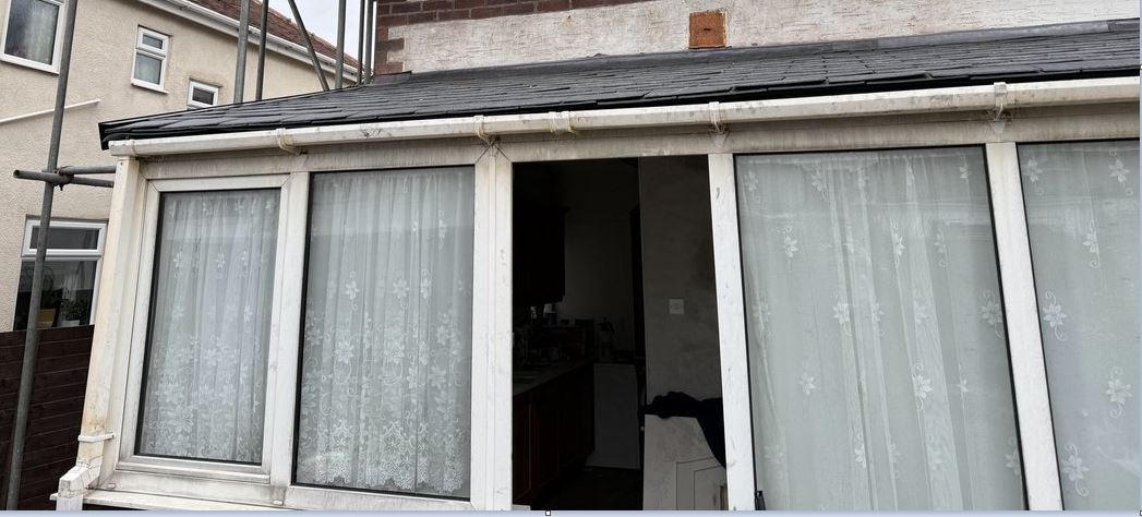

We have had a new roof on our lean to. They have left it without insulation for us to install but I need to know when fitting the insulation inbetween the rafters do we fit it flush with the underside of the marine ply or leave a gap and fir it closer to the T&G we're finishing the ceiling with?

As it stands, you are probably going to make it a 'cold roof'
This will require a 50mm gap between insulation and underside of roof deck, plus ventilation at opposing ends in line with the joists. And a vapour barrier.
(This is all assuming that the room is airtight and heated. If it's not, then not much point insulating)
Only the tiles and plywood are on the roof, it's all done but it is by no means finished.
The new roof is over a lean to. I have attached a photo.
There's 14" between rafters and they are 7cm deep so allowing for a 5cm gap would only allow 2cm for insulation. I am then finishing the roof with either T&G or plasterboard

Os the lean to open to the rest of the house, I can see a light switch?
From your initial post I assumed flat roof, I'm not sure why the marine ply is under the tiles. Are there any membranes in this roof construction?
The tiles on the lean to are some kind of plastic which is resembling slate there is then a fabric layer whether that’s waterproof layer or not I don’t know and then the marine ply. It is a slanted roof and it’s attached to the house with patio doors to the left and the kitchen is off to the right so it needs insulating as it will be very cold. Winter as it is at the moment.

What you have got won't comply with building regulations, and with such shallow roof supports any insulation would be a token effort at best, and do approximately nothing to reduce heat loss.
What you have got won't comply with building regulations, and with such shallow roof supports any insulation would be a token effort at best, and do approximately nothing to reduce heat loss.% reduction
Not quite right, with no insulation U value would be in the region of 2.5 with 50mm celotex this would reduce to around 0.5 so about a 80% reduction in heat loss through the roof although the calculation is based on basic heat loss formulae and how it compares to floor/heat walls heat loss is something else to be considered
Why not . ? Badly designed lean to?
When they bought it (Jan) they had a see through plastic roof with 0 insulation. Now they have a plastic slate effect roof but it's been done appallingly. It will take some insulation but making the ceiling flat isn't an option as it would come below the opening for the kitchen and also be lower than the arch, which is the old back of the house.,
They intend on trying to insulate but the depth of the rafters are only 7cm and I believe we have to leave a gap between the underside of the ply to allow air flow.
In all honesty he's done a terrible job. Photos incoming...........

And finally, the outside photos of the guttering, that is how they've left it. It was worse than that so we've had them back to rectify and this is how they left it..Water is going to sit over the door as it doesn't slope enough to drain. On the right where the feature plywood is the guttering is under the tiles so any rain will go straight over the top of the guttering. This is why ply has been used. Apparently one side of the lean to is 15 INCHES higher than the other, I will be measuring.
I think I need deeper guttering so it will catch the water all the way along, not just where it will fall into it. The left side will collect water, the right definately won't

25mm Celotex between rafter and 50mm over top before plasterboard .
Personality would have knocked it down and rebuilt , always going to be chilly in there .
