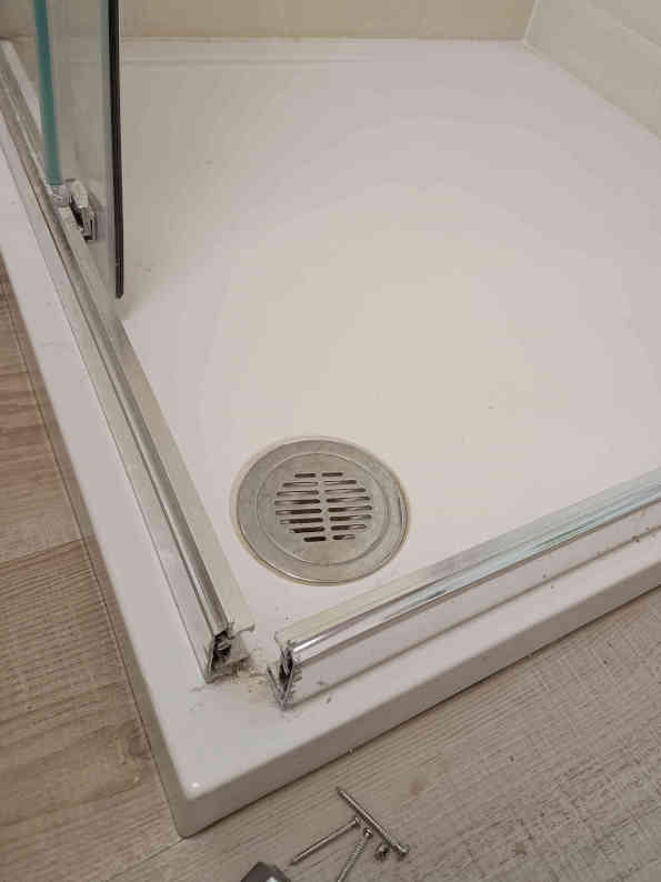

New shower enclosure corroded already. Incompatible metals used, steel screws and aluminium.
15 Apr 2007
43
Hampshire

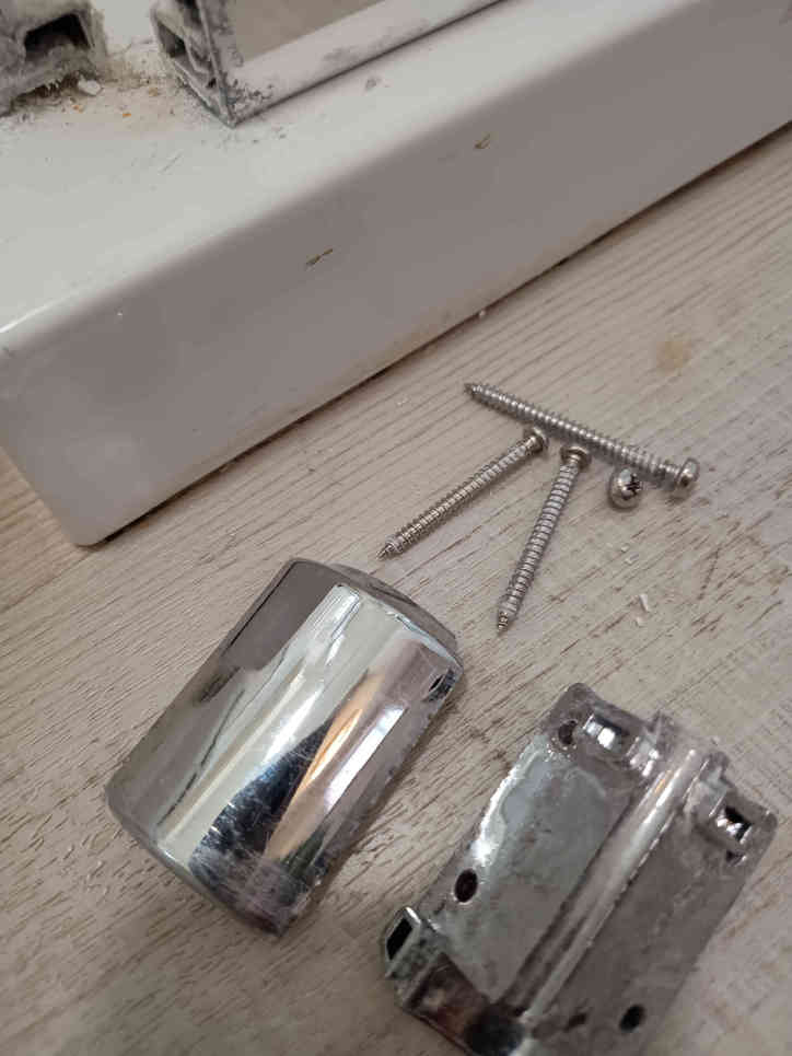

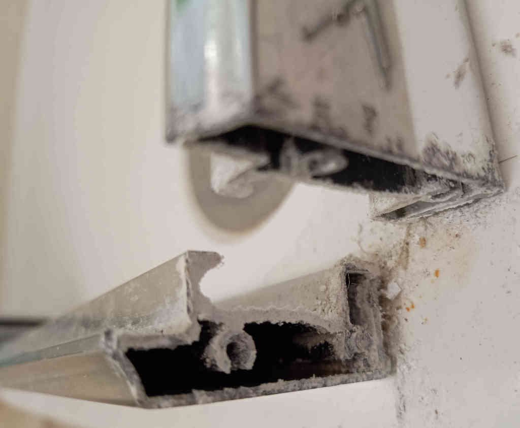

We had this "Lakes" brand shower enclosure fitted 3 years ago and already corroding as shown. Even worse, one of the fixing screws is corroded in place and sheered off.
I need to replace the steel self tappers with aluminium ones but can't get anything smaller than 4mm, I need 3.5mm.
Then I need to remove corrosion as best I can and corrosion proof the area.
Does anyone have suggestions or experience?
But why does a firm like Lakes supply two different metals that are obviously going to corrode when they get damp. Are all shower enclosures made like this? shower corner.jpgshower location.jpgshower parts.jpg
1. So far as I know you can't get aluminium self tappers. The metal is too soft to cut a thread.
2. If you mean 3.5 mm aluminium machine screws, search for Aluminium M3.5. Doubt they'd be strong enough.
3. Short of Titanium, which is very expensive, most metals will react with aluminium.
Will also depend on your water type, harder water tends to be slightly ionised and can then act as an electrolyte. The harder the water the worse it can be.
